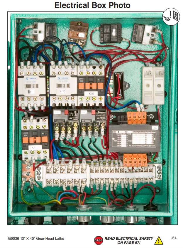

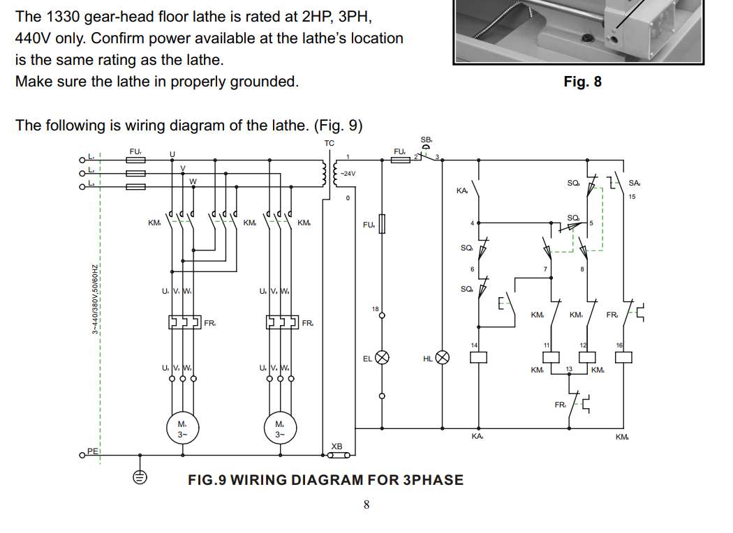

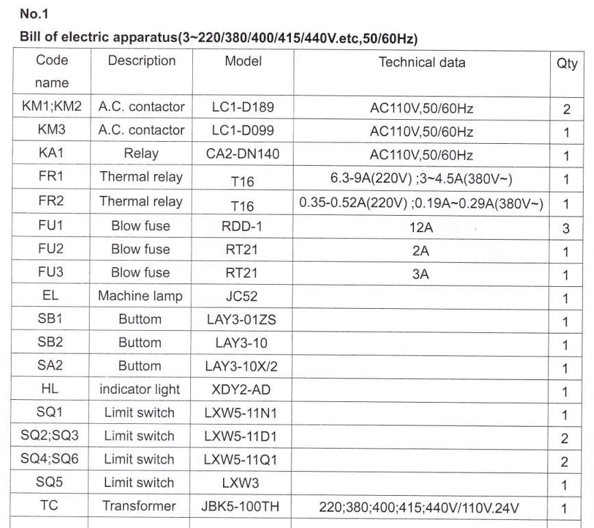

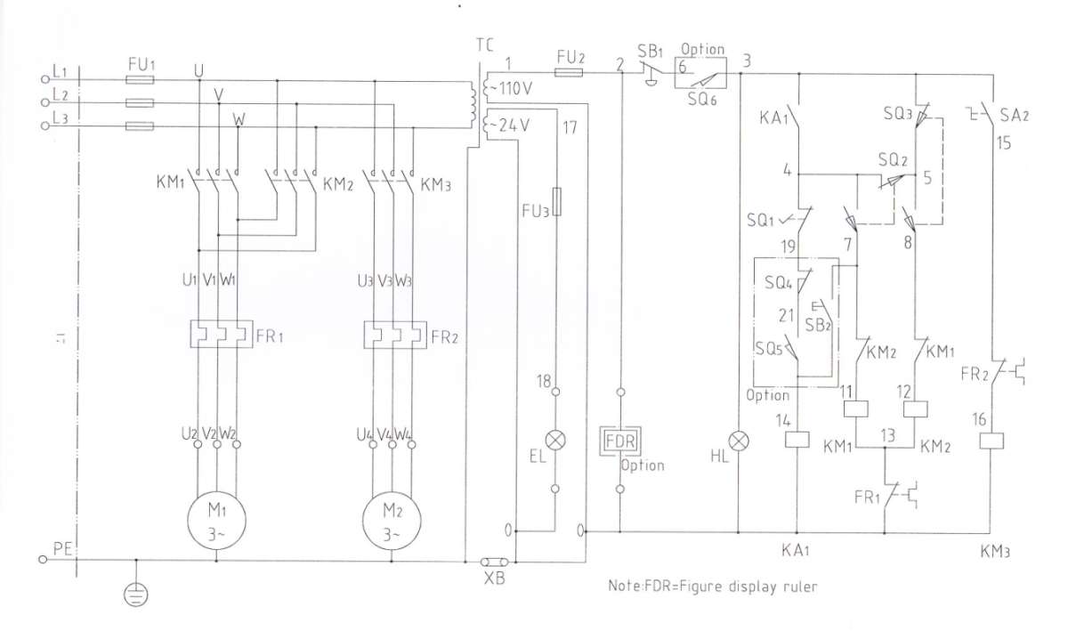

                      This is from the Warco manual, which I believe they will supply by email; not sure of the current spec of the supplied motor.
                      image_2025-11-11_114014646
                      Note all the extra safety contacts/switches.
                      Off the top of my head, start/stop/reverse, chuck guard, footbrake/emergency stop and possibly others; there is also a work light and coolant pump.
                      My own GH1330 is single phase, so slightly different.
                      N.B. I suspect you will need quite a bit of re-wiring to use a VFD, as the switching will likely need to operate as low voltage control circuitry. switching on the output/power side of the VFD is likely not a good move.
                      Perhaps investigate a static or rotary converter.
                      I don’t have the component list from the GH1330 manual, but this is from an older GH1322, which looks similar;
                      image_2025-11-11_115243295
                      image_2025-11-11_115502328
                      This photo is from the American Grizzly version of the lathe, slightly larger, and obviously different voltages, but it will give you an idea of the control panel internals; mine is up against a wall, so difficult to photograph.
                      https://cdn3.grizzly.com/manuals/g9036_m.pdf Slight differences to the UK/Warco model, but a far more comprehensive manual
                      I did place the lathe partly in front of a window, so I can access the panel from outside the garage.

                        How do you find your single phase GH1330? As there is a single phase GH1330 for sale and I have been doubting which one to buy. In the end I settled for the 3 phase as it is newer and appears to be in better condition.
                        I have send a copy of the electrical system to the company and I am waiting to hear back.
                        Regarding vfd’s. I am not looking at the cheapest but it also doesn’t have to be gold standard. The lathe will not be in daily use.
