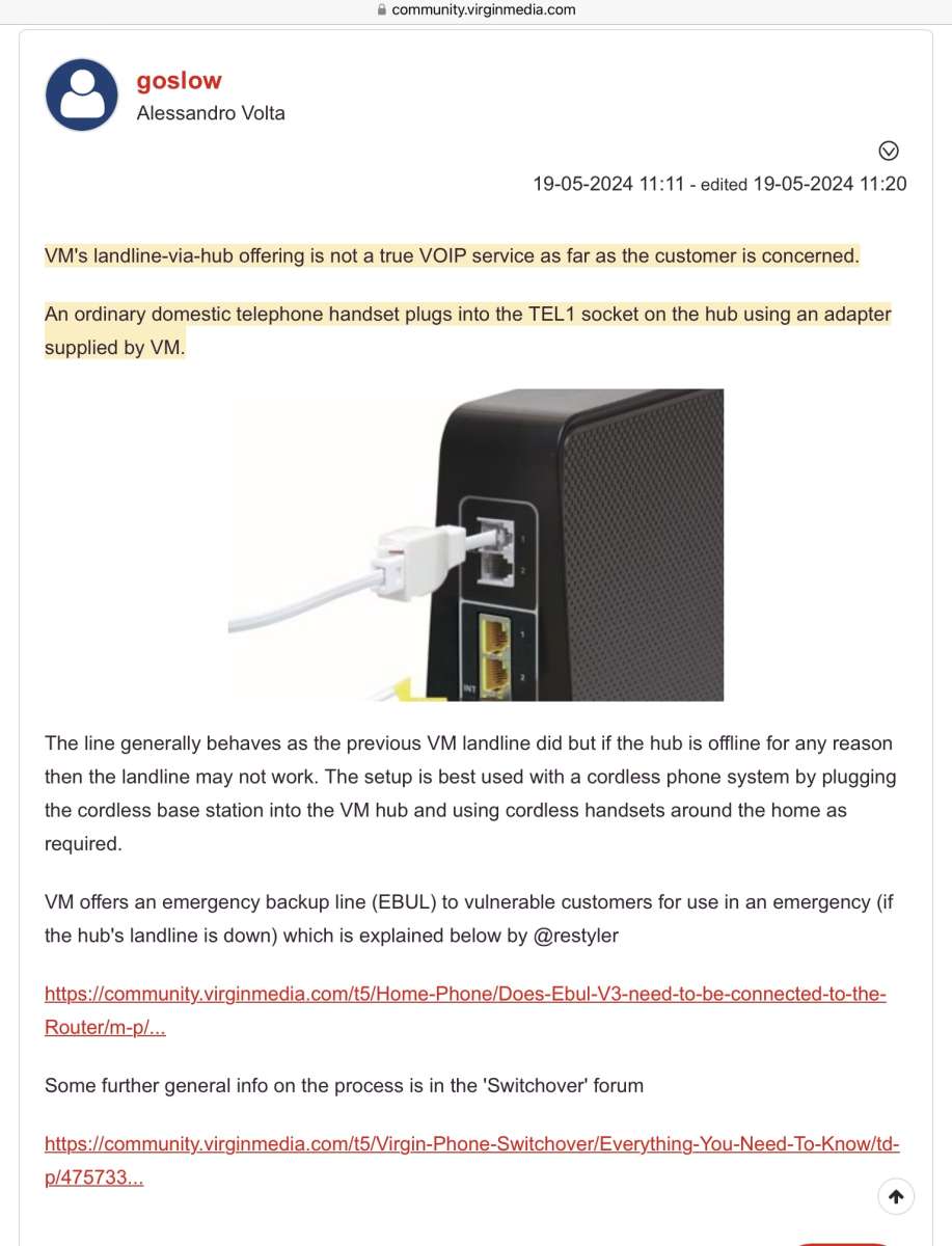

                          #746153
                          Vic
                            @vic
                            IMG_1744
                            #746159

                                  An old thread I know, but I thought I’d tack this on rather than start a new one if nobody minds.
                                  its a year later and Virginmedia still haven’t offered us VOIP or even their own pseudo VOIP service. Not that this bothers us. They are though going to put prices up again soon and as we don’t use their TV service too much I’ve decided to jump ship. We have a fairly new 900 mbps broadband service in the area for £25 a month so I’ve booked an installation. They don’t offer VOIP though. Speaking to one of their reps a while back he suggested using a VOIP service like Vonage once I’d signed up with them. Looking online there seem to be a few options. Do any of you have experience of any of them? I plan to use our old phones so I’ll need to get an ATA as well.
                                  Top 5 UK Residential VoIP Providers

                                        #825854
                                        Vic
                                          @vic
                                          We’ve now switched Broadband providers and signed up with a company called Phonely.
                                          Virginmedia have accepted the porting request and Phonely sent us an adapter for our existing phones.
                                          I did look at the possibility of getting a new VOIP phone but there aren’t too many brands and the information seemed a bit sparse so I gave up.
                                          Given the old service is allegedly to be discontinued soon I was quite surprised at the huge number of different handsets still available for it.
