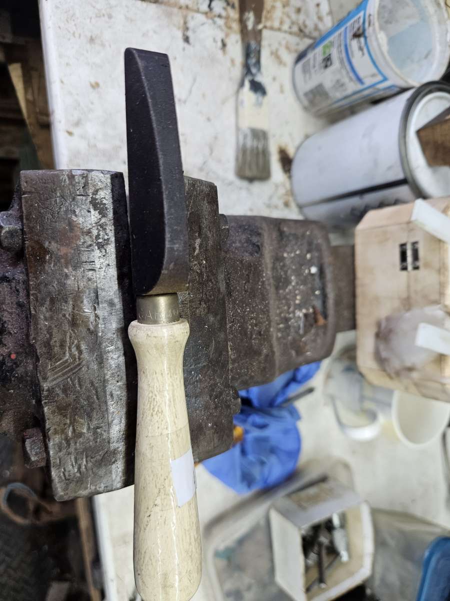

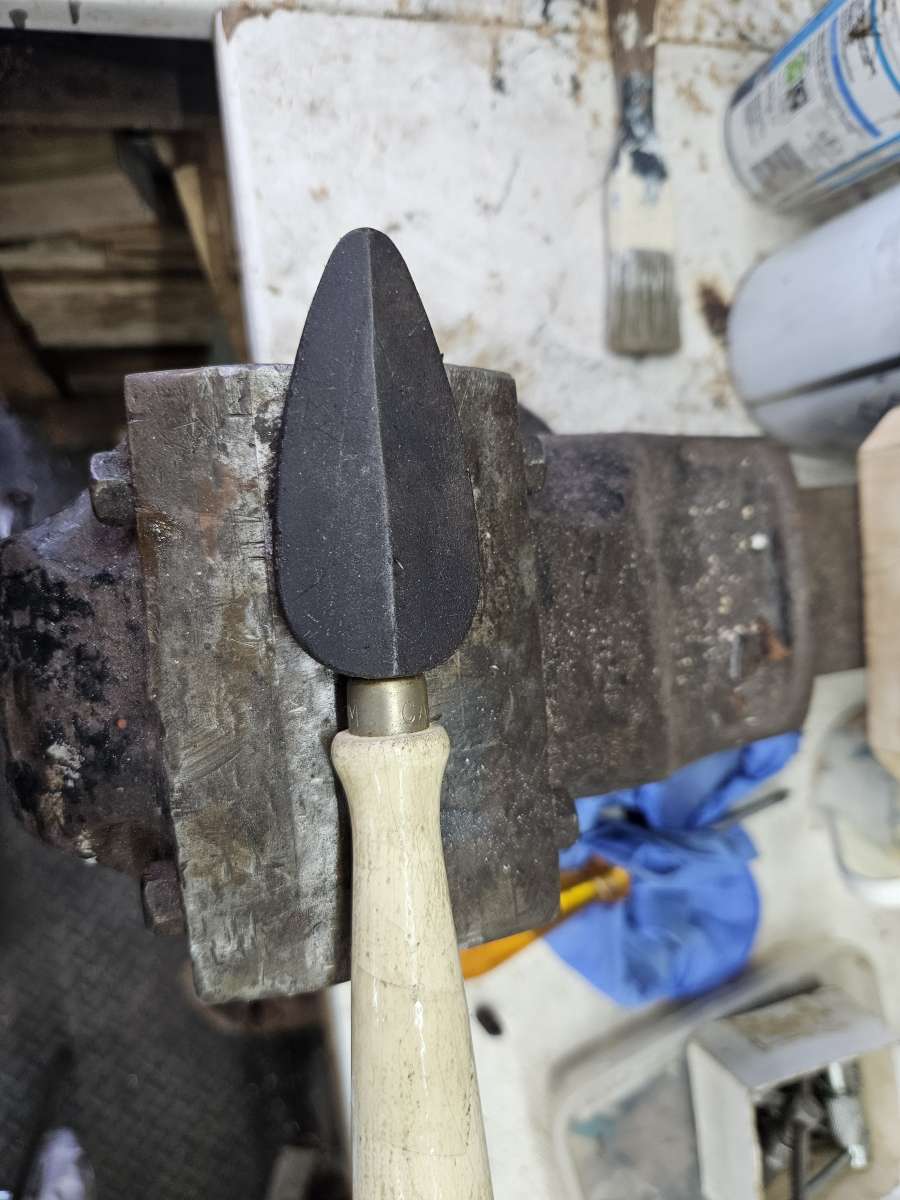

      Do20260906_18305920260906_183050es anyone know what this tool is? It appears to be a very fine grindstone, but for what job particularly?

      not done it yet
        @notdoneityet
        Are you sure it is not made of Carbon?  If it is, it’s possibly a marver for use by those shaping melted glass items.

            #863947
            Macolm
              @macolm
              Sharpening stone (depending on size) for scythe, sickle, sword, or large knife.

                      #864070
                      James A
                        @jamesalford67616
                        Thank you for all of the replies, suggestions and links. Yes, it does say carborundum on the ferrule, which I had either not noticed or had forgotten.
                        It does look unused as far as I can tell. I bought it for honing HSS tools, but perhaps that will be a waste. Mind you, it was only £3.00.
                        James.
