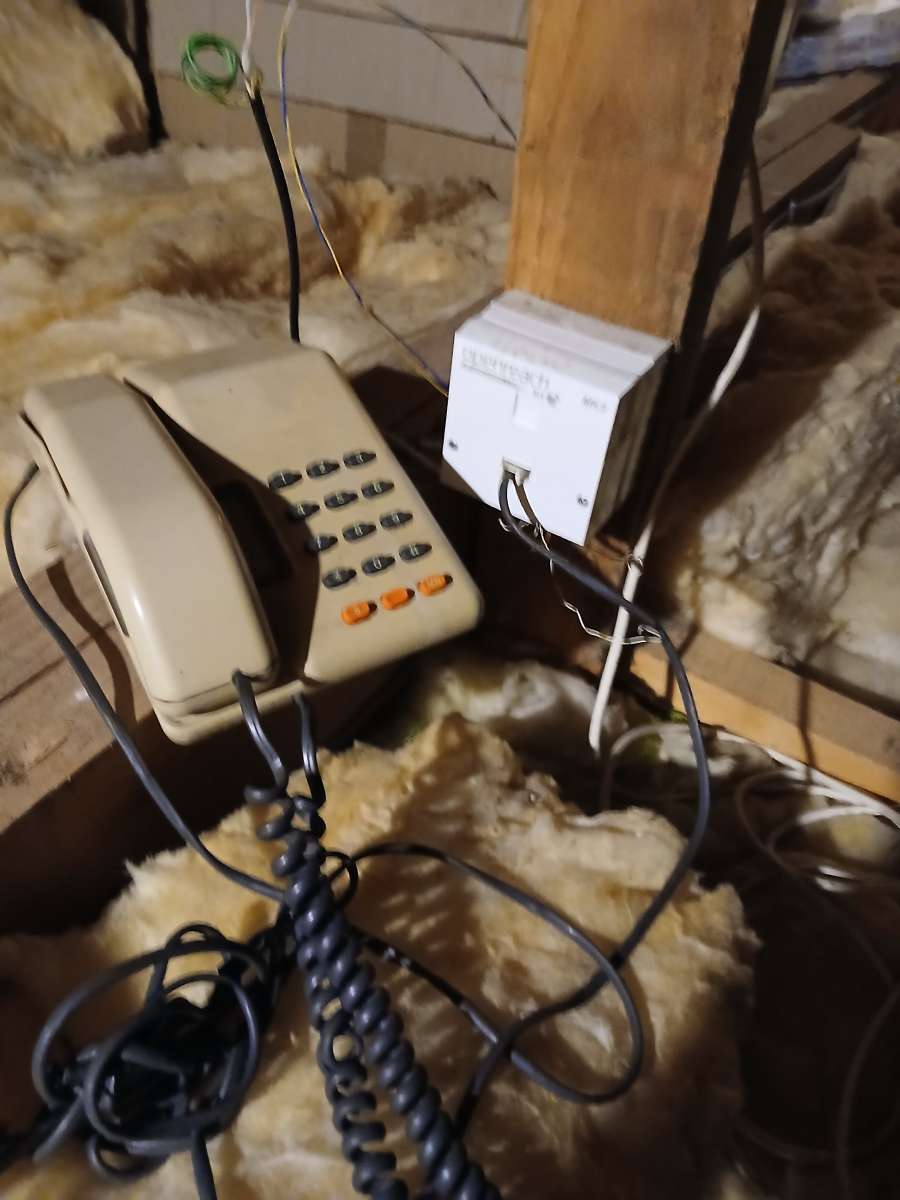

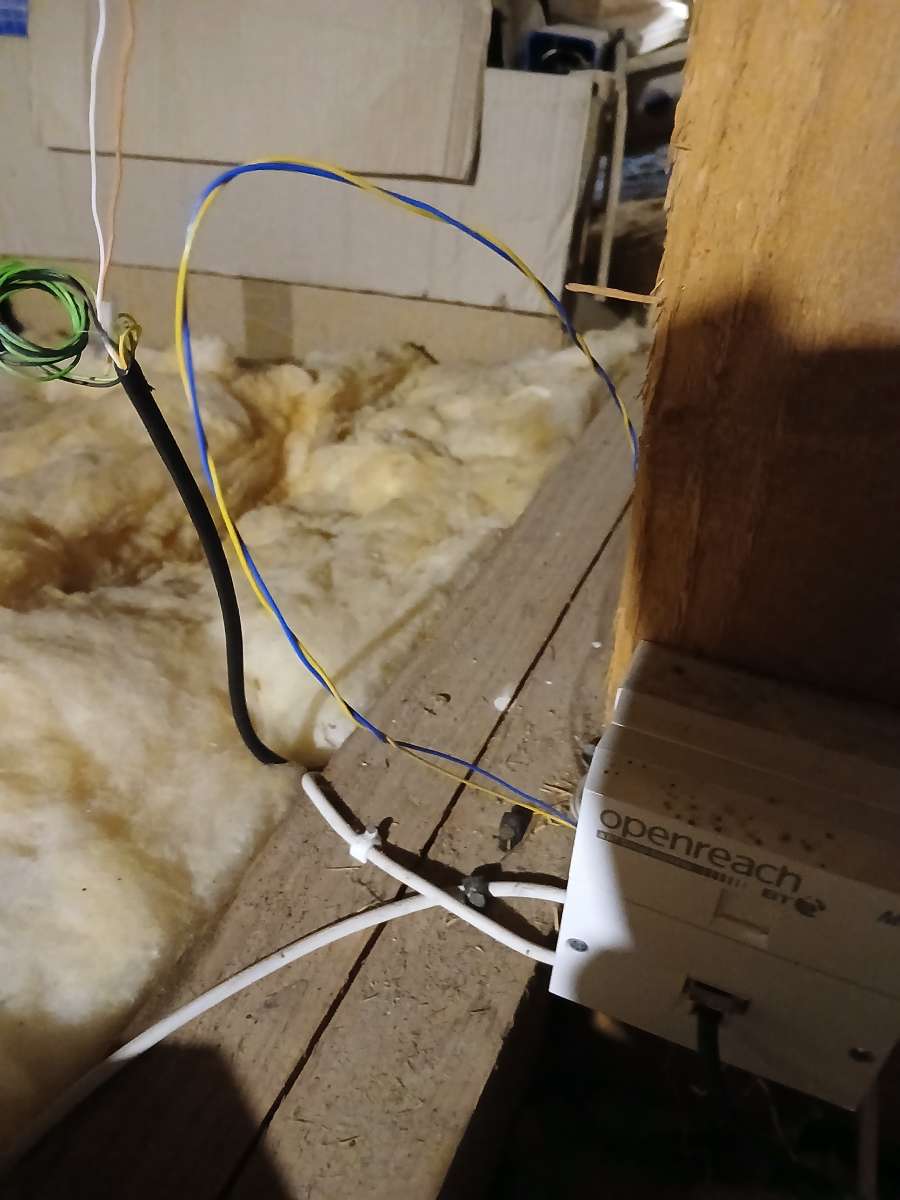

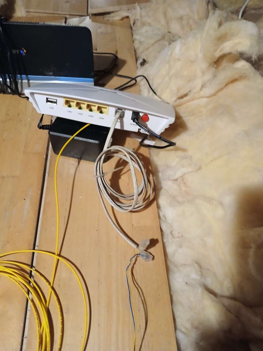

                                  “Briefly, they provide a black-box with phone socket on the back:”
                                  If you mean by ‘black box’ a fibre router, then yes this what the fibre ISP will supply but it will not have a ‘phone socket’ on the back if you mean by this the ‘traditional’ BT type socket. It will have an analogue RJ11 socket which will accept an RJ11 to BT socket adapter and you can plug a tone dialling analogue phone into this and get dial tone, provided you have opted to have a ‘land-line’ service with your ISP. But the chances are, especially with an older model of phone, that it will not ring if you receive a call. This is because older phones need the capacitor that is contained in a BT master socket in order to filter off the AC ringing current.
                                  You have to cut the BT socket off the adapter and connect the two central conductors of the ribbon cable (it’s usually a ribbon cable on the adapter) to the IDC (insulation displacement connector) terminals 2 & 5 of the BT master socket. Your phone should now ring. If you are changing your ISP at the same time as having a fibre connection, and wish to retain your landline service and number, this will need to be ‘ported’ over to your new ISP provider just like if you changed your mobile phone provider and kept your original mobile number. The is likely to be a small charge to pay for this operation.
                                  If you have a domestic copper network which is usually a chain of sockets connected in series around the house using terminals 2,3, & 5 from the master to extension sockets, then all you have to do is replace the two old incoming copper landline wires (usually orange and white, but could be black and green) in the back of the master socket with the two central conductors from your RJ11 adapter. Your old copper domestic network and all your existing analogue phones, providing they are tone dialling, will function exactly as they did before subject to REN limitations.
                                  It’s so easy to do, it’s about a 5 minute job in total. You do not need to go to the expense of buying an ATA, a new VOIP phone or re-cabling your home network for ethernet. It’s all built into your new fibre router but it only has one input via the RJ11 socket, hence use your old copper network as described above.

                                        With the greatest respect, it is not complicated, a mentally retarded chimpanzee could do it in about five minutes flat! It means you can you use all your existing household sockets and phones, save on buying new phones and if you have an analogue compatible DECT base station already plugged into your BT socket it will still function exactly as it has been doing and serve all the remote handsets associated with it. Again, with the greatest respect, it seems that it is you who is trying to complicate the issue. BTW, RJ11 adapters are available on eBay for £2.57 including postage. Would you rather pay that or buy a new VOIP phone?

                                              Here’s some photo’s to show you what I mean. The first shows the fibre router which I have in my loft to keep it out the way (propped up on the old BT router’s wall wart) showing the RJ11 lead that I used. It wasn’t long enough to reach the old BT master socket so I extended it with a length of old two-wire jumper that I happened to have and you see the connection. The second photo shows the the other end of the jumper going into the back of the BT master socket from where the domestic copper network begins and loops round sockets in all the bedrooms and hall etc. You can see the old copper land-line cable sticking up at the side of it disconnected. The third photo shows an old tone dialling analogue phone that I used for proving dial tone and a test call which I left in the loft simply because I couldn’t be bothered to take it back down to the shed.
                                              Fibre Rtr RJ11BT Mstr SktOld Test Phone

                                                On Chris Crew Said:
                                                “There will be fireworks if lots of BT customers find getting their phone to ring is as complicated as Chris describes!”
                                                Really?  All the mentally retarded chimp has to do is ‘cut the BT socket off the adapter and connect the two central conductors of the ribbon cable (it’s usually a ribbon cable on the adapter) to the IDC (insulation displacement connector) terminals 2 & 5 of the BT master socket.‘   Presumably the chimp owns a pair of wire cutters, knows what a BT Master Socket is, and can identify numbered terminals!
                                                Few households would be able or willing to follow Chris’s advice.  Many full function humans don’t understand electrickery or have the necessary tools needed to follow his instructions!  But I don’t believe cutting wires is necessary, provided the customer owns a modern phone.   BT’s explanation and the phone shown being plugged straight into a BT SmartHub2 in the video I linked, both suggest the old phone is just plugged.   Mostly; there are bound to be exceptions!
