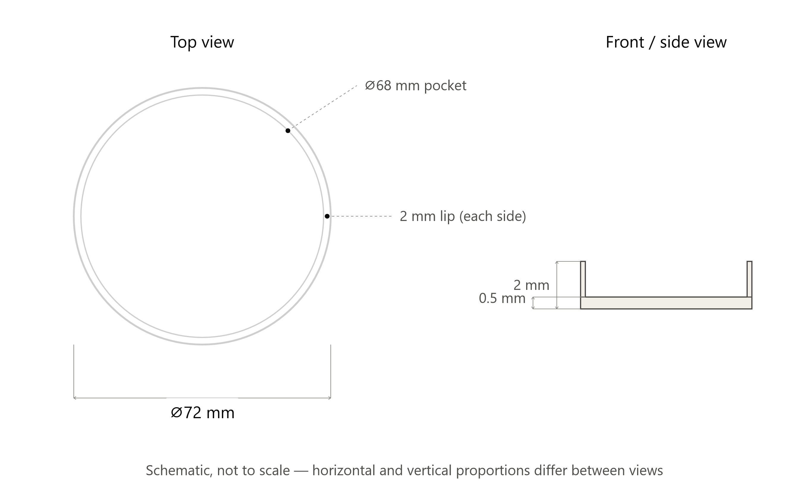

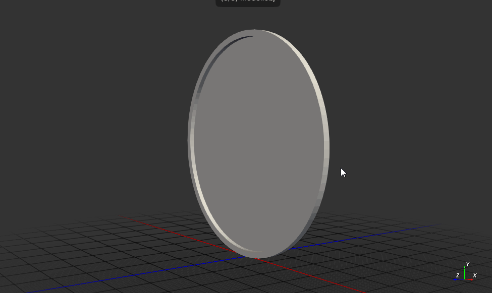

      Working on creating a disk with a lip on its border, this will be my first real lathe project. Starting stock is flat Galvanised sheet, roughly 100x100mm, 2mm thick. I’ll be making these in small batches, always the same size
      I have chosen to go with the Colchester Master lathe at my hackerspace, as it seems ideal, and I want to scale up my competence with Lathes.
      The hackerspace offers training, so I got that covered, I have also watched a ton of YouTube, trying to understand Lathes, and their processes
      Where am stuck on; my workpiece is just a sheet of metal and I need to find a way of securing it not just for safety but also to prevent bending, shearing, etc.
      All the videos and texts I have found for lathes out there deal with workpieces that have significant depth to them, allowing them to be clamped easily.
      Questions I’m chewing on:
      – Are sheets of metal outside the scope of Lathes?
      – Best way to mount a square flat blank for a first operation, faceplate?
      – At 2mm thick, is this thin enough to need a proper backing/support setup, or is it fine as is?
      – Any tips for making sure the pocket cut never breaks through into whatever’s behind it?
      plan and 3d model view of the project;
      https://i.ibb.co/F4mRQMvC/plan.png
      https://i.ibb.co/XrbbTjzk/f3d-kllvr-D5s-L7.gif

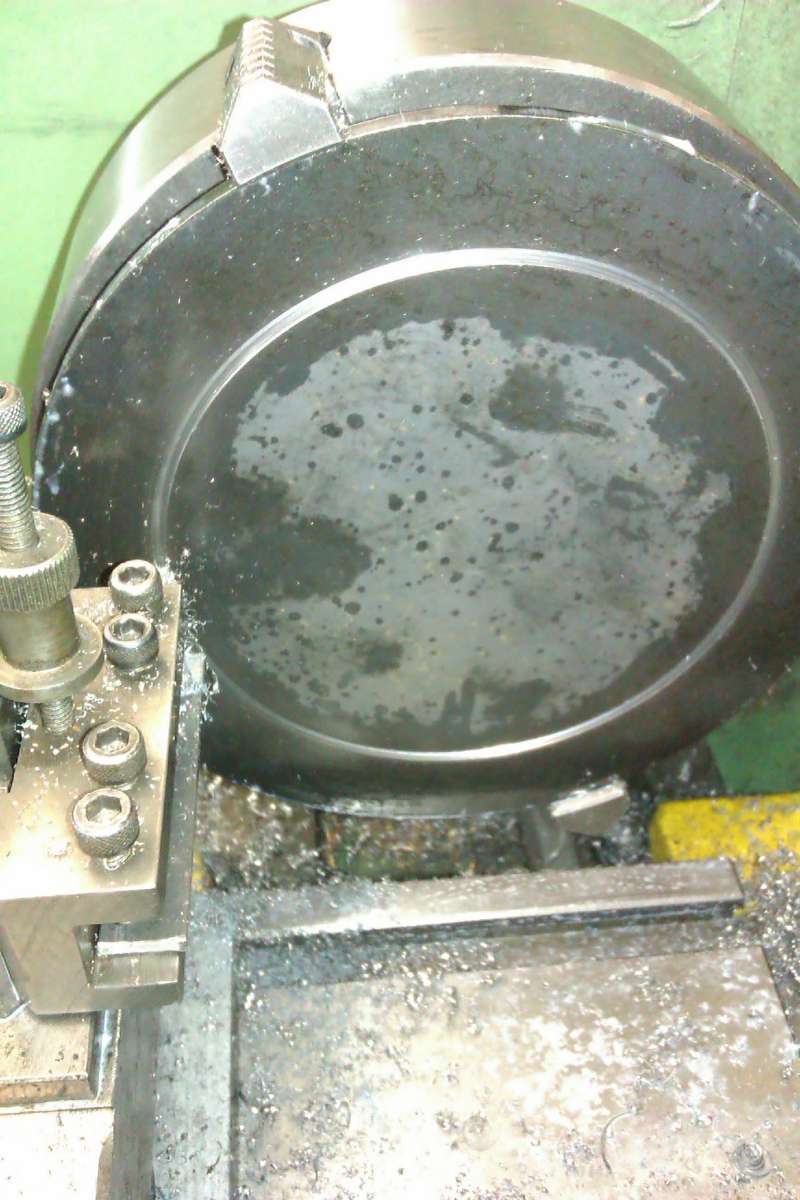

        You may get away with supergluing each blank to a flat sacrificial piece of wood which will be discarded. With luck it would hold enough to withstand cutting forces if you take very light cuts very slowly with a sharp tool. Hold the backing in a 4 jaw. Heat to separate (boil) and expect to need a new backing for each one.
        Why are you using 2mm sheet when the total depth is 2.5mm?

          There are several ways to hold thin sheet but looking at your design I think that will be the least of your problems. If I understand the drawing you want to recess the face of the disk to leave a 0.5mm thickness to the base in gummy galvanized steel sheet.

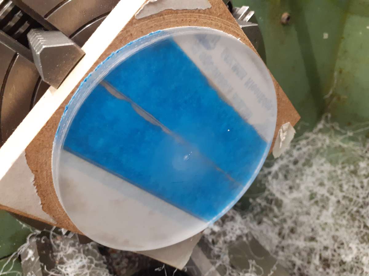

          One method is to bond the sheet to a backing such as a piece of MDF which in turn can be fixed to a faceplate. However the heat and your thin final thickness is likely to see the bond break or at the very least you will get an uneven 0.5mm bottom. That can be improved uppon by drilling the corners of your square plate for some small screws which will take the drive loads but I still worry about the thin base lifting.

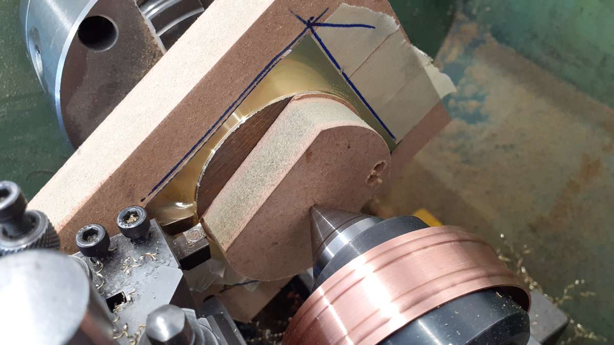

          If you do get the base machined then to cut the OD You can trepan it from the sheet while still screwed and bonded to the backing. Or remove from backing, saw off the corners to reduce the amount of turning. Then use a pressure pad to push the work against the backing and turn the OD to size.
          Spinning or pressing 0.5mm sheet would be a better option to turn up the sides if 0.5mm thickness is OK for them.

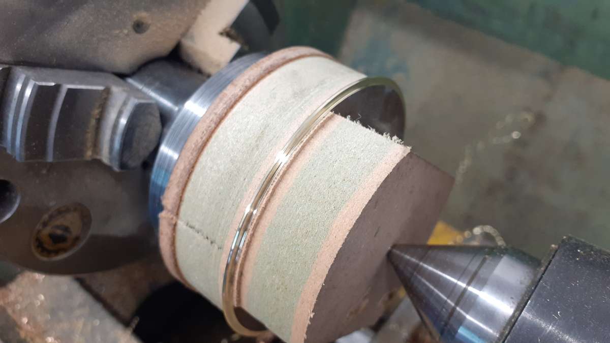

          Couple of shots of a pressure pad in use
          20230625_095025
          20230625_134552Although this shows acrylic sheet the method works with metal. Tape is applied to the backing board and also the work. You then superglue the two taped surface stogether and when dry can turn the item. Backing board held in a chuck in this case. You don’t need to heat/boil the superglue to break the bond the tape will peel off so the same backing can be used multiple times.
          20201029_140324
          Trepanning is using a thin tool to cut in from the face.
          IMAG2178
          IMAG2182
            John, overall is 2mm thick

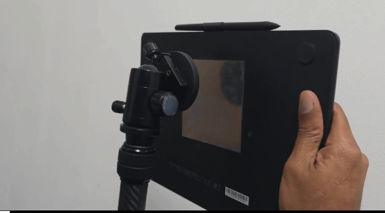

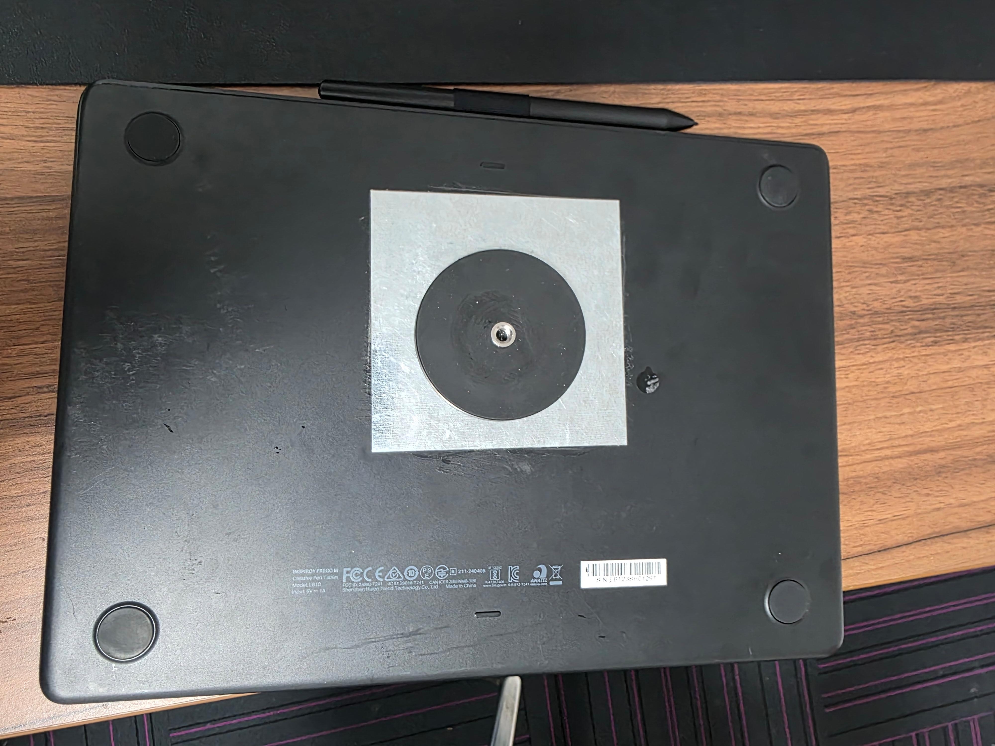

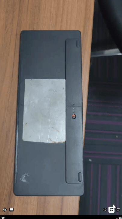

                                What this is for
                                For a few years I’ve been using a “quick mounting system”; a steel sheet glued to the back of a device with 3M tape, and a magnet attached to whatever is holding it, a tripod head, a repurposed monitor arm, a chair arm, a friction arm. The idea is to temporarily mount things like a tablet, keyboard, MIDI keys, monitor, painting easel, paint mixing surface, sketchbook holder, and dismount with a pull/tear force. I’m constantly switching between projects through the day in my studio, and this is what’s worked best for that.
                                Photo of it installed on the back of a drawing tablet;
                                above drawing tablet being mounted and dismounted on a tripod;
                                Same design on a keyboard, mounted on a mini friction arm:
                                For heavier devices like monitors, I step up magnet strength, up to a switchable on/off magnet, but the disk design stays the same throughout.
                                In the case of heavy items like monitors, I will be using vesa, holes, etc to mount the disk. but this is not that important of a distinction, as heavy items are indoors only.
                                the weight and thickness of the magnetic disk
                                This is a big part of why I landed on 0.5mm/thin proportions in the first place, not an arbitrary choice. I’m deploying this extensively outdoors on my painting setups, permanently mounted to the backs of painting easel, graphics tablet, ipad, sketchbook holder or laptop. Weight is a real constraint when it comes to my bag and bike.
                                The lip solves the sliding problem I’ve had, that is gradual rotation as I adjust viewing angle causes the sheet to walk off the magnet, a circular lip would trap the magnet.

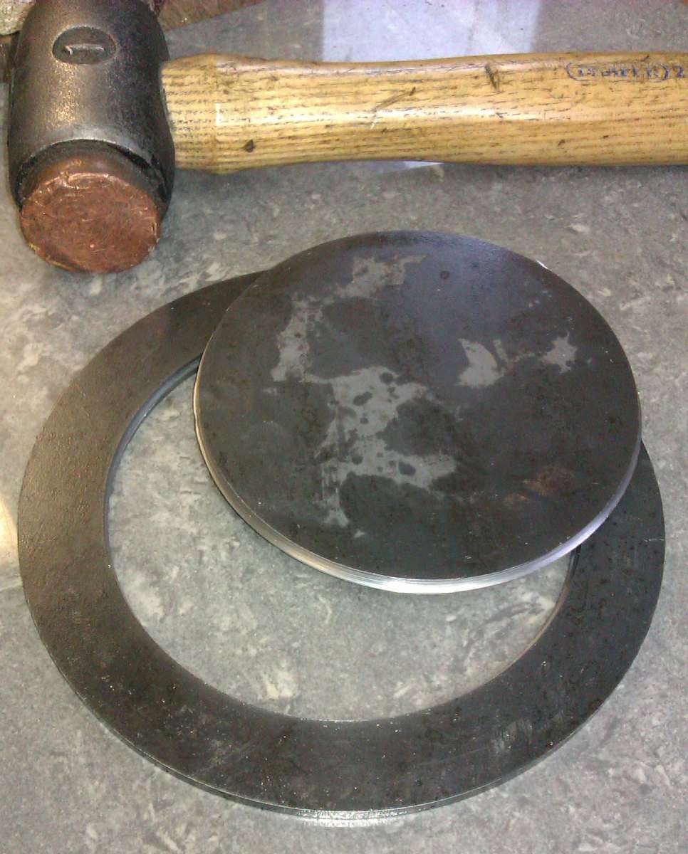

                                    Well now we know a bit more I would go to one of the online laser cutting services and get a dozen or so 72mm discs cut  from uncoated 2mm mild steel. This will save having to turn the square into a circle.Any sheet steel will not have the ideal machining properties but will be magnetic and easier then slices cut from a more machinable round bar.
                                    Online price from Lasermasters about £4.50 each for 72mm you could will find cheaper if you go for a standard size off ebay, 75mm would cost £2.50ea
                                    While you are ordering get a single disc of say 5mm steel cut to 0.5mm smaller dia. Same if off ebay, just file 3 flats at 120deg to clear the chuck jaws as detailed below
                                    You can then use a standard 3-jaw chuck, slip the 5mm backing plate in first as this will stop the thing 0.5mm bottom deflecting away from the tool. Then put a blank disc into the chuck pushing it well back against the 5mm plate and chuck jaws while you tighten the chuck.
                                    A boring type tool or insert boring bar with CCGT insert can then be used to cut therecess starting from the inside out. If the design would allow a small say 5mm hole in the middle that would make it a lot easier to use the boring tool a syou can feed into the hole to put on a cut and then move outwards.
                                    As said by someone else set the top slide parallel to the lathe axis. Touch the tool against the work and zero the handwheel dial (or dro) and then you can use the dial to make sure you only cut 1.5mm deep or 0.060″ if it has old imperial divisions
