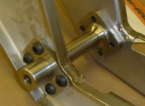

                    #214874
                    Martin Connelly
                      @martinconnelly55370
                      This is one of the parts in stainless that I made for the UK Monowheel Team's record holding Warhorse. See their facebook page for further details. (Welding by someone else)
                      Martin
