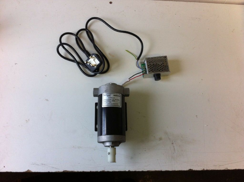

      I bought a treadmill motor and controller to power a die filer.
      The die filer is c1910 vintage and I wish to build a housing for both motor and controller.
      50/50 to keep the filings out / to hide them as far as possible. It will be on a movable baseboard to sit on my workbench, the motor cannot go underneath
      as the working height would be too great. So something aesthetically pleasing, possibly both wood and metal.
      The motor itself is open each end ie likely needs some ventilation. The control box as you can see in the photo has a perforated casing suggesting this too needs some airflow around it.
      A visiting electritan suggested 1/2" or so gap around the controller would be fine, but as I have no idea I'm asking the question, how much space between the components and any housings should I allow?
      I wish to keep it as compact as possible but obviously don't wish it to overheat.
      Thanks
      Chris.

          #506247
          IanT
            @iant
            I think you've already answered your question Chris.

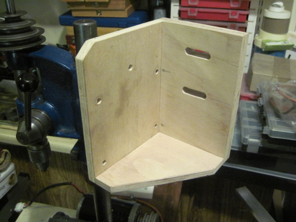

            It sounds like a simple box at the rear of the base will do the business. You will need to bring the shaft out to one side to drive the filer and make a hole for the speed control. Bring the power lead out the back and make sure it's well anchored. You could make the box out of sheet metal but I find 6mm ply is very convenient for this kind of thing. If you think ventilation is an issue, make some slots in the back. Make the box large enough to take the parts and to look like it was designed (rather than just knocked together) and I'm sure it will be fine.
            I've just converted my 1/4" Cowells drill to DC drive. I needed to mount the motor and after faffing around with various bits of angle iron, finally just made an open box to hold the motor and give some adjustment for belt tension. The PSU (which sits behind the drill pillar) came in a somewhat flimsy plastic case, so a ply cover will be used to keep out wandering swarf. The motor didn't have 'feet' as such, so I printed a 3D saddle to hold it (designed in Open SCAD).
            It's all painted etc now and looks fairly neat and seems to work – I've still some things to tidy up. Here is the open ply 'box' before painting etc. A 2x4ft sheet of 6mm ply is not expensive and can be used for all sorts of jobs like this. The slots were drilled at each end and then just cut with a jig saw.
            Try it and if you have problems, then change or improve it – it will probably be fine but maybe not. Either way you will learn what is required in practice, without breaking the bank or spending loads of time on an overkill.

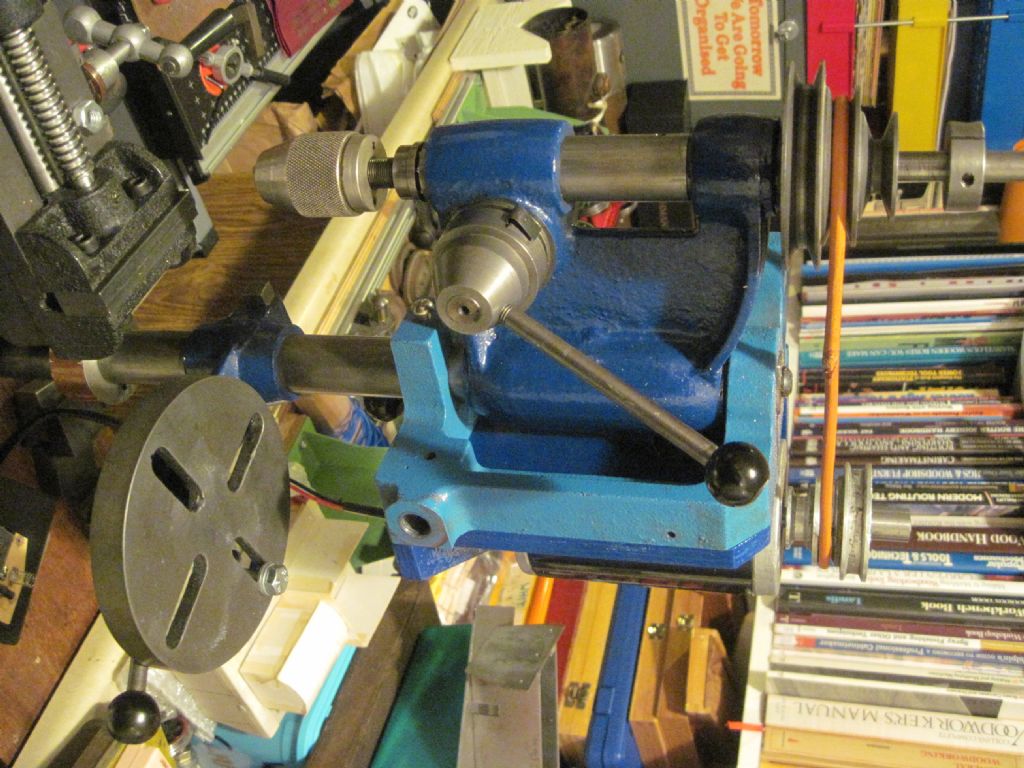

                #506301
                IanT
                  @iant
                  PS – It kind of looks like this – the (much larger) motor was sat behind the drill previously with the belt running up and over jockey pulleys. This arrangement seems neater and the belt is quieter.
                  I use both the original drill table and the compound vice (which can just be lifted off). I've fitted extra bearings and reversed the 'Y' handle to make it a bit easier to use. It's not intended to be an accurate X/Y table – but it is a convenient way to set up smaller work.
                  I decided to change my 'control' box around a bit – the first one was a bit too high.
                  Regards,
                  IanT
