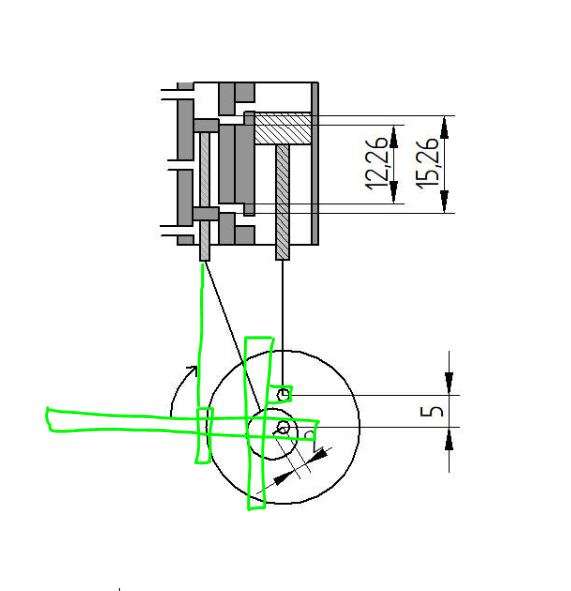

      I am trying to draw some plans for a simple piston valve engine, but am a bit unsure about the timing of the valve to the piston. Can anyone clarify the following for me, please?
      If the valve has no lap or lead and the piston is at top dead centre, am I right in thinking that the piston valve will also be at top centre, with both ports being open? I have put the drawing below: I hope that it is clear.
      Screenshot 2026-03-01 180144

        Assuming air is coming in from the middle you still want the valve to trail the crank just like it does with a slide valve leading. You valve should be just coming to midway when the piston is at TDC or BDC
        #839828

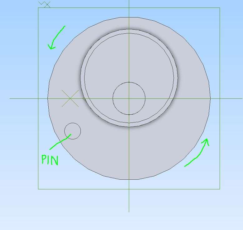

          Here is an end view of a crank with integral eccentric you can see that the high point of the eccentric is a long way (approx 120deg) behind the crankpin.
          piston crank

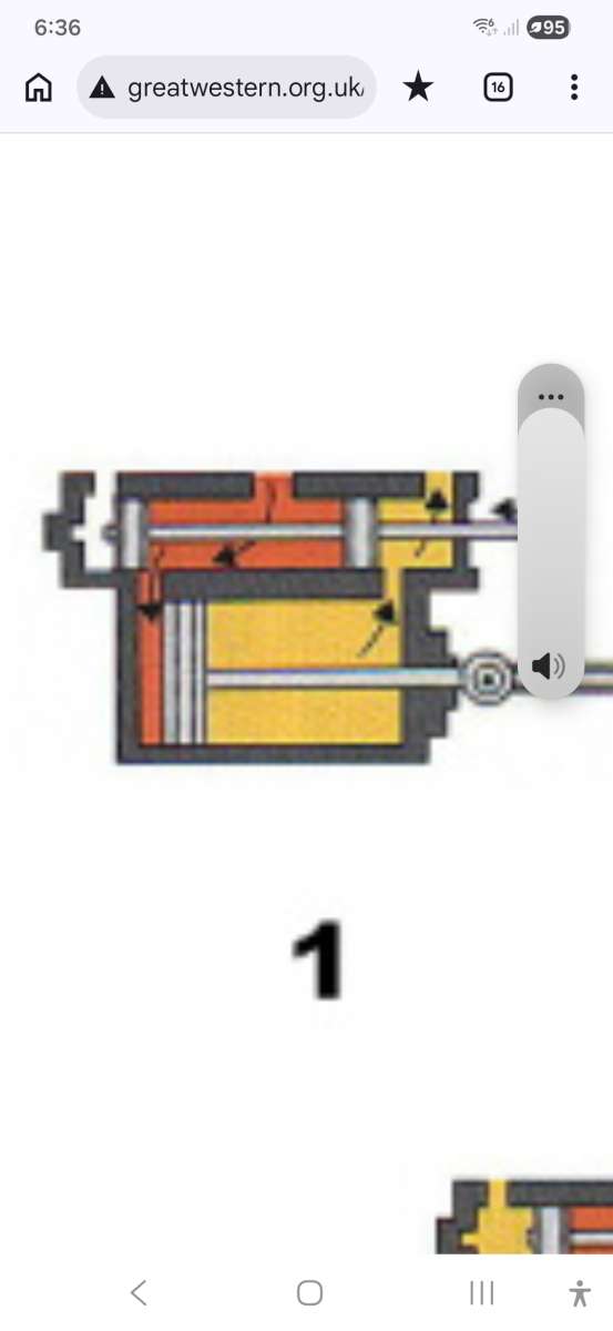

            Yes, steam will be coming in from the middle port. I thought that the position would be as you describe, but the position in the image below confused me.
            James
            Screenshot_20260301_183646_Chrome

                I am unclear, though, why the valve positions in Jason’s explanation and the screenshot that I posted appear to be so very different.
                James.
                #839867
                duncan webster 1
                  @duncanwebster1
                  because the screen shot is wrong. With the piston at tdc the valve should be just very slightly open to let steam in. This is called the lead. The valve heads should also be wider than the ports. This is called lap. As others have said you will be better off with some lap
                  #839875
                    Without showing the crank & eccentric positions in the screen shot it is hard to get the full picture. But bear in mind that the piston will be moving very slowly as the crankpin is around the TDC position but the eccentric will be moving the valve far faster as the lead is putting the max throw in the direction of travel not accross it like the crank. This means the ports are uncovered very quickly in relation to the piston only moving a short distance.
                    So in that image 1 the inlet port may have only just become uncovered as the piston was 1mm from TDC, by the time it has reached TDC the port is half uncovered as shown* and by the time the piston has moved down from TDC by 1mm the port could be completeley uncovered. So that is say 90% of the valves travel while the piston may have moved less than 10% of it’s travel.
                    * The image does not show the valve at the top of it’s travel a sthe port is not fully uncovered. If you look at the full set of four images B shows the valve at it’s furthest travel and teh port fully uncovered yet the piston is well on it’s way to BDC

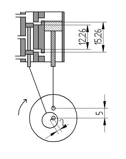

                              Thank you for the replies and advice. I have amended my design and hope that it is now about right. Does the following arrangement appear to be workable or am I still barking up the wrong tree?
                              Port size 1.5mm
                              Valve width 2mm
                              Lap 0.5mm
                              Valve Travel 4mm
                              Eccentric throw 2mm
                              Eccentric is 120 degrees behind the piston
                              Screenshot 2026-03-07 104905
                              James.
                              #840423
                                That looks about right.
                                Have the valve so the outer two faces are 15.26 so the 0.5mm overlaps are on the inner edge. That way you get the exhaust opening before the inlet.
                                #840427
                                Martin Johnson 1
                                  @martinjohnson1
                                  You would normally design to uncover the full port to exhaust, so with a valve travel of 4 mm then 2mm ports would be good (or reduce valve travel to 3mm).
                                  As Jason says, the exhast edges on the valve should be the (presently) 15.26 dimension.  You can have exhaust lap as well but not really relevant to models.
                                  Draw that Reauleaux diagram and you will find the correct eccentric angle.
                                  I hope the proposed engine has a longer con rod than your diagram shows which will give less angularity on the valve drive.
                                  Martin

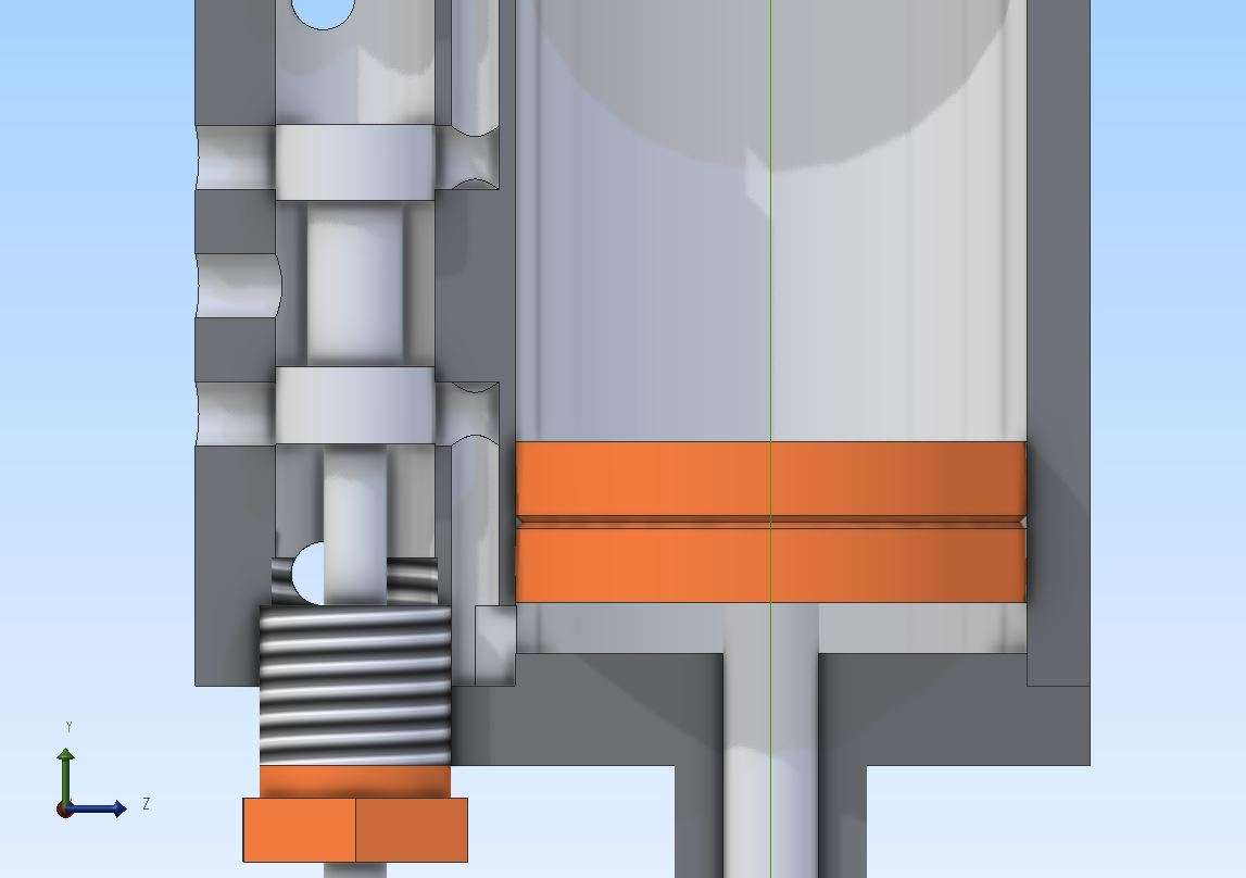

                                    Martin, the design will fully uncover the exhaust ports. Also fully uncovers the inlet. 2mm ports risks having both open if drilling is a bit off, reduced travel will not fully open the inlet
                                    As for the conrod, I expect it is a schematic drawing and the crankshaft actually runs at 90deg to what is shown. Could get a few crashes if the conrod and eccentric are on the same plane
                                    Here is one I prepared earlier. Slightly larger but very similar proportions.
                                    2mm ports
                                    2.5mm valve
                                    0.5mm lap
                                    2.5mm throw = 5mm movement
                                    Reduce all those by 25% and I just have slightly less lap.
                                    piston

                                      Thank you for the further replies and reassurance that the overall design is about right.
                                      Martin: I shall draw the diagram as you suggest to see what angle it produces. Thank you for the suggestion.
                                      Jason: Thank you for taking the time to check and comment upon the design. The inside dimension of the valve faces is as you suggest, with a half millimetre lap on the inside faces.
                                      As you assume, the crank and flywheel aspect is only schematic to show the off-set for the crank pin and the eccentric and needs some more work. I am a little puzzled, though, when you say about the crankshaft running at 90 degrees to what is shown. Could you please clarify that?
