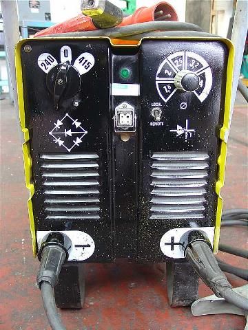

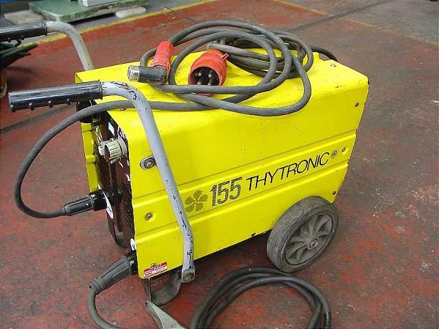

      welder 2.jpgHi,posted this on the welding forum but had no luck.Does anyone have or has had one of these?I was given it and was told it could be used to tig weld there were no leads with the one I got.The welder in the pics are identical to the one I have.welder 1.jpg

          Don't take this as the gospel word, because I'm still fairly far down the bottom of this learning curve… However my understanding is that pretty much any DC welder will be usable as the power supply for DC TIG welding, but you need the ancillary bits and gismos around it to make it work.
          In this instance you need a TIG torch and a source of shielding gas. This machine doesn't seem to have the controls for the gas built in, so the gas goes direct to the torch, and needs to be controlled somehow by the trigger. The other thing is that the welder you have doesn't have an on off switch, so the torch is always live, neither (AFAIK) have HF start feature so you will have to use it scratch start (I.e. the electrode is touched to the work piece and then dragged away quickly (but not too far!)
          All this, and the inherent difficulties of learning to TIG weld (it's not as easy as the guys on Youtube make it look) mean that this isn't, I don't think, the place from which to start. Just getting the electrode contaminated will frustrate you for days – so I think a beginner has got to start with a more expensive but more controlled machine and concentrate on the technique. Once you've got good at it and understand causes of weld faults then make it more difficult by using equipment which is more difficult to control and set up (but why would you want to!!!!)
          You can buy a TIG torch on ebay which has a trigger controlled valve which will turn the gas on and off, you may be able to remote control this welder via that four pin plug on the front panel, if you get past that you will almost certainly get demoralised because scratch-start almost inevitably contaminates the electrode and then you have to stop and grind it clean and so on and so on. Then there's the little matter of hand-eye co-ordination… As they say in these parts – "If I was you wouldn't start from ere!"
          If you want to TIG weld buy a TIG welder. It's quite an expensive facility to have in your workshop, but it's very useful.

              Hi the 4 pin plug is for current control hence the local/remote switch

                I also agree with Michael about the current control, which is handy if your welding in a hard place to get in and out of and can not reach the welder control.

                    Stick and TIG require constant current (CC) sources, whereas MIG / MAG requires constant voltage (CV). So it's possible to use one of these "HF units" to piggy back onto a stick welder but not a MIG /MAG machine. I used to have one of these HF units but never used it as I acquired a proper Interlas AC/DC TIG unit. An add-on HF unit is only half a solution.
                    Generally they contain the HF source itself (a spark gap and an air cored transformer to couple the spark to the torch for arc initiation and stabilisation) and solenoids for the gas and water. These need some form of control, so there's usually a torch or foot trigger input and sometimes a post flow timer. As the power source is in control of output current, there is no simple way to vary or enable the arc from the HF unit.
                    There are some pretty decent looking inverter TIG welders these days. If I didn't have the Interlas I'd probably have gone for one myself. If you only need to weld steel, DC will suffice. If you want to be able to weld aluminium, you will need an AC machine which will cost more. I can't imagine why you'd want to buy an ancient HF unit when you could instead spend the money on an inverter welder.

                      BTW, this is the splitting image of my CEA Monomig 180 MIG welder, so presumably of very similar vintage, albeit a different model (MIG in my case). I acquired it 10 years ago and when I contacted CEA for a manual back then, they said it was "very very old". They managed to dig something out from their archives which was useful to me but it does mean that our machines date from The Ark and can't be long for this world. Just be wary before investing too much time and money on it. I've already had a few intermittent issues with mine….
