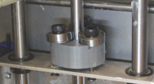

            Seem to show up in 3D printers *** LINK ***
            Principle can be seen in photo where bearings are on the skew.

              That's the Badger!
              Its a simple cheap and effective solution.
              It appears the correct term is uhing (seen here from the link in Journeyman's post).
              Thank you for the info.
