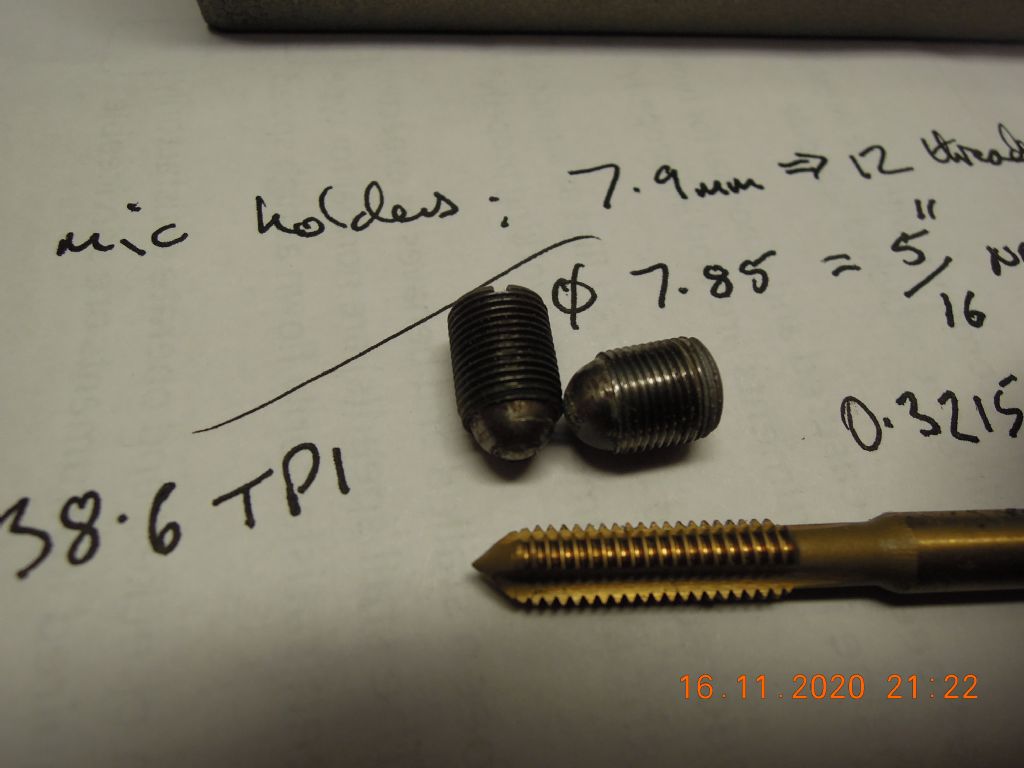

      Hoping someone can help me identify a thread. I have several on my OMT that are nominally 5/16 diameter but have a very fine thread which I determine using calipers to be approx. 38.6TPI. I think it must be some kind of instrument thread but cant find anything as fine as this on the web but I probably just haven't looked in the right places !. Just for comparison, in the picture below I've included a 7/32-28 BSF tap.

              If imperial likely to be 40 TPI

                  Looks a GB make so 40 TPI?
                  Tony

                    Could you not use the microscope itself to measure the thread pitch, a caliper won't cut it.

                      Beaten to it, but 5/16" x 40tpi is a standard ME thread.

                        It does not seem metric at all – the pitch works out as 0.658mm – so I'd go with 40tpi as others say.
                        If you have a set of ME taps, you could try making a 5/16 X 40 comparator in an oddment of material friendly to the component, like brass or aluminium.

                            Thanks all for your efforts. 40 tpi was all I could conclude too. Working backwards I only need to be a third of a pitch out with the calipers and that would be the difference. I think you are right Tony – even when I magnify the calipers what looked like sharp points in the ends of the anvils turn into very rounded off clubs and it doesnt really improve accuracy.
                            I dont have any ME taps but I have found a cheap one so I will buy that and see how it looks.
                            #507885
                              Measure over 10 threads not one then any error will be less. You could also start the screw into a hole and measure how much it protrudes, then screw it in 10 turns and measure again, Divide result by 10 to get pitch.

                                        Easy to check … Just use a 4BA screw as a thread [pitch and profile] gauge
                                        BA is 47.5° so it should be pretty obvious if the mystery thread is 55° or 60°

                                          Well, I tried the 4BA up against the grub screw and it was close… but just didn't feel quite comfortable. I then dug through my tap collection and stumbled across a 1/8BSW which is 40 TPI. Offered it up and it fitted like a glove, at least on pitch. Its just too small, or too late at night to compare the thread forms but hey for £3 I cant go wrong with the 5/16 ME and I'll order one tomorrow.
                                          Thanks all for your suggestions and thoughts. Appreciated.
