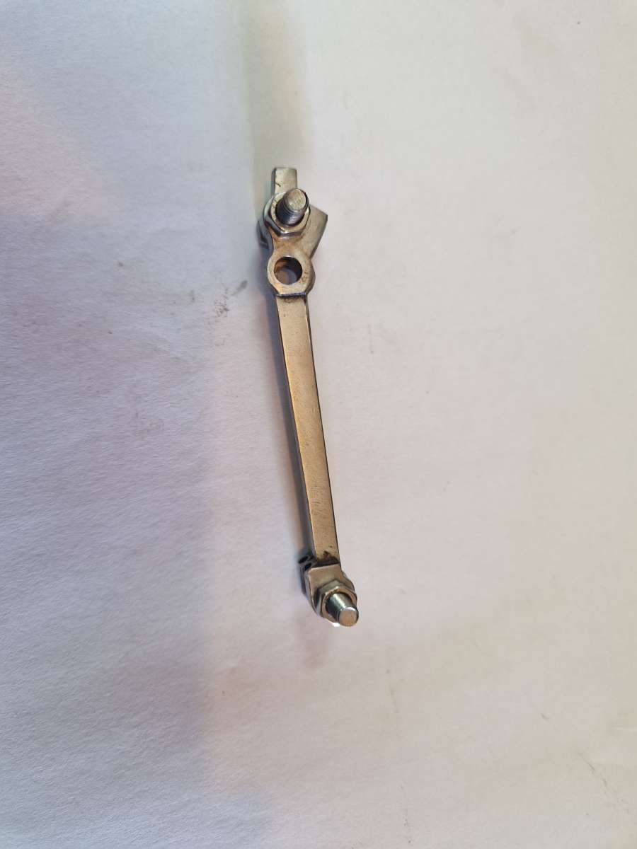

I started to look at the workings of the 9F and having heard it’s steam circuit was poor, I thought I would start at the regulator handle, the linkage was loose and poorly fitted. Having got it working I was not happy with the way the regulator and it’s spindle worked, lumpy and tight. The dome cover is secured in theory by a 6BA countersunk bolt but the threaded hole it goes into is already used. The dome cover plate supports the regulator assembly on a 6BA bolt in a threaded hole and another threaded hole in the regulator support. The regulator spindle has a a milled hole to take the flattened end of the 1/4″ ball valve spindle. Having removed the 12 dome plate bolts and the plate all was revealed !
In my case the 6BA bolt missed the thread in the regulator support, acted as a jack screw, twisted the regulator and split the regulator spindle ! The spindle now fatter would not come out of the boiler shell bush – it did in the end !
