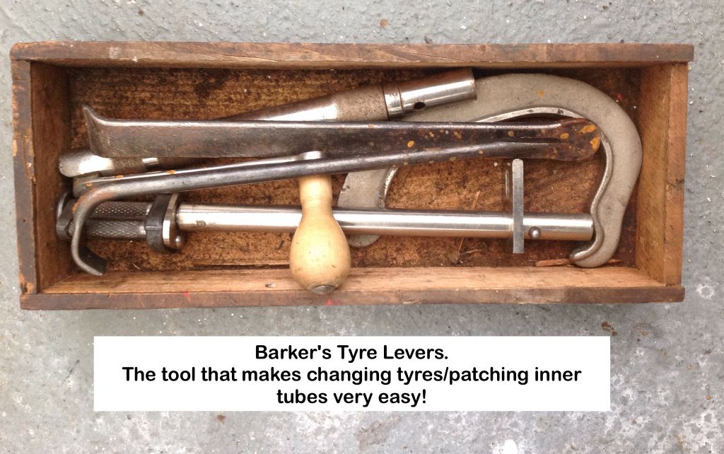

                                            I have resurrected this thread asking for any information on the header subject, to enlighten those who where asking what the tubes where for.
                                            My neighbour paid me a visit last year, and I showed him my lack of progress in removing one of the old tyres from my Ruby wheel.
                                            He was silent for a while, with that look that said he was trying to remember something.
                                            After a while he said that he had found a box that contained something that may be of interest to me, it having been part of a deal he had made in purchasing 2nd hand mowers.
                                            His business was lawn mowers.
                                            I went with him to see what this box of tricks was and couldn't quite believe what I saw.
                                            The instruction booklet was very tatty and fragile, so I said I would photocopy it before trying to sort out how it worked.
                                            Took it home, copied the instructions and put the original away for safe keeping.
                                            This is the box of parts that need assembling:
                                            Barkers Tyre Levers
                                            Is there a Sherlock Holmes in the Forum who can figure out how it works?
                                            Geoff – We will need another Noah soon!

                                              I see you have posed this question on some Austin 7 sites ? Still no clearer on how it is used But it may be easier if you lay the component out on another photo.

                                                Elementary, my dear Watson.
                                                Try the first two on the list.
                                                Edit: That's Barker's Tyre Levers sorted-out
                                                … Now, who is responsible for the other components ?

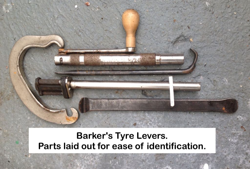

                                                  OuBallie
                                                    @ouballie
                                                    As requested by Speedy Builder5:
                                                    Barkers Tyre Levers
                                                    This should help the sleuths amongst us with luck.
                                                    Geoff – Sunny but windy, at the moment.
                                                    Edited By OuBallie on 01/02/2014 14:22:22

                                                      Geoff
                                                      Is there a canvas/material strop missing. The part with the two knurled rollers looks like it may have the same purpose as a tyre fitting tool used many years ago for spreading the tyre to the rim. That tool comprised of a strop connected to a lever system, the strop was pulled hand tight round the centre of the tread and then the lever was pulled over and this tightened the strop even further which then expanded the tyre onto the rim ready for inflation.
                                                      It looks as if the tool illustrated could be used to achieve the same result by winding the strop through the rollers until the tyre bedded onto the rim, it also meant that there was less chance of trapping the inner tube if one was fitted and certainly made the inflation of tubeless tyres much easier.
