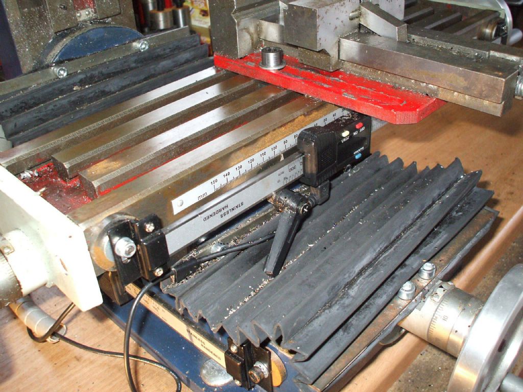

        To get to the point, I have a couple of ideas for simple machine mods which I'd like to run up the flag pole. First one:
        At the moment, I have concertina-type swarf protection on the Y-axis of my mill. They work adequately for the most part, but at the limits of the Y-axis travel, they can, and do, get caught between the table and the main body, thus restricting the table from travelling its full movement, unless I use my third hand to lift it out the way. See below
        X-axis DRO
        My solution would be to use a couple of car roller blinds, such as those used to keep the sun off the little darlings in the back seats. They are available on certain auction sites for a few pounds a pair. The roller and "blind" parts would attach to the mill in the same way as the current bellows do. For those not using flood coolant, the original mesh ought to be good enough to catch the flying bits, though hot chips (metal ones!) might be a problem!

          Hi John ,
          sounds interesting and considering the price of a new set of bellows that my local supplier sells ( a price that is bordering on cruelty ) i think is definately worth trying.
          The bellows on my X2 perished very quickly and i ended up using some rubber sheet i had laying around but this is a real PIA !
          Maybe the rear one could be mounted under the head and have a guide rail at the base of the colmn that the roller blind material would run under to keep it parrallel to the base so the material could run from the table up through the wire guide rail then up the column to keep the swarf off the column as well ?
          on the front it would be simple tp install as long as the diameter is kept as small as possible

              I must say, I had thought about extending the run exactly as you have described but initially dismissed it on the grounds that I didn't think that there would be enough travel in the roller part to accommodate the extended run of material. The only way to find out is to order a couple of blinds and experiment, I guess. Better go and sign in…….

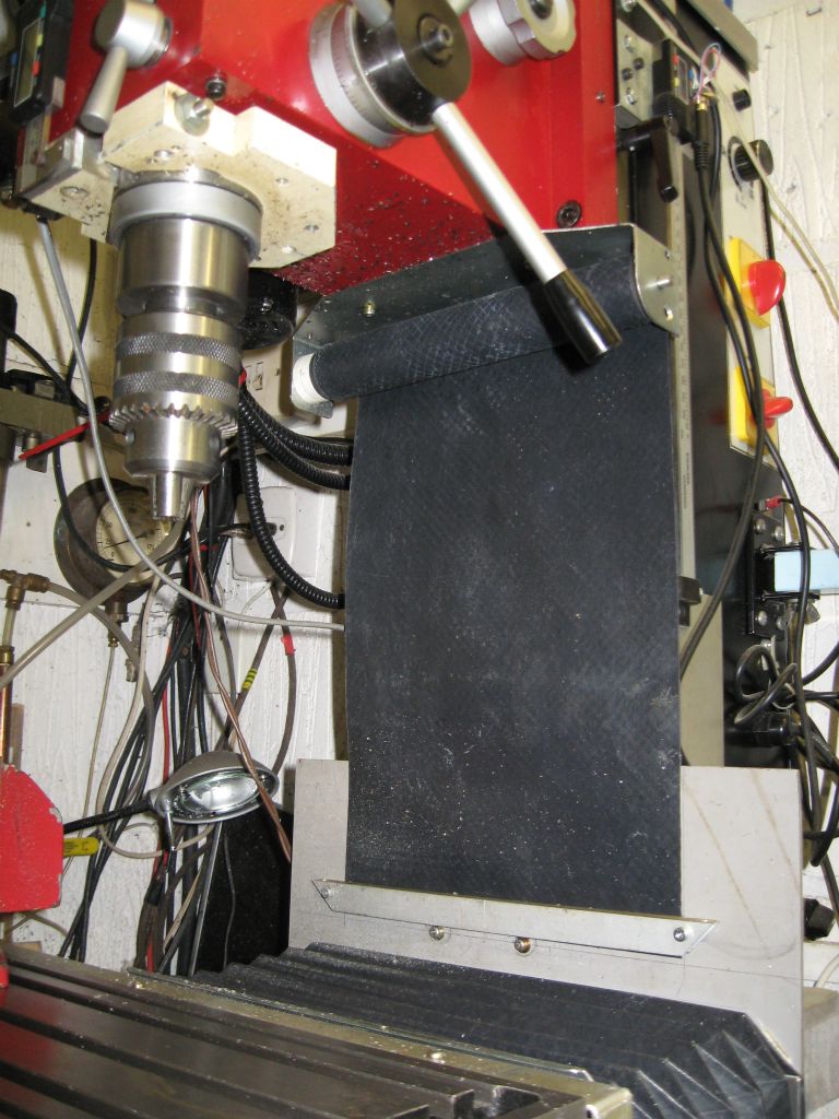

                    I made a set of bellows from some wide polythene damp proof course (Used by builders) for the Y axis of my Seig X3 mill.
                    For the Z axis I used one of the old fashioned window blinds with the pull cord. I removed the latching mechanism and shortened the roller. I replaced the original material with damp proof course polythene. (Same idea as your car window blinds.)
                    Quill clamp
                    Les.
