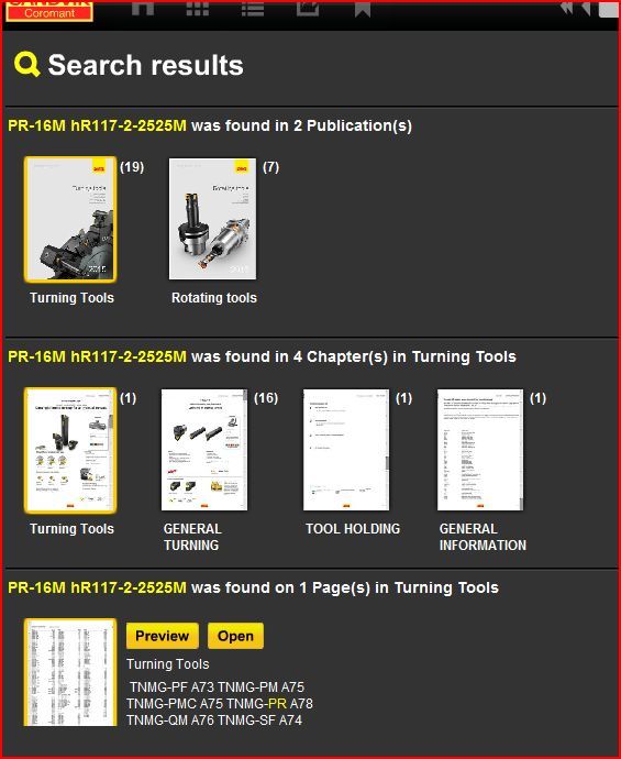

      From this and my other recent thread you might be able to tell that I am just starting to investigate buying carbide insert tools.
      For those who own carbide tooling: how do you find out what inserts to buy when the current ones wear out?
      Example here. Sandvik coromant tool on ebay. Has PR-16M hR117-2-2525M stamped on the side. Googling that only brings up the ebay item though. Do I extract a certain part of that serial number to find the insert?

          Google "Sandvik Coromant", when you get the catalogue in screen, use the search box and you will find all the detailssmiley

            No "hits". Might it be a tool thats been discontinued?
            #203742
              Comes up in 2 publications, 4 chapters, etc if you do what Kwil saysthumbs up
              Edit though looking further its only showing results for parts of teh codethumbs down
              Edited By JasonB on 09/09/2015 20:56:46

                Was it the coroguide website you used?
                #203769
                  This one, use the search box top right.
                  Probably better to e-mail them and ask what inserts it needs, hopefully not specific ones only from sanvik

                    JasonB, you're a better man than me. Doesn't matter what I paste into the search box, nothing comes up. Tried all sorts.
                    Instead of posting generic company websites and saying "just paste it in", why not paste a link to the actual search results you say you found??
                    #203833
                      Can't post a link to the results as it does not change from the one above when I get the results.
                      But this is the screenshot if I copy and past the code Rainbows gave in his first post.
                      But as I said in my Edit last night if you then follow through those results they are not actually picking up on teh complete code. Maybe KWIL had more luck?
