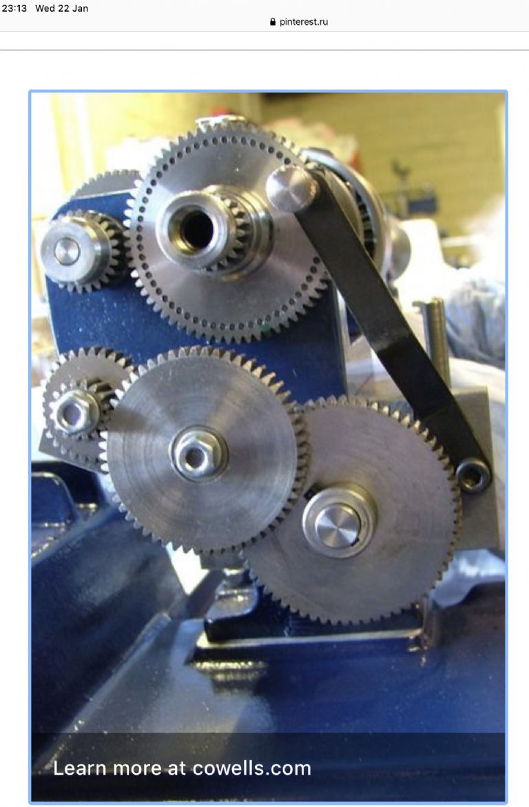

      The Cowells 90ME lathe I just purchased has a part missing from the Headstock spindle indexing unit could anyone supply a photo and dimensions as I think that making one would be a good place to start me of getting reacquainted with using a lathe.
      thanks in advance Dell

          As no-one has come forward, Derek … I’ve done the best I can
          Can’t locate this image on Cowells website, but it’s posted on pinterest dont know
          … Hopefully this is what you are looking for.
          Click the image for higher resolution.

                Hi Derek
                I've finally fought my way through to the ME90 ( currently attempting to improve access to my workshop in the hope of doing something useful ).
                The headstock indexer, as shown in Michael's post, has four components ( plus a few screws ). These are the index wheel, a machined rectangular mounting block for the detent arm , the detent arm itself which is a cranked piece of steel bar, and the detent pin which is a piece of turned and threaded rod knurled at one end and pointed at the other.
                The pin itself is either chromed or more likely stainless steel as it is bright and shiny and shows no sign of corrosion, the mounting block probably steel ( based on appearance and colour ), the arm I am not certain about – possibly spring or hardened steel.
                If you let me know what part you are missing I will see if I can produce some accurate measurements and also check any relevant screw lengths and threadforms.

                              Hi all and thanks for replies although most have to do with pixels
                              Michael Gillian & Pero
                              as you can see from my photo most of it is missing
                              Dell

                                            I have decided to purchase the parts from Cowells as it’s only £29 .
                                            and if anyone is interested I checked the price of the latest 14X1.0 shaft £129+ the dreaded.
