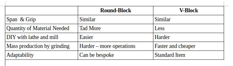

                                          Asking myself if round blocks had any advantages over v-blocks, I came up with this table.  It’s based what my books say about production grinding, the video, your comments, and Jason’s drawing – the maths are too hard for me!
                                          roundV
                                          The performance of the two types are similar.   The advantage of round blocks seems to be that they can be precisely made with a mill and lathe in an ordinary workshop, and could be bespoke to fit a particular milling table.  The level of skill needed is moot – doesn’t seem that advanced to me, but much depends on the required precision.
                                          Best to put figures on precision and accuracy, so we’re all on the same page.  Using rough methods I often knock up parts that only need to be within 0.1mm, and though that keeps me happy, it’s not always acceptable!  So instead of allowing speculation about what I mean by accuracy here,  all dimensions and parallels must be ±0.005mm, a requirement that disqualifies rough blocks satisfactory for ordinary work-holding.
                                          How easy are blocks to make?  I have several DIY V-blocks, all approximately milled within near my usual ±0.02mm range.  I can certainly stretch to ±0.01mm, and might get  ±0.005mm at the cost of several rejects!  Therefore, I suggest precision V-Blocks are significantly harder to make in a basic workshop than precision round blocks.   Opposite is true in a factory where accurate V-Blocks are easily made by grinding.  And in a factory many economies are possible, for example by using stock with a pre-rolled V, or roughing out with a big horizontal mill.  Mass-production by grinding is quick and cheap and  fundamentally more accurate than turning or milling.  In contrast, round blocks require more operations, so I guess they’d be a shade more expensive to mass-produce, to no particular advantage.
                                          So I buy off-the-shelf commercial v-blocks and mill bigger home-made V’s as necessary, ‘good enough’ rather than accurate. A caveat: though I work with pipe, it’s usually bendy plastic, not metal, so accuracy is limited by the material.  So I won’t rush to make any round blocks – unless there’s a need, they’re a waste of time.  But if I need to accurately mill a 4″ metal pipe, I shall remember they’re an option.
                                          Of course my analysis could be wrong, or inappropriate to your needs.  Perhaps I’ve missed something!  Anyone decided to make a set of round blocks?  If so, what for?

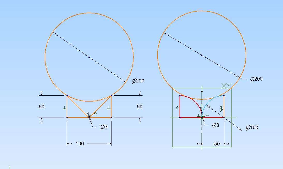

                                              #819343
                                                On John Haine Said:
                                                One benefit of circular by the look of them is that they look as if they can accommodate round stock much bigger than an equivalently sized standard vee.
                                                My image would tend to show there is no difference in what either can accomodate, Vee supports over a wider distance so a bit more stable. Round are probably a bit kinder to holding softer of finished materails
                                                And my Vee blocks do get used fairly often
