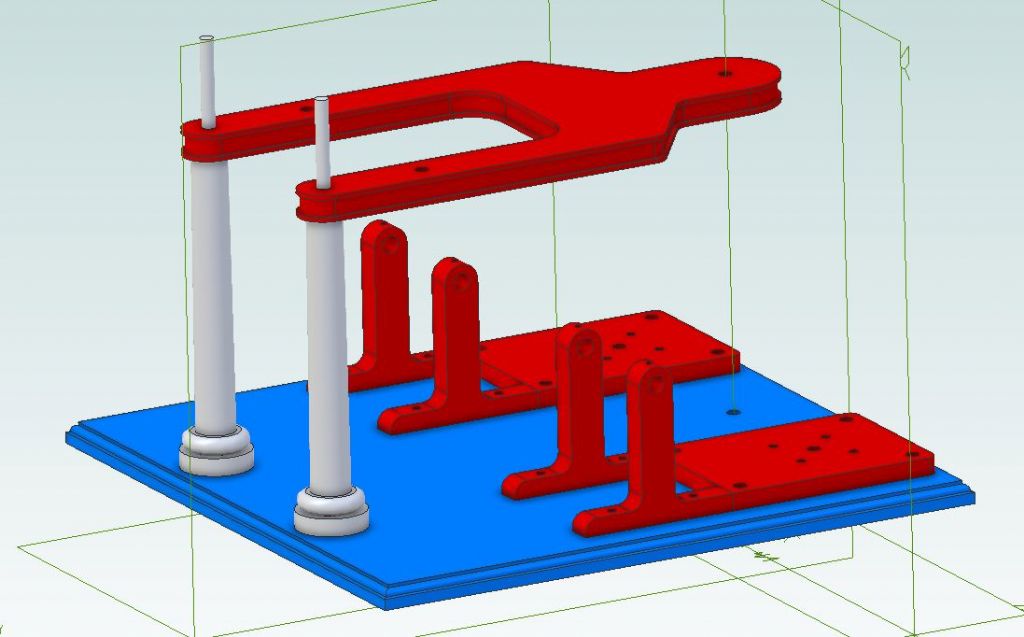

            #448545
              I don't know if there will be any more errors as I only went through the parts covered in the first couple of installments but hopefully there won't be more. Since publication started the sketches have been posted on another site so you could make use of those if you want to get on.
              It is also an engine that you could add some more features to to get it looking a bit less like a barstock engine if you wanted such as adding some taper to the columns and detail around the plates, I did not get too far into it. Could even make it a cross compound.
              Also it should really be called a double side rod engine rather than double beam, maybe I should start a thread asking for a clear definition between a beam engine and a side rod engine.
