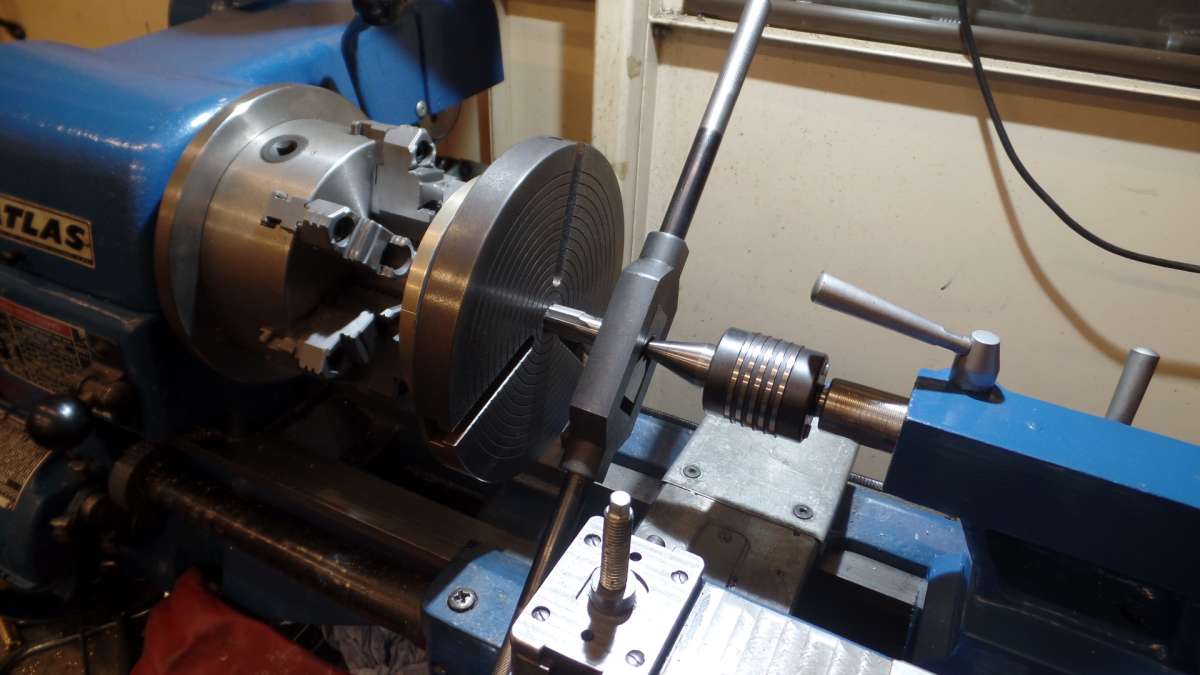

                                    I don’t know how big a Unimat 3 lathe is, but I used this method to ream a MT2 hole in an 8″ rotary table top. The lathe is an Atlas 12 x 24.
                                    As already mentioned, your bore would be better just finished by boring.
