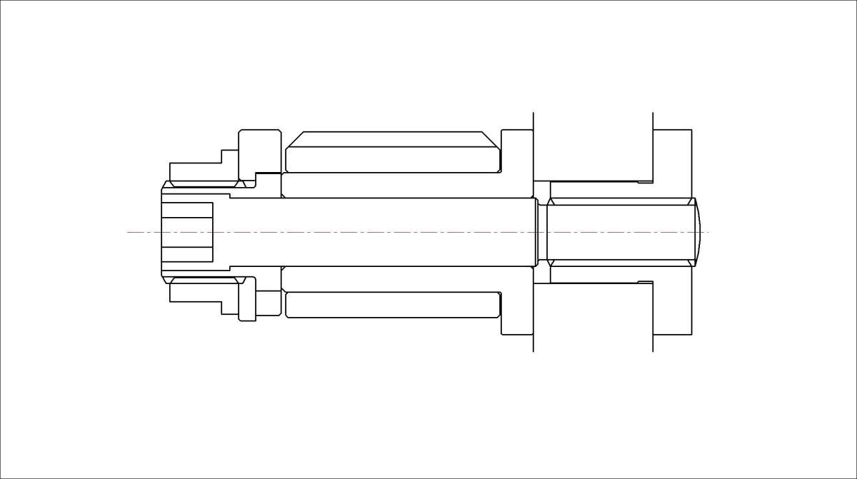

                  There is part of a changewheel stud mod I am trying out sitting in the lathe chuck right now. The trouble with the Myford S7 arrangement is that when you undo the nut the whole lot of seven parts comes apart in your hand, well mostly, I often also get bits in the swarf tray or rolling under the bench. I want the stud and the oilite sleeve to stay put while the gears were removed.
                  I have made one trial where the stud is replaced by a cap-head and a separate tee-nut in the banjo. The head of the cap head is turned down and then sleeved. The sleeve is externally threaded and shouldered for a nut and C-washer.
                  Changewheel Stud
                  This is OK, but removing the C-washer only allows me to pull the gears off the keyed sleeve, which is retained by the nut. Putting them on again is a pain because the sleeve is inaccessible and wants to rotate, so it is difficult to line up the keyway in the gear. I only found this out when I tried it.
                  The next effort, a work in progress, replaces the nut and C-washer with a one-piece flanged nut. The nut will need to be removed to take the gears off complete with the sleeve, but the stud and oilite bush will stay put.
                  I won’t really know if I like the arrangement until I have tried it for a few months.

                                                Not sure I understand this description, Howard. Where is the nut? Behind the banjo, or between the gears and the banjo, or something else? If behind, it would not work on a Super-7 where the back of the banjo is made hopelessly inaccessible by the dished guard backplate.

                                                  Tee nut on the back of the banjo and you don’t need to get a spanner too them, Chinese do it that way.
                                                  Here you go video of the retainers on my Warco. Forgot to show that a 10mm spanner fits the square end and is all you need to move the studs. Gears slip onto a bush with integral key locking the pairs together.

                                                  Howard Lewis
                                                    @howardlewis46836
                                                    Charles,
                                                    The stud has flats which prevent it rotating within the banjo, the threaded extension carries a washer and nut (On the other side of the banjo). When the nut is tightened, the stud is clamped in position on the banjo (Once the gear meshes have been set).
                                                    The outer end of the stud can be tapped to take a screw , setscrew, or capscrew with a washer to retain the gear on the stud. Or it could carry another external thread for a nut and washer.
                                                    No big deal, just a simple arrangement!
                                                    To help a newbie, I made a stud so that a second compound idler could be used, to produce a fine feed for finishing, on his elderly lathe.
                                                    Certainly worked that way on my ML7, so seems unlikely that subsequent models would make it impossible.
                                                    Works that way on my later oriental lathe, and on my mini lathe when I had it
                                                    People have been using this sort of arrangement for changewheels for 90 or more years, so it can’t be that difficult!
