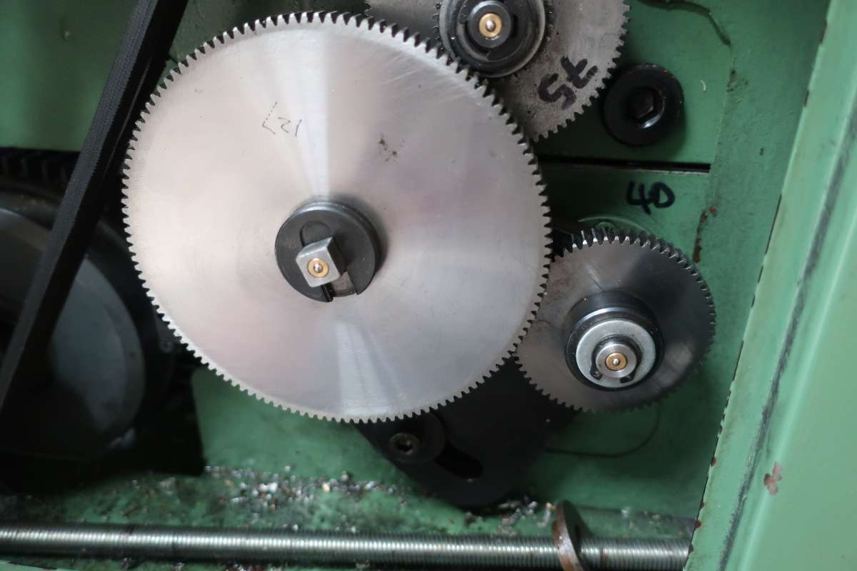

Maybe QC a little patchy, the ones on my lathe are fine and even the oilers still looking good..

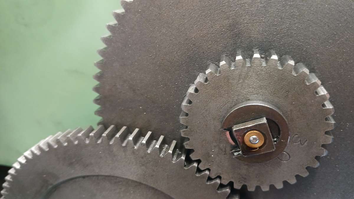

Close up photo of the c washer in place

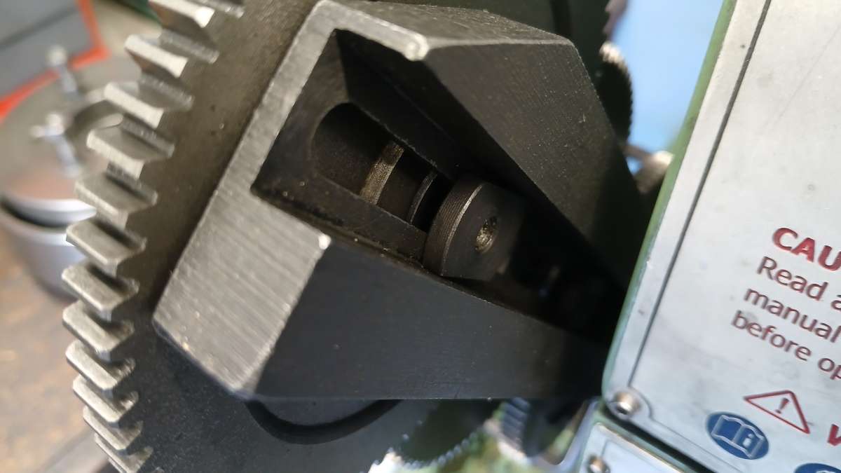

Tee type nut arrangement for Charles

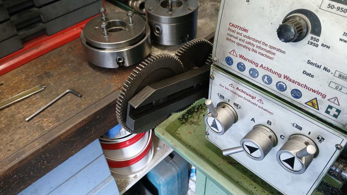

Or the banjo just pivots at the bottom so you can swing it out and get access to both sides
Thanks for the video. The C clips look a good method and having a square on the end of the shaft for adjusting position would make it a lot easier on some lathes. However these things do probably mean starting from scratch with the studs.
