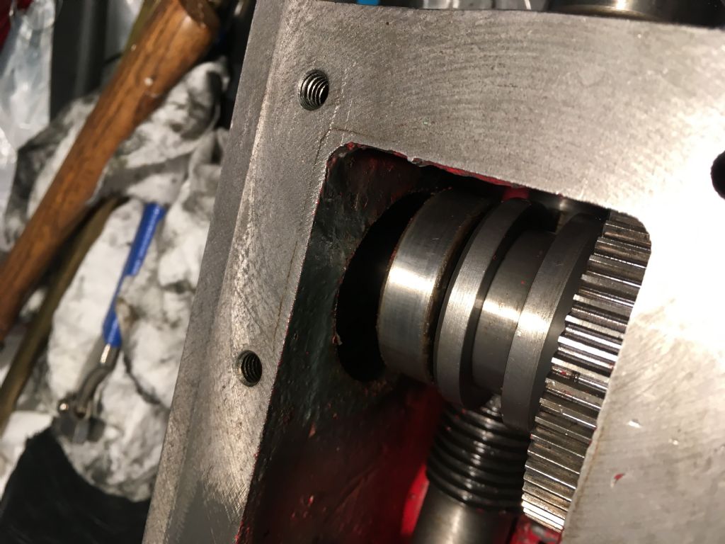

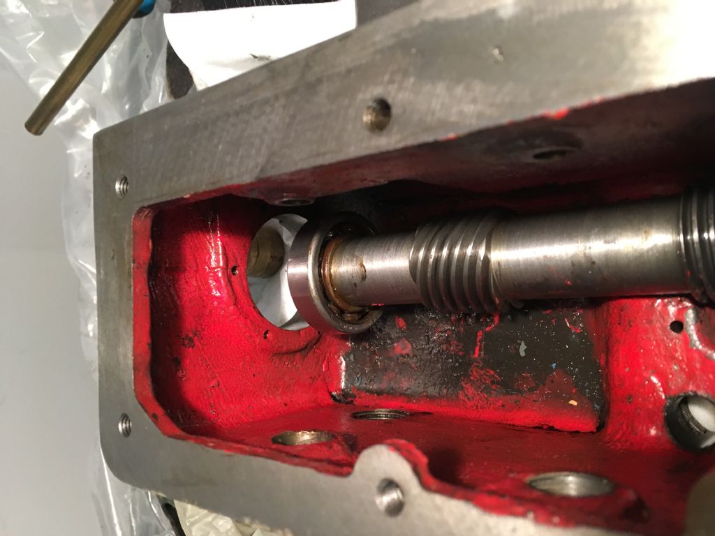

      Hello! I tried searching the forum on this subject but came up short.
      I'm continuing the taking apart of my Habegger DLZTE screw cutting lathe and I've gotten as far as the apron. All the mechanics in the lathe so far seem to be in a fair conditions but cosmetically it's terrible with a lot of painted over screws and joints between parts.

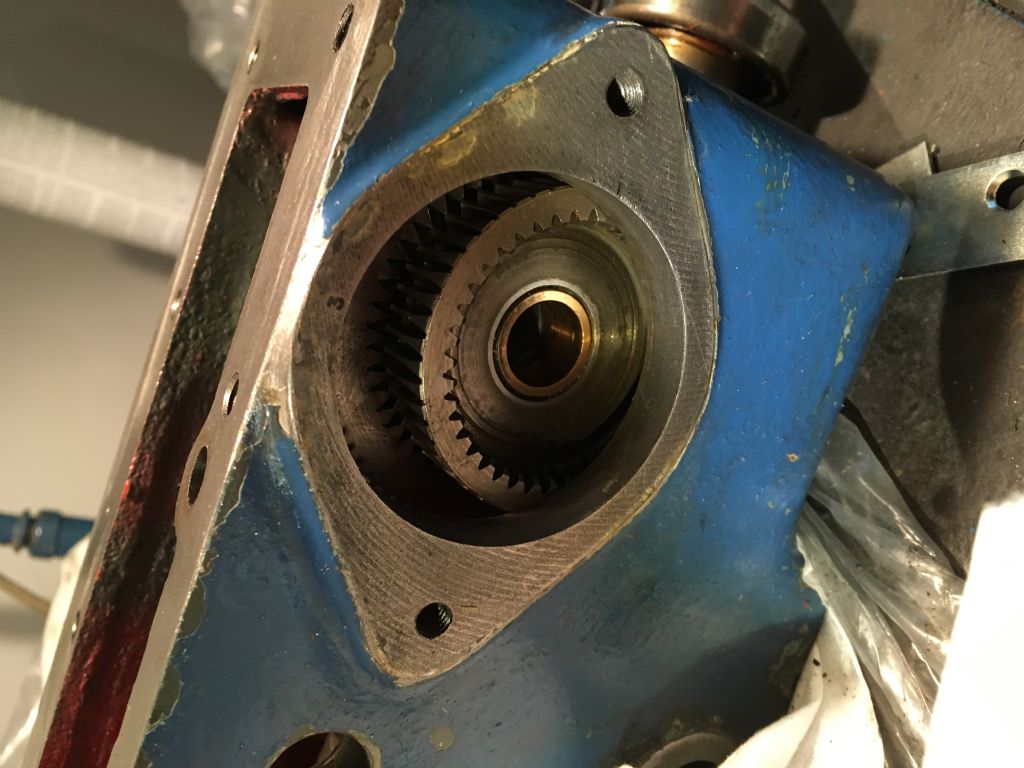

      The latest problem with the apron is getting the gear stacks out. I'm stuck with the gears directly behind the hand wheel. And without getting that gear off of there, I can't get the driving rod for the feeds out.

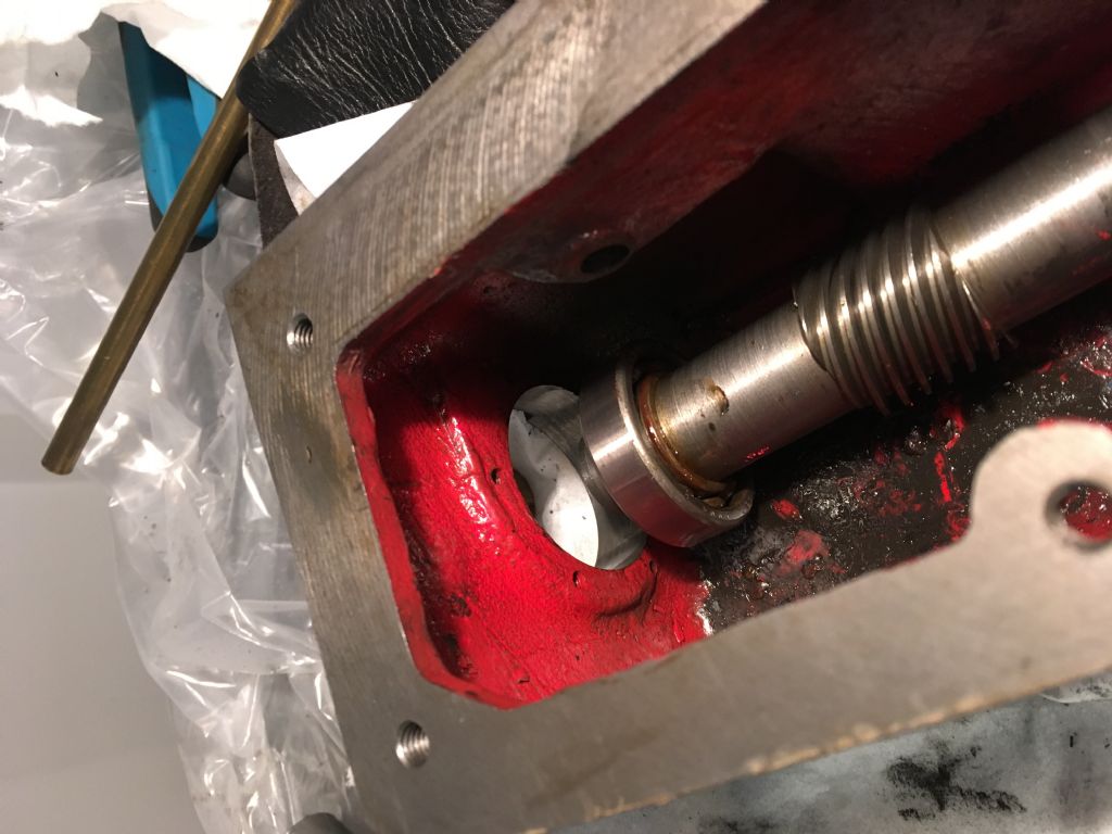

      Almost all rotary, manual functions on this lathe have ball bearings and they are rather snugly fitted into the castings. I can either push them out by hand or the come loose with just a little amount of tapping with a plastic shaft. They are however rock solid on their respective arbors. Probably a press fit. Several of the components feature captive gears or captive designs where it appears to me that I need to get the bearing off of the arbor in order to disassemble correctly. I can't see how I could get a tool into any of these situations though, without running the risk of damaging things.

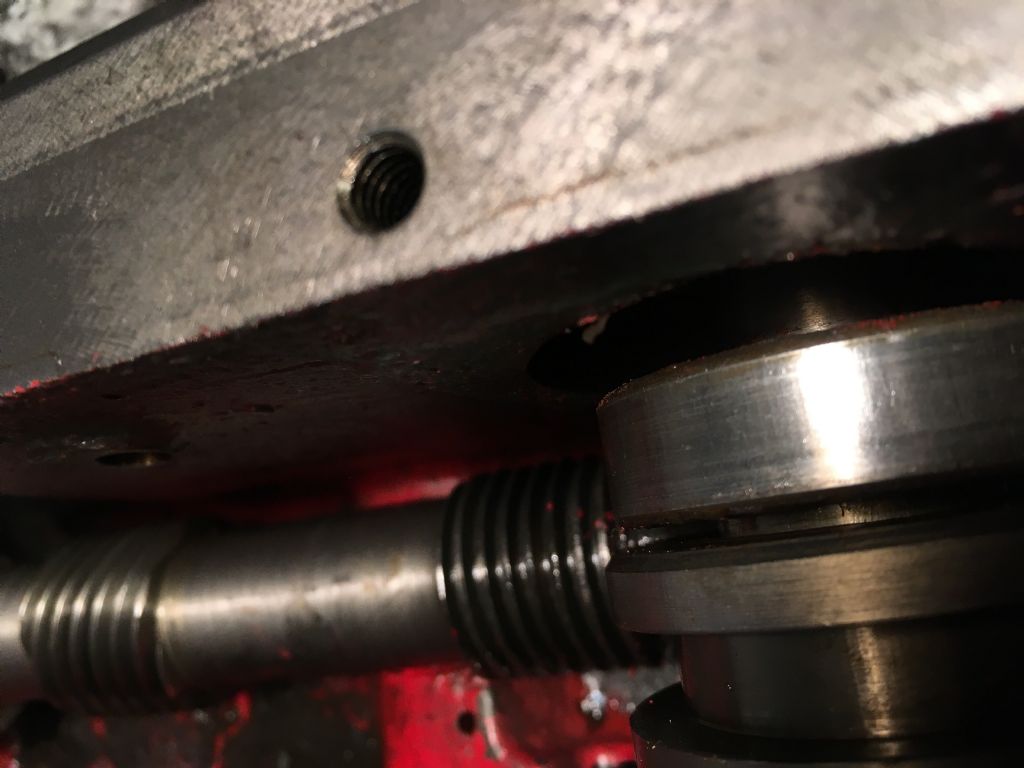

      As is the case in my attached photos, the middle wheel is captive between the first and the bearing. The first, smaller wheel will pass through the hole in the casting in the front of the apron but not with the captive gear trailing it.
      I've tried placing a plastic spacer between the captive gear and the casting and tapping the spindle out with a brass rod but it won't budge. Is this supposed to be set up in a press in order to be disassembled or am I missing something. It seems impractical from a service point of view. I think the feed rod will come out with the bearings still attached as the holes in the castings are through holes, but the bearings won't clear the gear stack that is causing the problem. I've tried shimmying it out of there but no luck.
      All help is appreciated!
      Best regards
      Karl

                The images are unclear, but if there is a bearing at each end can the bearings be removed? If so you may have waggle room to shift the shaft through the bearing housing. Maybe on reassembly the bearings are then inserted on to the shaft when the shaft is back in place? The original bearings may be sacrificial but the skew gears look as though the are an integral part of the shaft. Robert Butler

                    Unclear how? That they don't show the whole shaft?
                    There is a bearing on either end of the drive shaft. I've managed to wriggle that past the gear stack that is left now, and as I suspected the bearing on the other end cleared the housing. Yes, the teeth on the shaft are machined directly into it.
                    The part that remains now is the hand wheel assembly. Still not enough room to persuade that one out of there.

                      It looks like you have moved the shaft to one side already and one of the bearings is outisde the casting. Can you place a couple of soft bars between the bearing and the casting and gently tap the shaft inward?

                        Thank you for the suggestion, Ed! I tried that and they wouldn't budge. The drive shaft is out now though. I think I can clean and re-pack the bearings adequately now. The only remaining part is the handwheel assembly and the bearing there.

                          They are handwheel bearings. Totally non-critical. It is not worth risking cracking the apron casting by putting strips behind them and pounding on things with an 'ammer and drift, thus transferring the shock loading to the casting.
                          You'd be better off to soak and wash out the whole apron in solvent in a proper parts cleaner or even just a large bucket etc, without disassembly. Surely the oil level in the apron will be high enough to lubricate these very low speed, very low load bearings when reassembled? Or if not, you could squirt a bit of grease into them using a grease gun with syringe fitting on the end etc. Or even heat some grease up and pour it into the bearings, if you find that grease packing is essential. Grease can be heated in an old tin can on the stove or with a torch etc.
                          If you feel you absolutely must remove the bearings, you might try heating them with a propane torch to expand the inner race until you can slide it off the shaft. That way you won't destroy the bearings as using a hammer and drift often does.
                          Personally, I'd leave well alone and go with the solvent clean up and possible regrease if the apron oil level sits below the bearings.

                              Hi Karl, like has been said, wash them out in as best you can, the best way is in a paraffin bath and a good quality paint brush (one that doesn't loose all its hairs) and then blow dry them with clean compressed air. The bearings will be a press fit on their journals and a close fit in the housings, this is standard design.
                              Contrary to belief, you should not use a brass drift near ball bearings, (or any bearings with rolling elements) as brass has a tendency to splinter off very fine particles, which you won't notice and will damage the bearings when in use. If you need to use a drift, use a mild steel one or a mild steel one with a short pure aluminium plug in the end, both will mushroom long before bits splinter off them.
