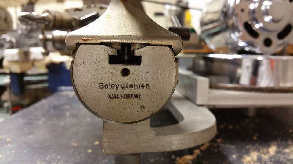

                Henry Rancourt
                  @henryrancourt22682

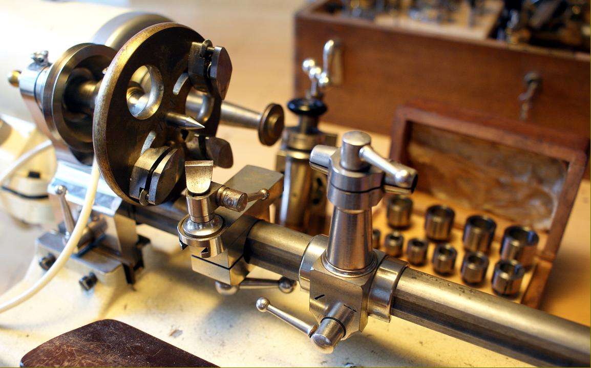

                  You should got to http://www.lathes.co.uk/ and do a search for watchmakers lathe bed styles. Scroll down to the 5th or 6th image and it shows what a WW lathe bed looks like. It is just like the one the video in the post above and just like my Boley Leinen WW 8mm lathe in the photo.DSC00730Boley Leinen10(20230627_120953)
                  #833912
                  Henry Rancourt
                    @henryrancourt22682
                    this is image from http://www.lathes.co.uk WW lathe bed
                    #833929
                      Apologies … I evidently mis-understood your opening post.
                      #833930
                      Henry Rancourt
                        @henryrancourt22682
                        Just for clarification attached are photos of Geneva and WW pattern lathes.geneva patternWW pattern

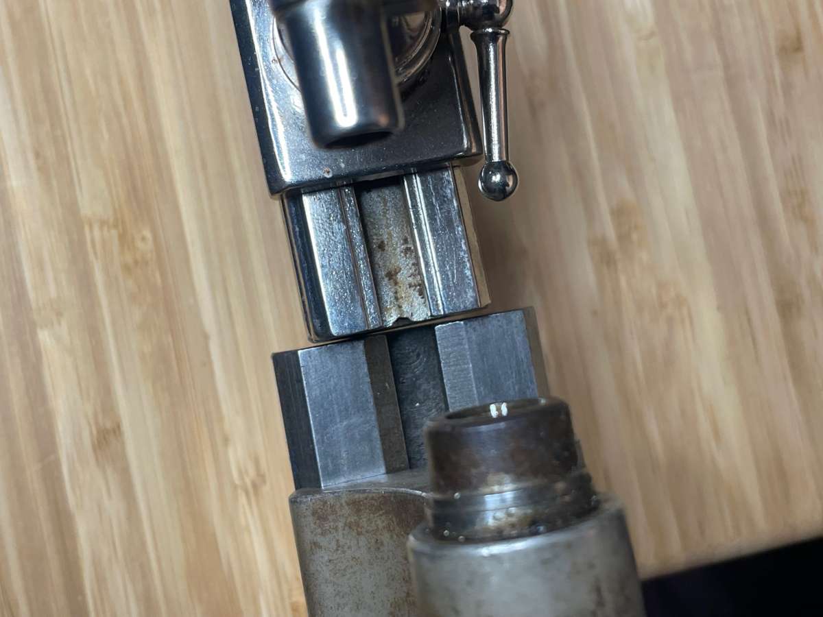

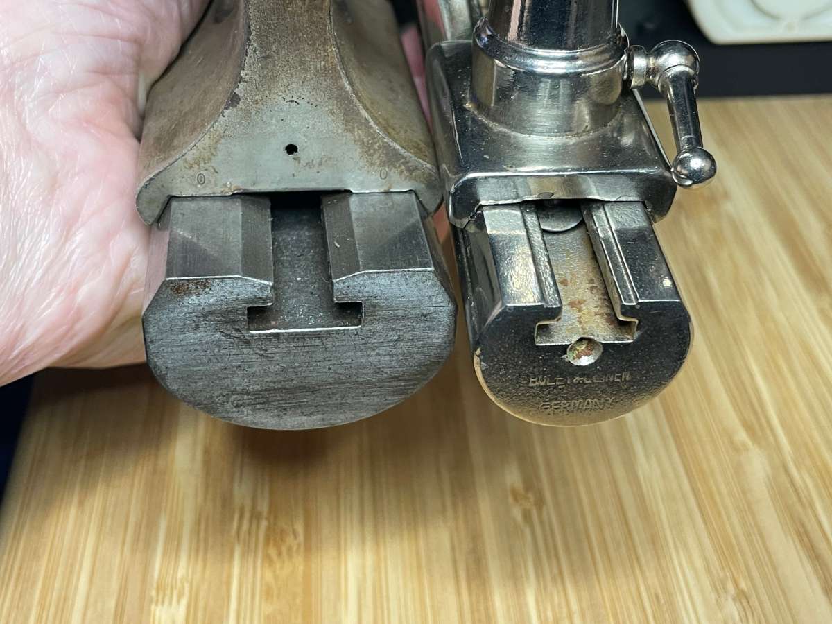

                          rjenkinsgb
                            @rjenkinsgb

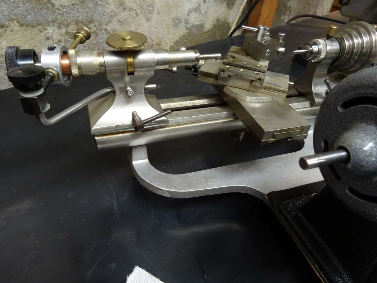

                            The Reform uses a visually similar profile bed to the WW, but scaled to around 2/3 the size at 30mm wide.
                            Both use the outer bevels for alignment, with clamping via the middle slot.
                            The two side by side:
                            IMG_6403IMG_6404

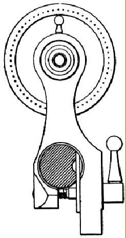

                              Henry Rancourt
                                @henryrancourt22682

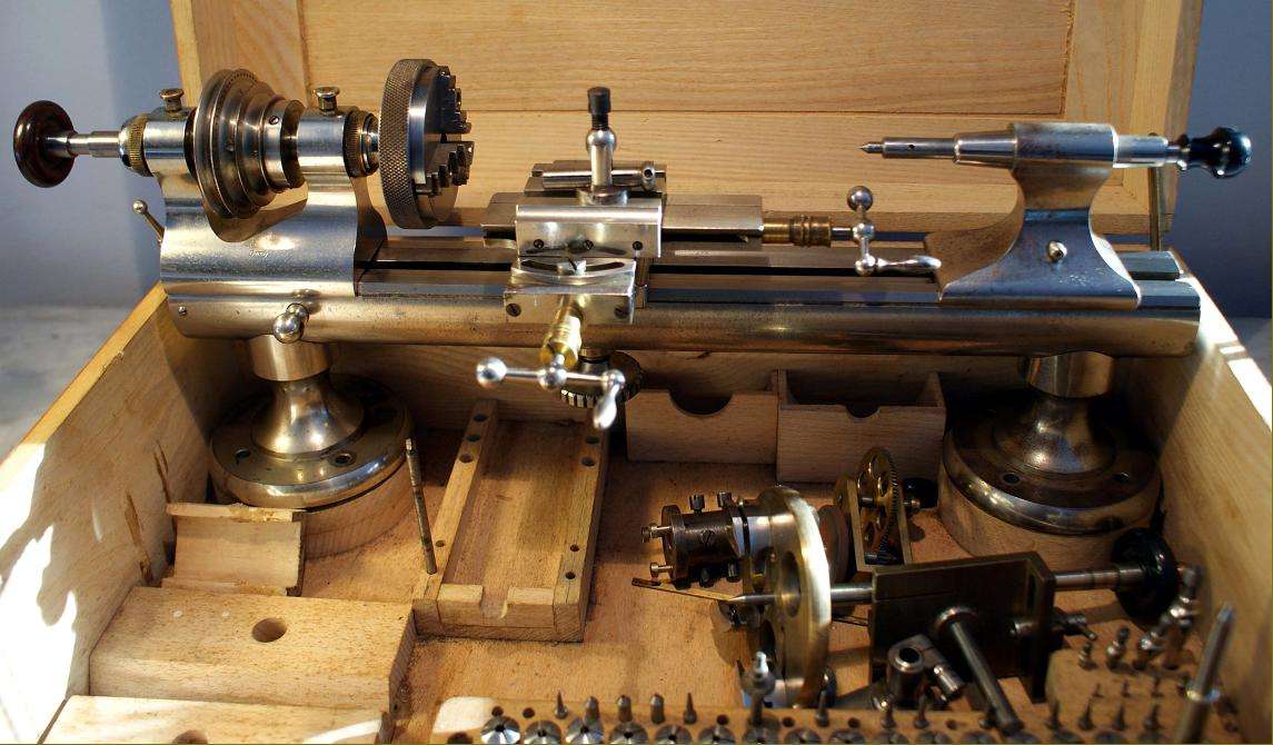

                                The Geneva bed was sometimes called a D bed because it was round with just a flat surface, usually as the side surface, but  I’ve seen some images showing the flat as the top surface.
                                Geneva bedgeneva pattern

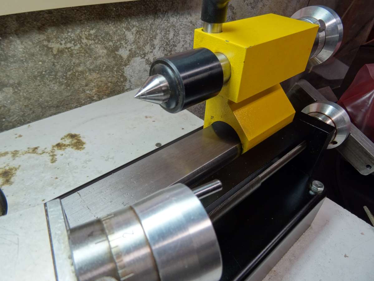

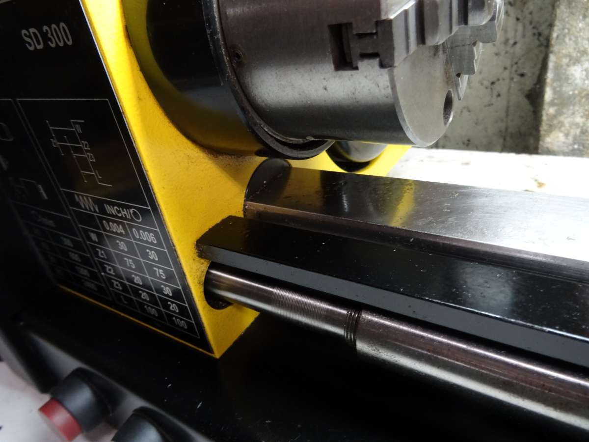

                                Henry Rancourt
                                  @henryrancourt22682

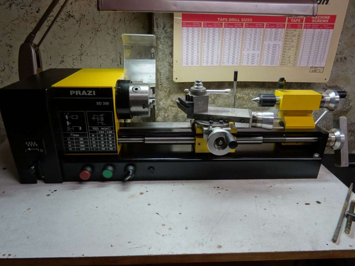

                                  So, thinking that Geneva style beds are a thing from the past, I just realized that my Prazi SD300 has a Geneva style bed.
                                  DSC00761DSC00762DSC00763DSC00765
