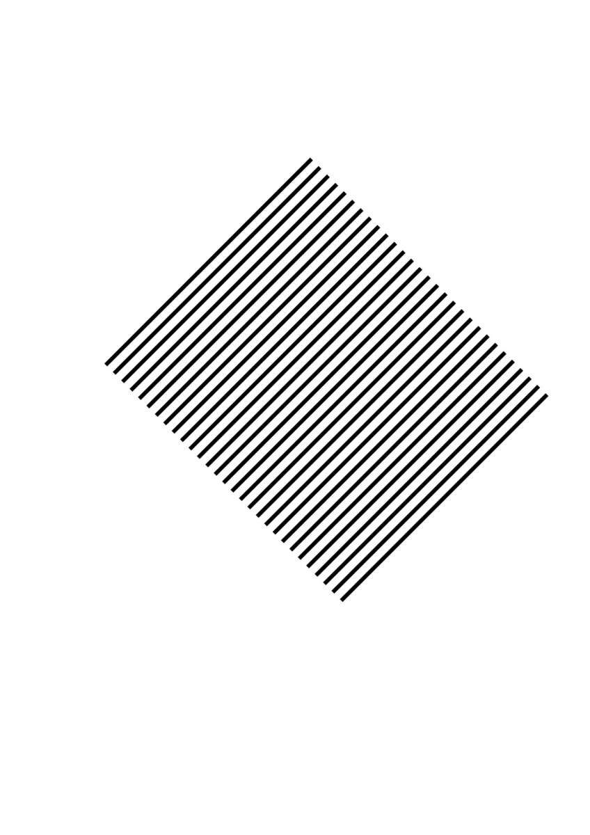

        Speedy Builder5
          @speedybuilder5
          I use a bit of this behind the gauge glass on a 1/4″ od glass.
          Hatched Background.1
