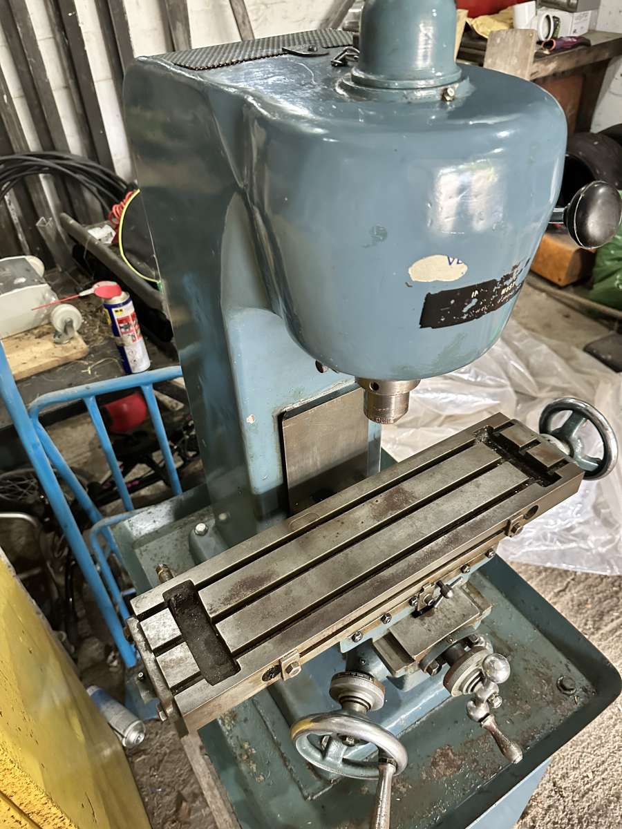

      Hi guys
      i’m looking for information around this milling machine, my late father bought it to take up some model engineering in his retirement but unfortunately passed away before he got any use out of it. It all works and is a three phase machine connected up with capacitors to make it run in single phase.
      its down to me to clear out his barn and but I don’t know what this is worth at all? I can’t find another one for sale anywhere
      does anyone know what I should put this up for?
      thanks guys
      owen
      IMG_0821IMG_0832IMG_0830

        The last few to sell on ebay made around £500.
        HOWEVER, just a couple of years ago these used to sell for £1000+ quite regularly. I don’t know why they have dropped so much.

              Thanks for the reply guys, I think the value is that it’s a compact machine but very heavy duty for the size!
              Good to hear a few prices, they were more expensive a few years ago due to covid probably, with more people at home with time to spare for hobbies!

                There’s was one for sale nearby (in Lincoln) on Facebook marketplace recently for £650 looked to be in around the same good condition with a small vice and some other tooling, It disappeared quite quickly so presumably sold somewhere around that value.
