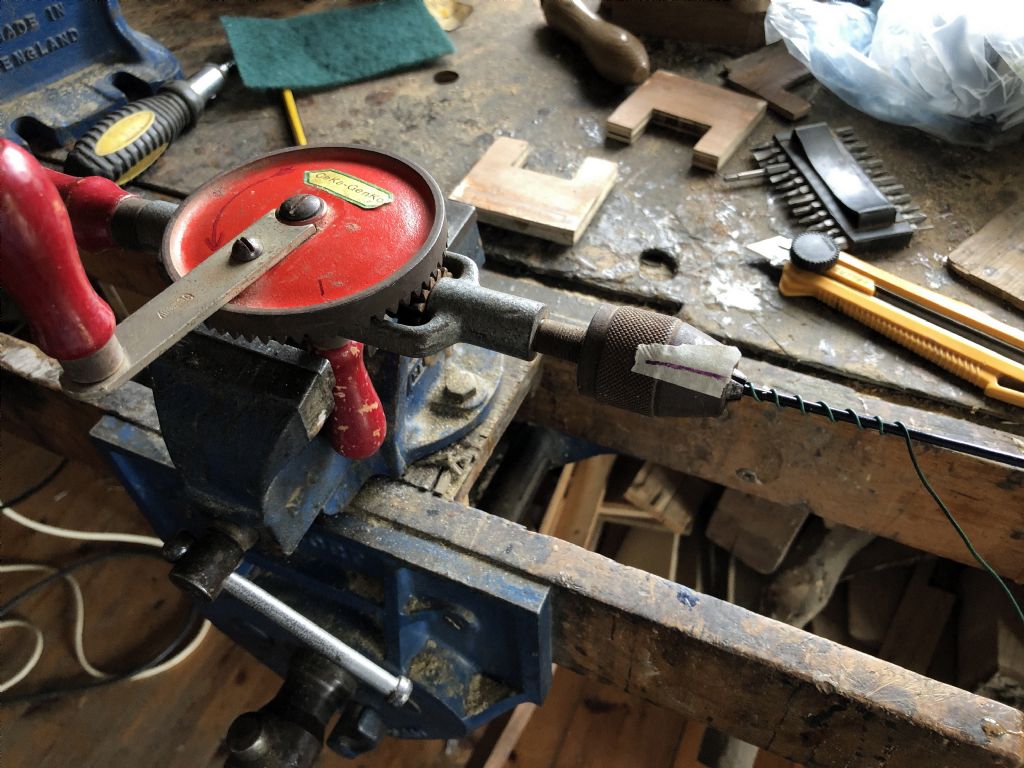

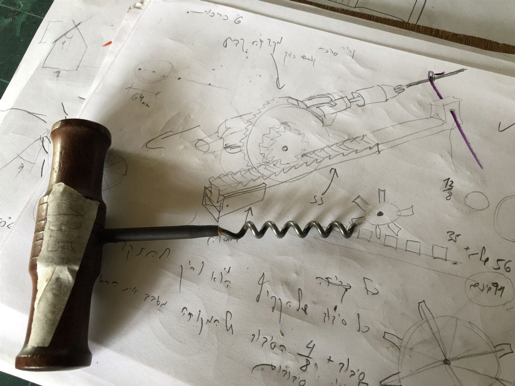

                                Ronen Burstein
                                  @ronenburstein68061
                                  Hi everybody
                                  Thanks so much for your reply, much appreciated.
                                  I think I miss lead you somewhat. What I need is that:
                                  I need to make a six revolution cork screw from 3mm music wire with 2.5mm inside diameter. It is for making rustic wine cork screw opener.
                                  The Idea is attaching 2.5mm rod to hand drill and bends the wire around it six times. Now I have found that if I turn the drill handle 13/8 of revolution it will revolve the drill head six times. The trick is to advancing the wire while it revolves around the 2.5mm fixed rod, in steady travel distance. The pitch of the screw that I need is 9mm.
                                  So I thought that I need to attach a pinion & rack mechanism to the drill and the rack will push the music wire in constant travel speed to give me the pitch I need.
                                  I don’t know how to calculate the dimension of the P&R that revolves by the motion of the drill, so it will travel in the speed I needed.
                                  Ideally I would like to make it on my lathe but too old to do the gears train calculation to give me screw / spring of 9mm pitch with 3mm wire and 2.5mm inside diameter.
                                  Attached two photos that might help to understand what I am up to, the primitive way.
                                  Thanks
                                  Ronen
                                  #505812
                                  Brian Wood
                                    @brianwood45127
                                    Ronen,
                                    A simple solution is often the best. This I think will do what you want.
                                    Wind a tight coil on your drill, don't worry about the spacing. Put on at least six turns, a few more won't matter. Then stretch the coil you have made to give you the pitch you are seeking.
                                    Regards Brian

                                      Martin Connelly
                                        @martinconnelly55370
                                        As Brian said, keep it simple. It will just need a slightly larger diameter rod than the Ø2.5mm of the finished corkscrew.
                                        Martin C

                                          Brian Wood
                                            @brianwood45127
                                            Hello again Ronen,
                                            3 mm diameter music wire is pretty tough to bend anyway but might I suggest you wind the coil using a square bar with a 3.2 mm hole through it held in the lathe toolpost so that you can tension the wind, running the wire through a very hot flame immediately after the tool to get the wire red hot as you wind it on.
                                            If you have a hand winding handle in the headstock spindle you can control the pace of operations and set up gearing as in screwcutting to give you a tight coil to keep the coils together
                                            That way you can make a tight coil and then stretch it after winding to obtain your 9 mm pitch.
                                            Regards Brian
