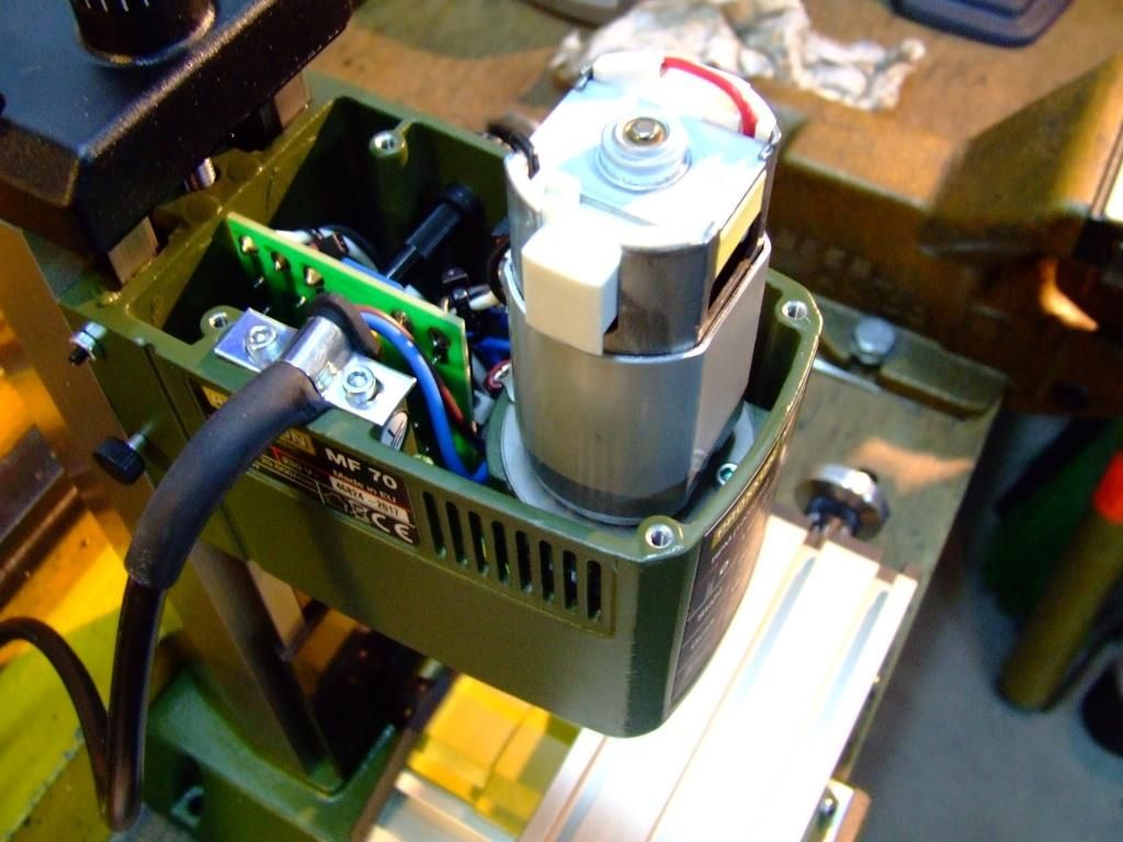

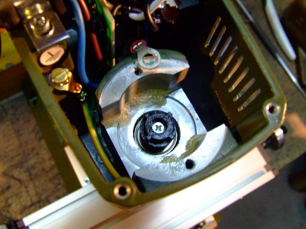

                    There appears to have been at least 3 different designs of coupling used. I found this company when looking to upgrade my MF70 to ER 11 collets. I decided that the price was a bit high and instead I may purchase a plain shank ER11 chuck and machine the top to take the Proxxon coupling.
                    **LINK**
                    What is your coupling like? This is mine:
                    #510282

                        Michael, Your eyes are far better than my old ones!
                        It looks as if a hybrid coupling to match motor to machine is going to be the method used.
                        Perhaps the "soft" coupling, if it is not just a low cost method, may be to lower the natural frequency of the system. But, being a cynic, suspect the former, or a ready source of aftermarket spares sales!.
