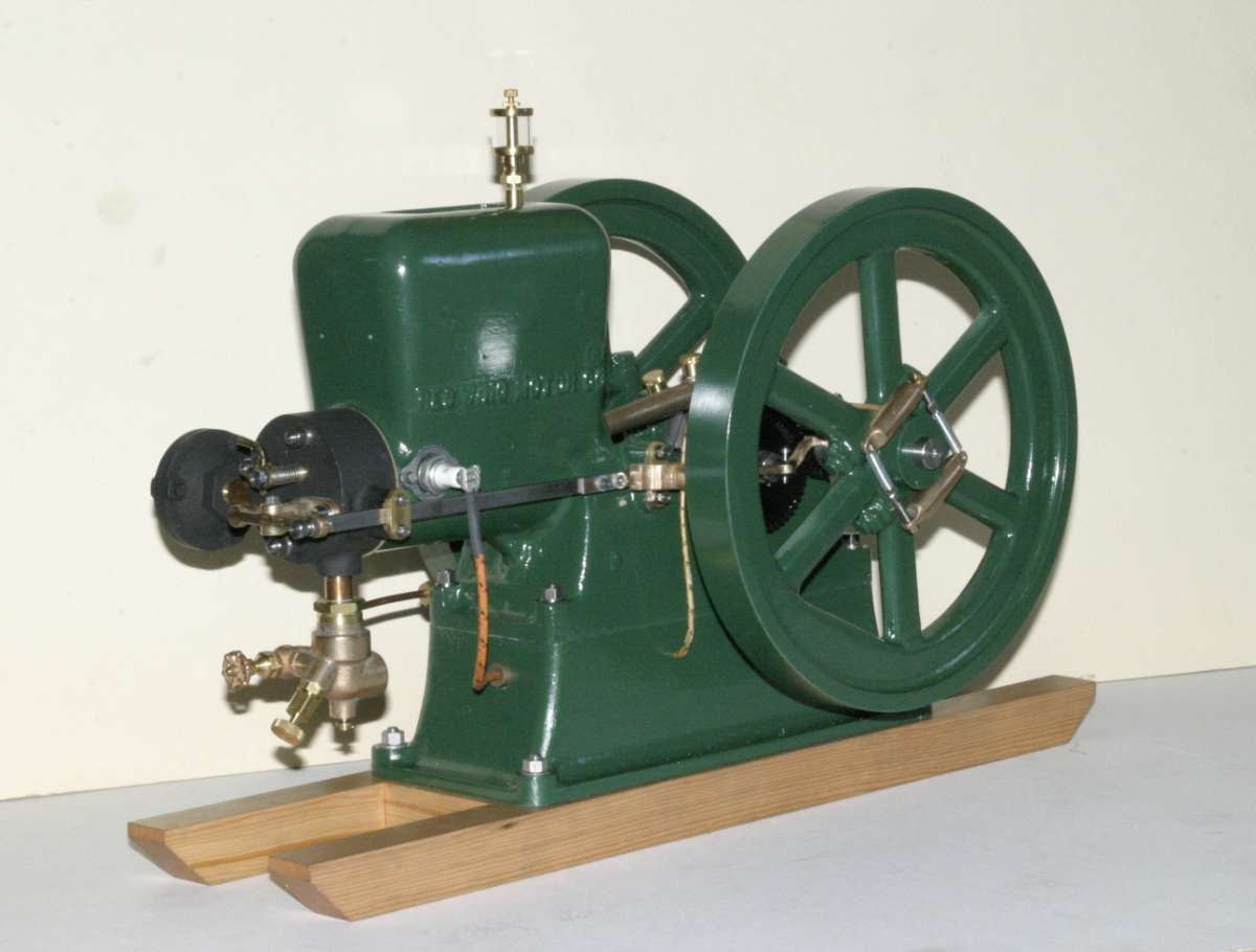

      Finally got to try and run my Red Wing, only finished it in Oct ’21. When I finished it I was waiting for a hip transplant, and as it weighs about 40 lbs I didn’t feel confident to carry it outside safely. Got the hip done last Dec so figured it was time to see if it would run.
      After about 10 minutes of only the odd pop I decided that it must be flooding even though the mixer needle was only open 3/4 turn, so closed it and after turning it over a few times it fired and ran for a few seconds till the fuel in the cylinder ran out. Started then to open the needle out a bit at a time and found it would start and run reliably with it open only 1/4 turn. It now starts every time with just a flip of the flywheel over compression.
      Here’s a video of it running, I hope, my first attempt at uploading a video to You Tube so excuse to quality.
      #863918
        That’s running well, I have found that the Lunkenheimer type carbs only need the needle opening a crack
        #863921
        renardiere7
          @renardiere7
          That’s a cracker. I didn’t realise how big these engines are, quite a substantial model.
          #863934
          Andrew Crow
            @andrewcrow91475
            Always good to see one of those running well, nicely made John.
            Andy

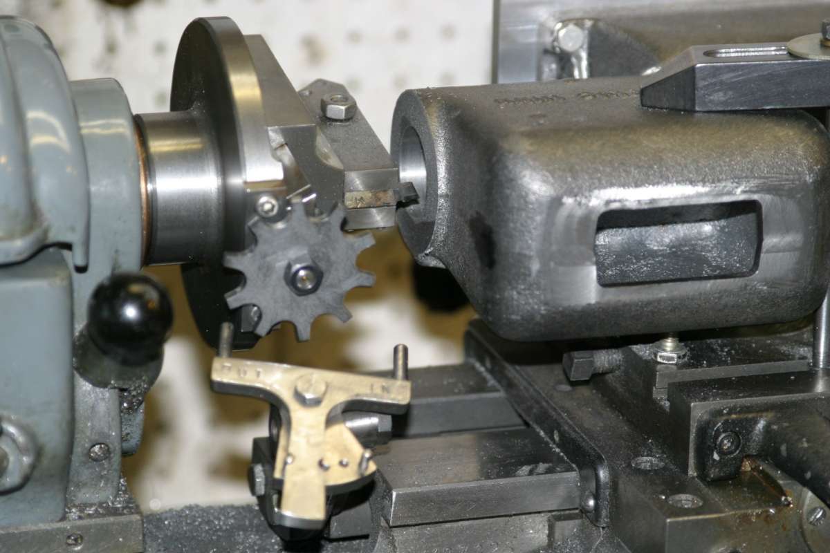

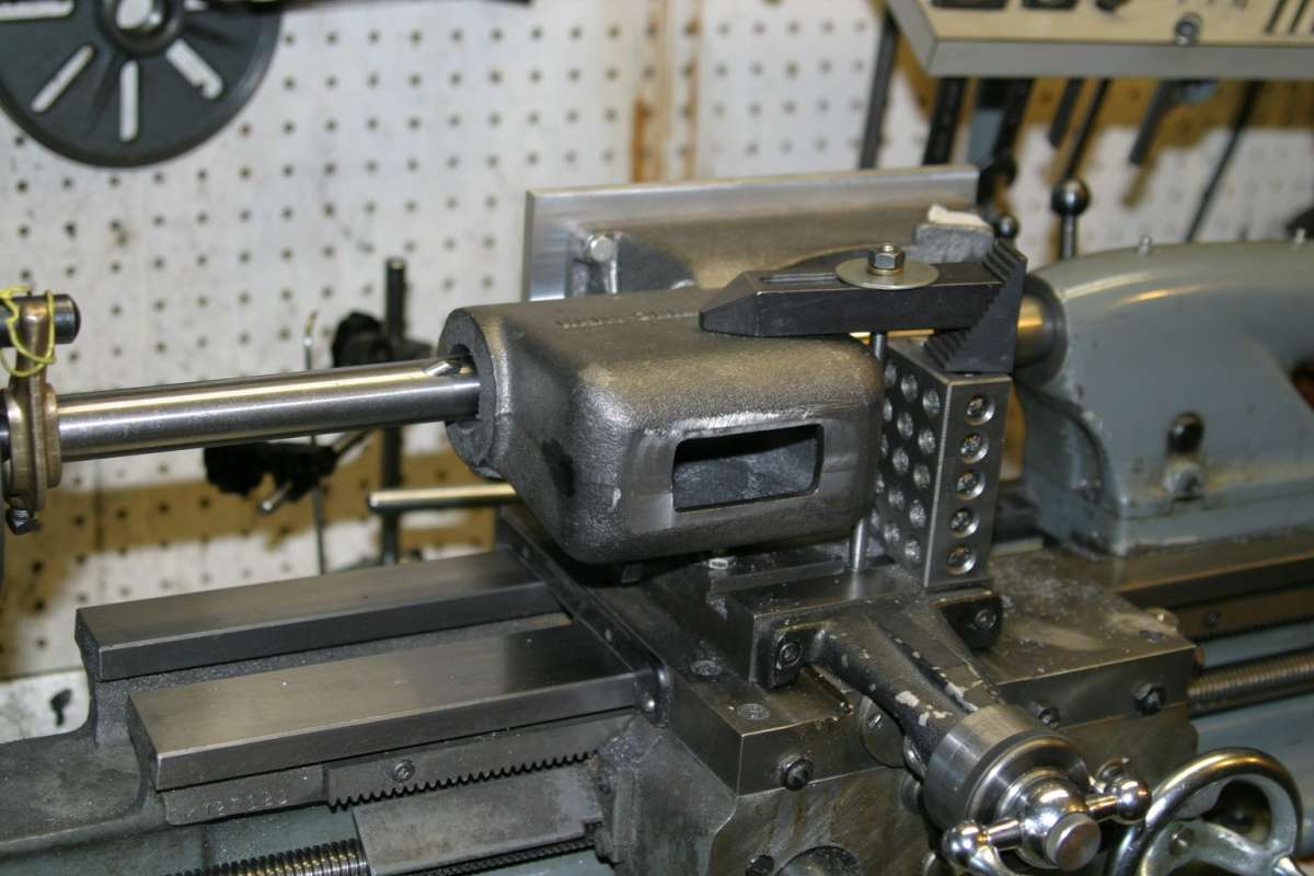

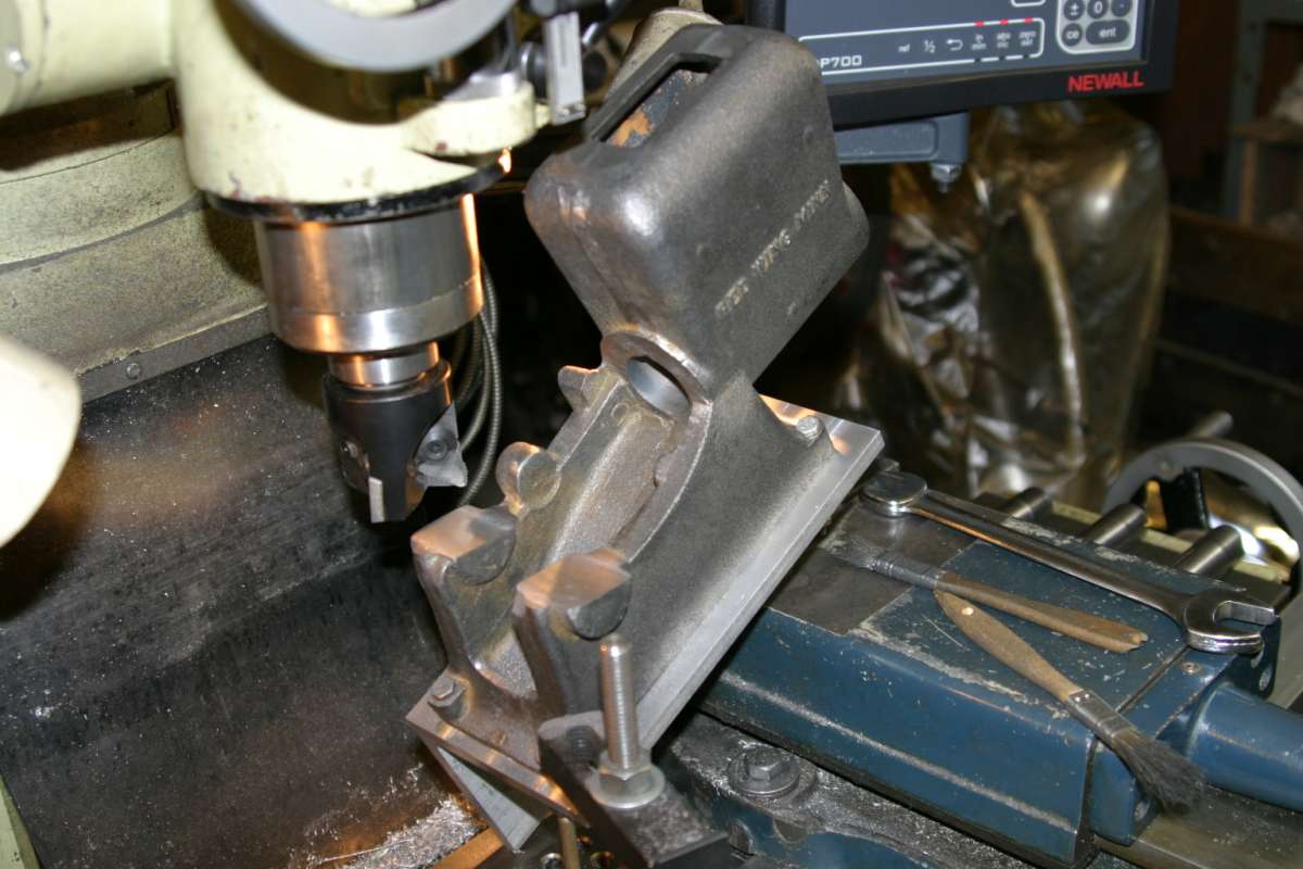

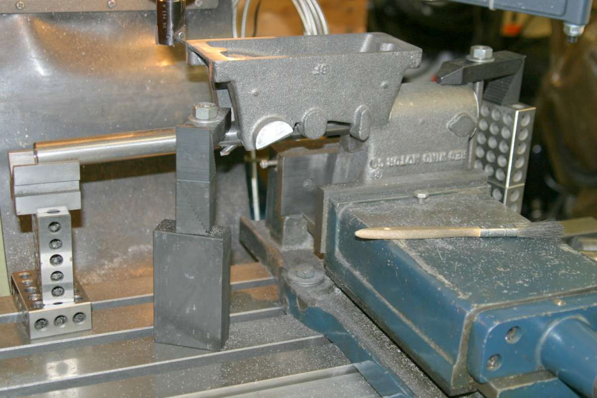

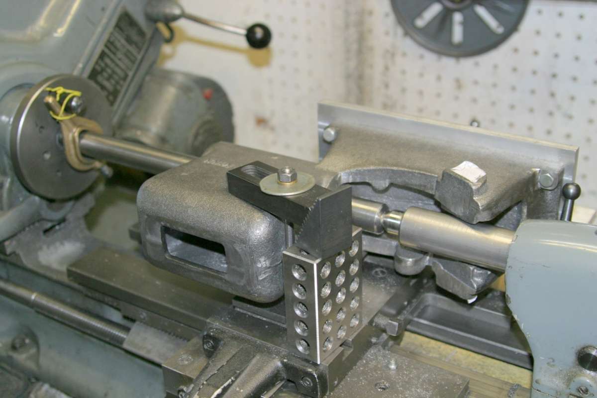

              When I got the castings I did a lot of head scratching to try and figure out how I was going to machine them on my Myford S7 and mill due to their size and weight. In the end it required some interesting setups.
              Boring 1
              Boring
              Facing
              Bottom
              Bearing Seats
