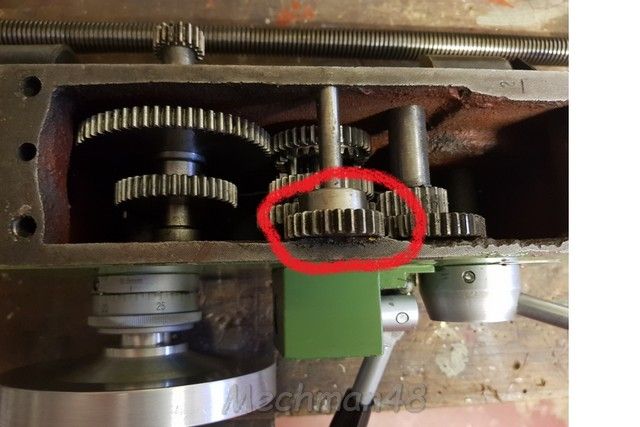

                    FWIW… 2nd & 3rd pics ; it looks as though the top pinion/gear is binding on the saddle / apron casing at the front, also do you have enough clearance between this & the top cover of the saddle casing when it is fitted together ?… check & see if there are any binding marks on the underside of the saddle / apron top half, if you do it may well lock up the pinion/gear when you fasten the top back to the lower half.

                      Sorry George but not entirely clear which pinion/gear you are referencing. But will check for any binding marks.
                      Re. The casting I'm trying not to look too closely, although does seem the norm for a Chinese lathe
                      Will make some c spanners and then put it back together whilst checking for binding.

                          Ah ok with you now, that gear wheel does stick above apron casing as it is the cross feed drive. Gear meshes with another gear on the carriage.

                            What you need to look for is if there are any binding marks under the top cover or on the teeth as when you fasten up the cover it will bear down on the gear & bind up, locking everything up, in which case you may need to put a thicker joint in to give a bit more clearance., also looking at the down position of the x feed operating lever, is it pushing the front face of the gear hard up against the casting… just another couple of avenues to look at… process of elimination & all that… thinking

                              Apron back on, however feed shaft and leadscrew not fitted as yet. Still need to buy/make c spanner
                              Without power it is difficult to positively confirm but at present carriage travels up and down bed ok and the feed lever engages both carriage and crossfeed feeds.
