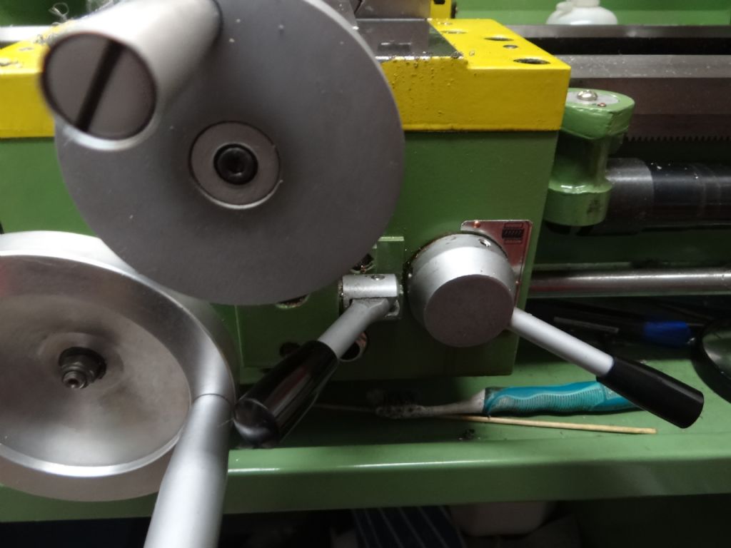

      Hi All
      Recently taken delivery of this new lathe from Warco and I am unable to get the feed working on either axis.
      The lever on the apron appears stuck and I have not been able to select either feed direction.
      Am I missing anything obvious? Thread cutting appears to be working ok so believe the gearbox at head end is all ok as I am seeing the expected rotation of the leadscrew and feed rod dependent on whether thread cutting or feed mode is selected.
      Will contact Warco but thought worth checking in here to see if I'm being dumb. Also have lugged the lathe down into my cellar, so I'm obviously not to keen upon the idea of returning.
      Looked at taking the apron off to see if anything obviously wrong but could not get easily apart. Am I correct in thinking that it has 2 tapered pins aligning the top bed plate and that these need pulling out by threading in an M4 bolt and levering upwards. Tried this but could not get them to budge. Any tips on removal in case I have to try again?

            I'm selecting feed at the base of headstock, it has three positions, screwthread cutting / off / feed
            It is the lever on the apron that selects carriage or cross feed that I am unable to engage

                    You should only have one of the two turning at any one time.
                    Sounds like the head end is OK as you can get either screw or feed shaft to turn. Can you get the feed shaft to turn at the three different speeds by selecting A, B or C?
                    You do have to wait for the groove in the feed shaft to come round to a point where the feed will engage, this can take a while if the lathe spindle is going slow and you also have a fine feed selected.
                    #298989
                      Apologies if it was me responsible for the 'both shafts turning at the same time' red herring. My first post is badly worded!
                      If the half-nut is closed as shown in the picture you can't engage the self-act feeds, which is like Nik G's symptoms. The half-nut is opened and closed by the lever on the right of the apron: to select self-act it must be in the up position, not down as shown.
                      Hope it's something simple,
                          Lever on right is up, and it functions correctly on threadcutting setting, so appears to be working
                          It is as if the feed lever is jammed and is not able to key onto feed shaft. Lever is rigid and if you apply pressure it sounds as though something is lightly rubbing in apron gear box. If that makes sense.
                          Is it worth taking lever support off front of apron box to see if anything seized there?

                                  There is a set screw underneath the block from which the lever protrudes. It provides some friction but, if it is too tight, it will lock the handle.

                                    I have completely removed the bolt/set screw and it made no difference

                                        I see the latest 290 comes with a "overload clutch to feed shaft" anyone know if this is at the head end or in the apron?
                                        Could be the clutch is not engaged, could be the lever got a bump as it went down the basement stairs.

                                          My SPG equiv of the 290 has the clutch on the feed shaft….It is fitted after the gearbox, axially with the feed shaft, a bit like the clutch on a battery drill….works well, not that I've needed it…
                                          The apron assembly comes off relatively easy….4 cap heads secure it to the saddle, you need to free the feed shaft from the clutch( watch out for the springs/balls), release the support bracket from the right hand end, the apron should just move along to the right for removal…
                                          The leadscrew cover shouldnt present too much of an issue….
                                          The grease in mine was apalling….I warmed it up, cleaned out the box and added new before replacing it on the lathe…

                                              John, looked getting the apron off but could not separate because of what I presume are 2 taper pins which locate the saddle onto the apron as well as the 4 bolts. Did not want to try levering them out.
                                              I took the exterior selector unit off this evening and with that out you can see the shaft is turning correctly but it will not push in or out to select direction/engage feed. So something not right in the apron.
                                              The prospect of getting back up the cellar steps is not really a palatable option at this time.
                                              JasonB clutch unit as John say is on the feed shaft where it exits the gearbox at headstock

                                                    Spoken to Warco and it has been suggested that I drop the apron and see what I can see
                                                    #299200
                                                    Nik G
                                                      @nikg
                                                      After a bit of a tussle the apron is off and from what I can tell the gear box is now free and working correctly. So a little confused. Something must of been misaligned or out of position. I cannot see anything obvious.
