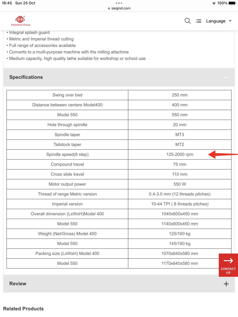

      I tried to post this last night, but the forum software was playing silly B’s again
      Here is SIEG’s spec for the lathe:
      IMG_2142
      Methinks 5000 would be a risky bit of overclocking.
      Credit: https://www.siegind.com/shop/c6-bench-lathe

        I can’t see any mention of 5000 rpm from the OP.
        Stuart

                According to This the original motor is 550W AC squirrel cage, so vfd and 3 ph definitely on the cards
