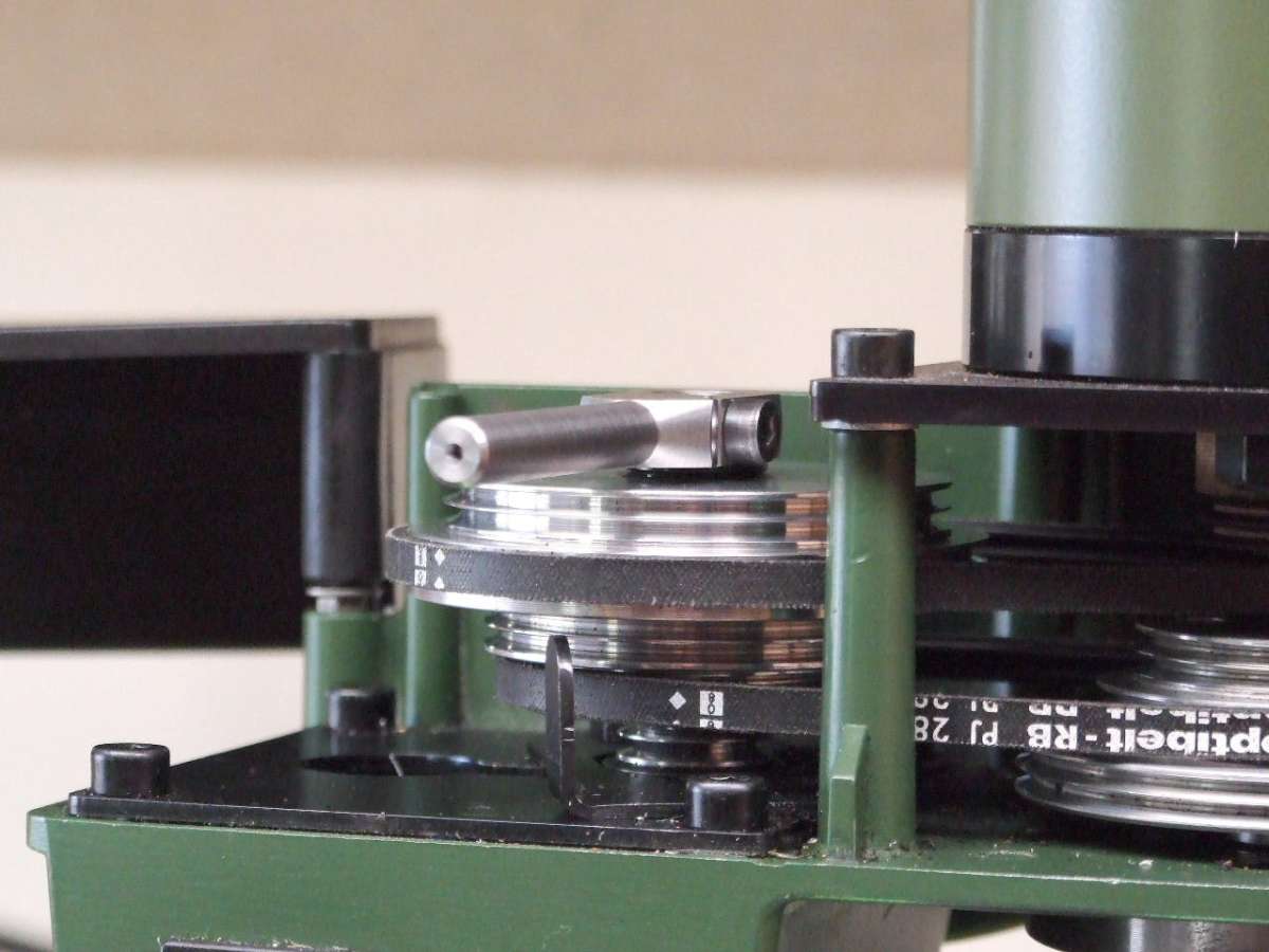

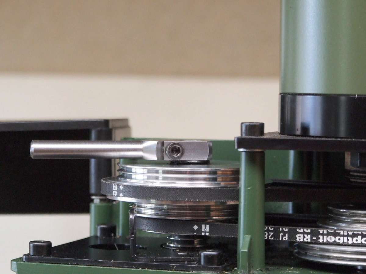

              It has been a while since I last posted anything on this thread. I have just completed a couple of items. The first is an adjustable lever that fits inside the belt cover and thus saves me looking for an Allen key. Having to search for an Allen key is one of my pet hates when it comes to using my machines.
              Lever Operated Belt Tension
              The Lever above is shown in the locked position and is so designed that the guard will only close in this position.
              Lever in OPEN position
              This image shows the lever released. One thing that no longer happens is the Pulley tilting over as it did when using a capscrew to lock the assembly. That is because an M6 stud now replaces that capscrew and thus keeps everything vertical.
              Changing speeds is no longer a hassle of trying to get a belt over a constantly moving pulley.

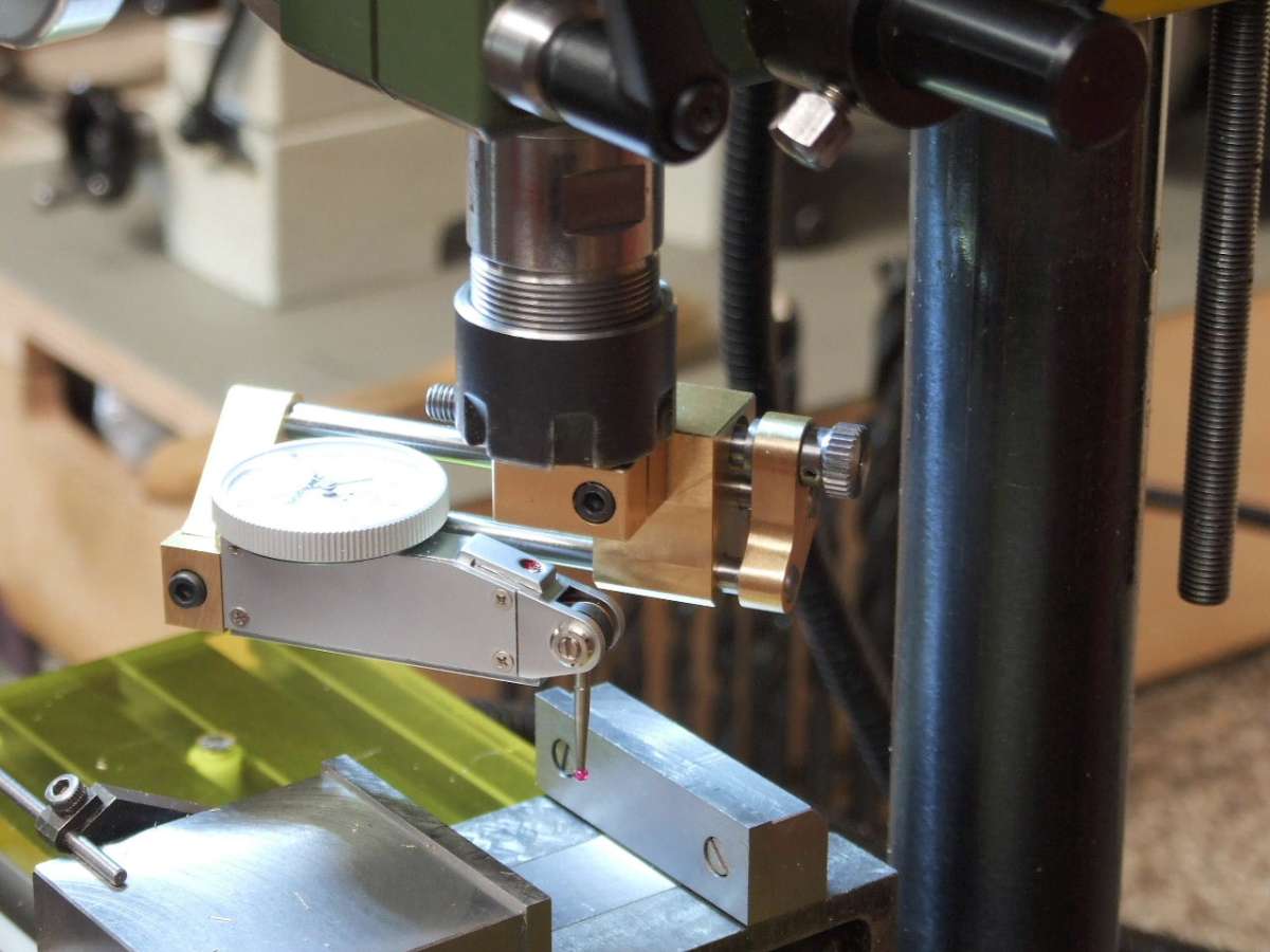

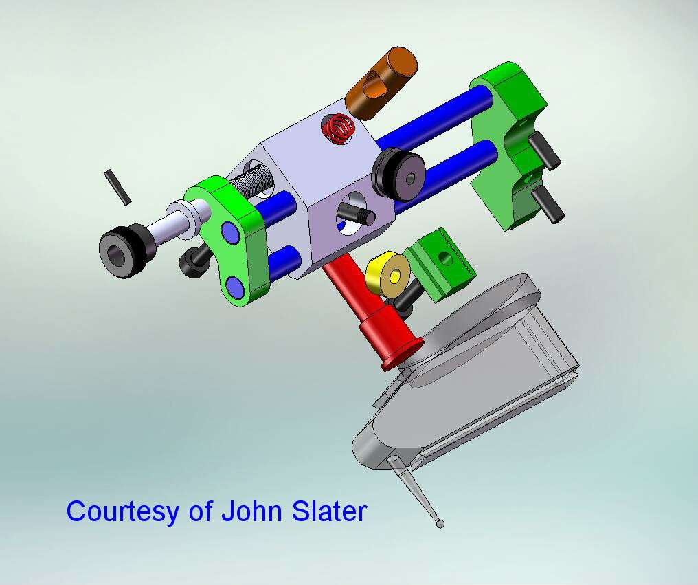

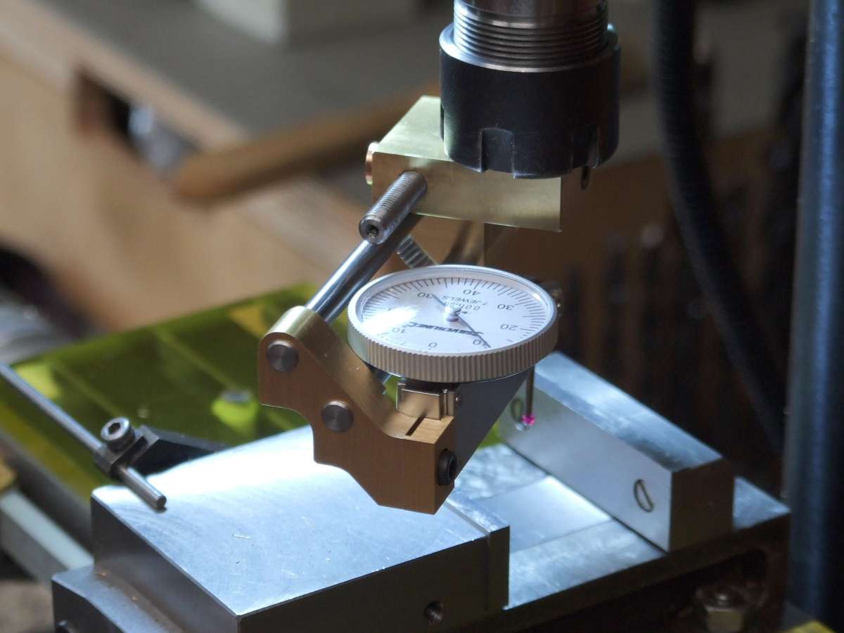

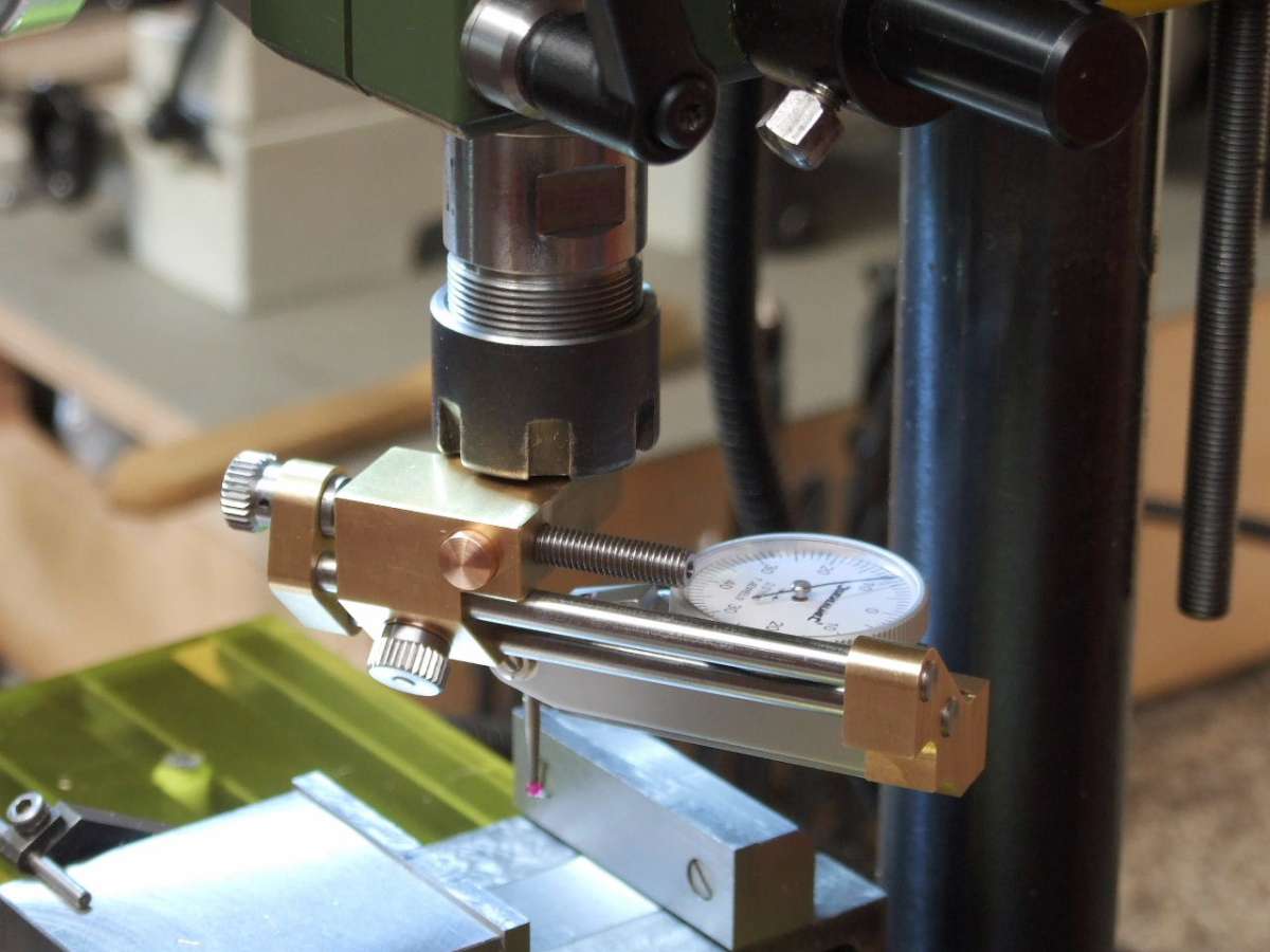

              The next item is something that came about after a suggestion and a PDF from John Slater. The PDF was a set of drawings by Stefan Gotteswinter for a Low Level Clocking attachment. I am beginning to think John is clairvoyant as this is something I had been thinking about for sometime for the Proxxon.
              Exploded view
              Whilst Stefan’s design was for a simpler sliding mechanism. A rabbit hole was introduced with regards to “it would be a good idea if the attachment had a fine adjustment”. While I disappeared down one rabbit hole John came up with a different design.
              However I wanted something specific to the Proxxon, and as such had a restricted swing before the attachment hit the Column of the machine. John having the larger Sieg mill needed a greater swing and had the luxury of more room under the spindle.
              Not fancying having to screw the clock from one end to the other. There is a spring loaded quick acting nut fitted. Which allows rapid adjustments without the need for the fine adjustment. In Stefan’s original design he incorporated an eccentric arbor to mount the unit on. This allows the stylus of the clock to be set on the machine centreline. His design needed the clock to moved out of the way for each adjustment. My design has a split clamp to allow adjustment and a shoulder which stops the whole unit dropping off the end of the arbor during adjustment. As such the clock is much easier to set-up on centreline.
              Low Level Clocking attachment 2
              This shows the unit in the machine.
              Low Level Clocking attachment 3
              As can be seen from the proximity of the clock dial to the slide bar this is a very compact design.
              This last view shows the quick acting nut button. Pressing this disengages the feedscrew and allows rapid adjustments. The clock fitted is one of the shortest on the market that I could find, without spending a fortune. As this clock will remain fitted to this unit.
              If the Moderators think this last item warrants a new thread then I am good with that.

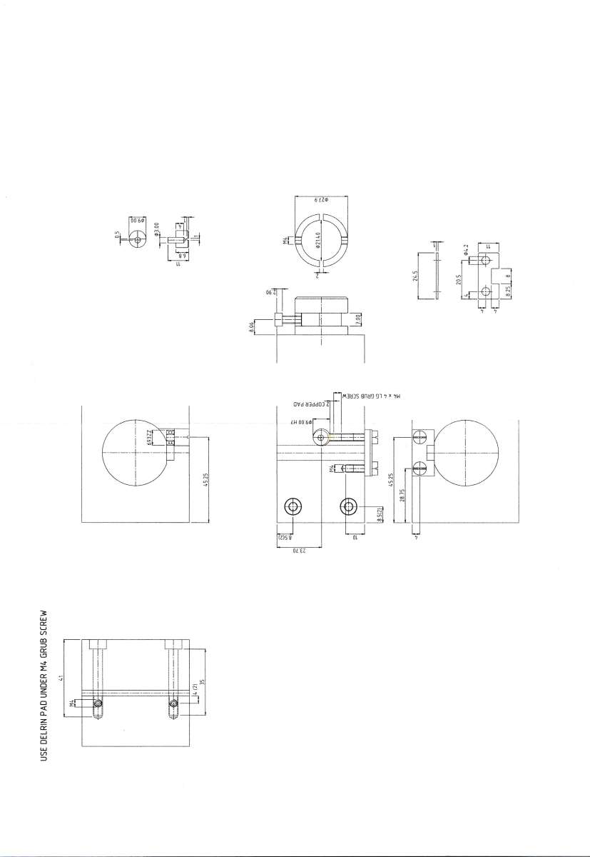

                  On Graham Meek Said:
                  One thing I had noticed when “Tramming” the milling head was that there was a tendency for the Quill housing to work it’s way out of the Slider.
                  To solve this I have made a semicircular Bronze Key which fits in the groove machined to provide clearance for the M6 Cap screw which clamps everything up when the Milling head is dead true.
                  The key is held in place with a single M4 Cap screw. The counterbore for this can be seen in the top face of the Slider.
                  The Bronze ring provided two Keys which was handy as I have a spare milling head.
                  One other thing I need to make is a Tailstock support for the Emco Dividing attachment which I have adapted to fit this machine. This will then give me the machine that I want.
                  Regards
                  Gray,
                  Hi Graham,
                  I’ve got a similar “nod” problem with my Proxxon Mill & was wondering if you happen to remember the approximate size of the bronze ring you made?
                  Otherwise do you happen to remember roughly what the “Slider” OD was?
                  I need to order some bronze but didn’t want to have to strip down the Mill to figure out the diameters needed.
                  Just need some rough numbers so I know what to chase.
                  regards Colin

                      #747877
                      Graham Meek
                        @grahammeek88282

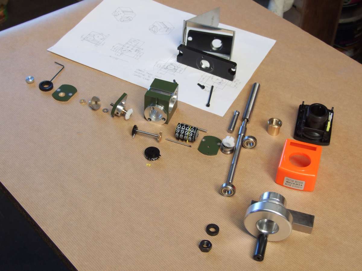

                        For those like Colin who wish to carry out his modification. Below is attached a work in progress drawing. I thought I had better add this now as I shall probably forget.
                        Proxxon Vertical
                        Regards
                        Gray,

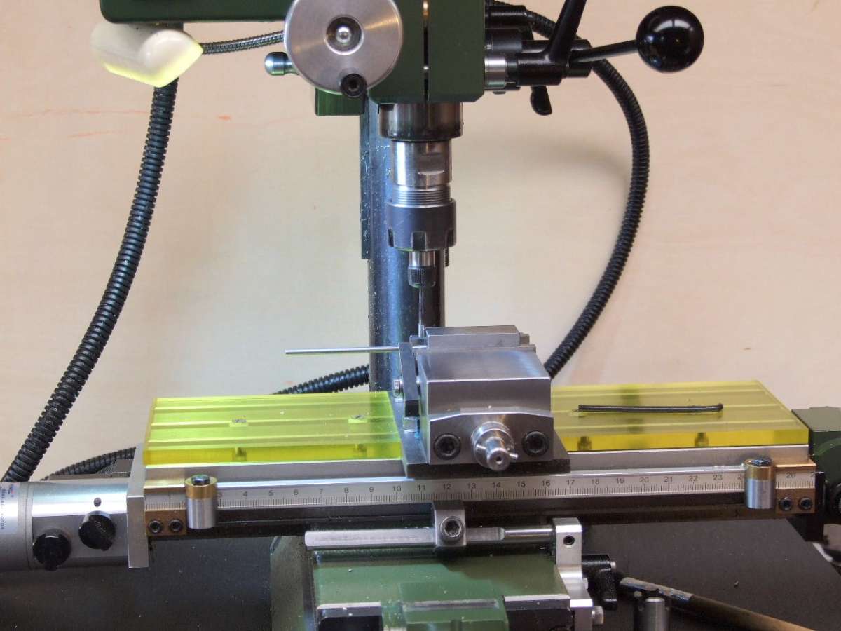

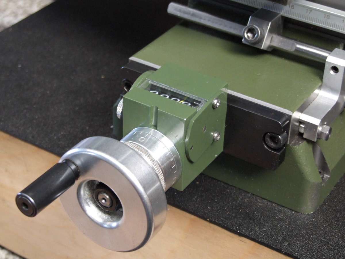

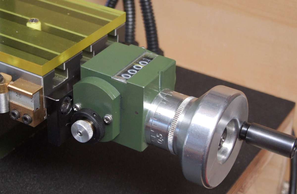

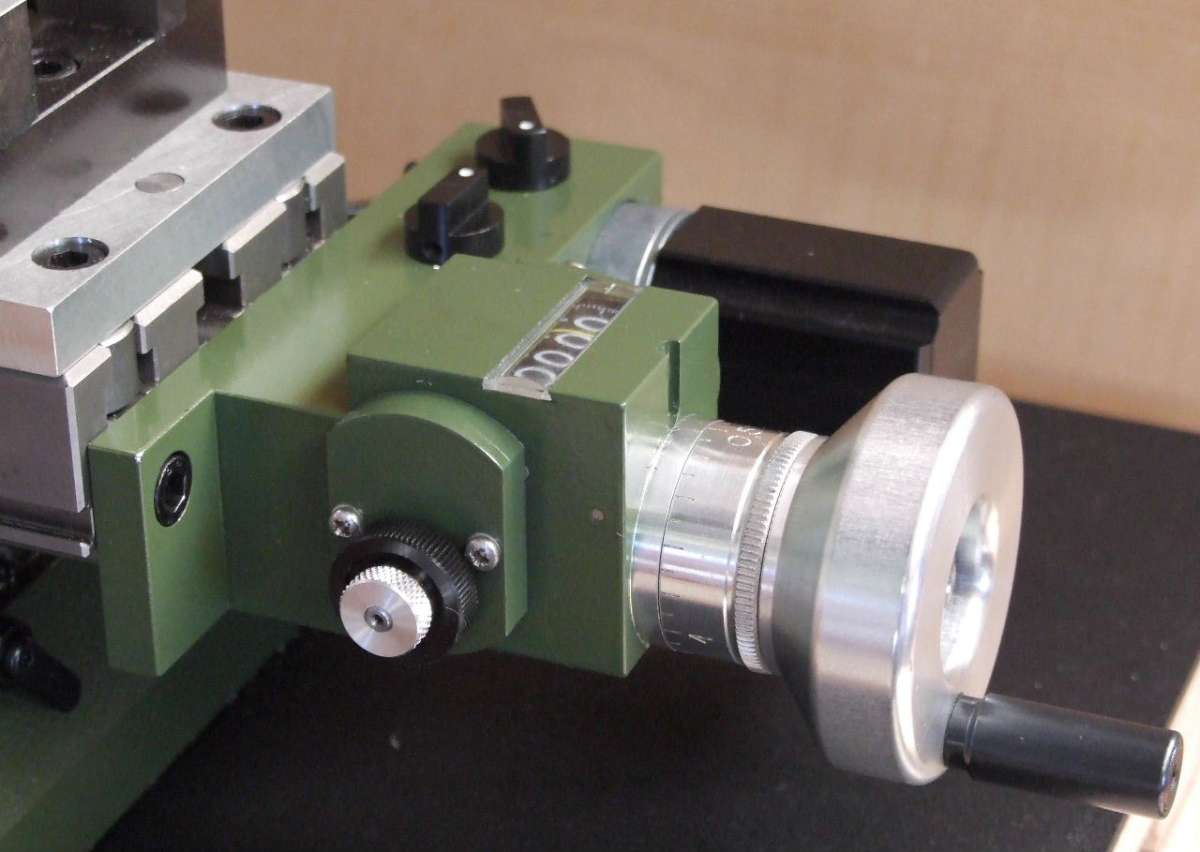

                            Following on with my improvements for the Proxxon I have finally added something I wanted to add to my Emco FB2 mills. This item was thought about in the 1980’s long before more conventional electronic Digital Readouts were so easily available, and did not require a small mortgage to purchase. While I could have added electronic readouts today. These were deemed to be too big for the machine and were not guaranteed to keep any debris or coolant out.
                            Y Axis
                            I have finally finished some Digital position readouts. It feels as though it has been a long hard slog taking me about 4 months from design to manufacture. I am however pleased with the results. There is about 0.01mm backlash in the gear train which is far less than I had expected.
                            X Axis
                            The small aluminium knob engages the drive to the unit when they are required. To stop the locking action from disturbing the setting the small brass washer has a John Slater style D shaped hole, engaging a flat on the shaft.  Although I do tend to leave the Y-Axis permanently engaged.
                            Because the vice on the older mill has its fixed jaw nearer the operator and this is my Zero. This readout unit increments with an anti-clockwise movement. All the other units work conventionally.
                            X Axis on New Feed unit
                            The Black Delrin knob is used to Zero the unit. In use I tend to return to Zero before dis-engaging the drive via the aluminium knob. This saves a lot of twiddling with the black knob.
                            The Works
                            The increased length between the ball bearing races has given the mills a much silkier action on the feedscrews. The feedscrews are a composite construction with the threaded portion coming from the original feedscrew. The parted off portion is shown in the photograph of the parts. The screw cut split brass bush made the machining of the threaded portion a breeze. Keeping everything nicely concentric. The bearing part of the feedscrew extension and the location for the threaded portion were ground using the Compact 5 Tool post Grinder that I recently finished.
                            By machining a dovetail in the top of the Main Body I was able to make use of the original Window. Which has a Zero line moulded in and a Lens to enhance reading.
                            Why did I not just use the standard Position Indicator as supplied? Well there are a couple of reasons. One is the unit as supplied has no Zero function other that releasing an Allen grubscrew. The plastic body of the unit would have protruded well above the milling table surface and thus obstructed any long work on the table.

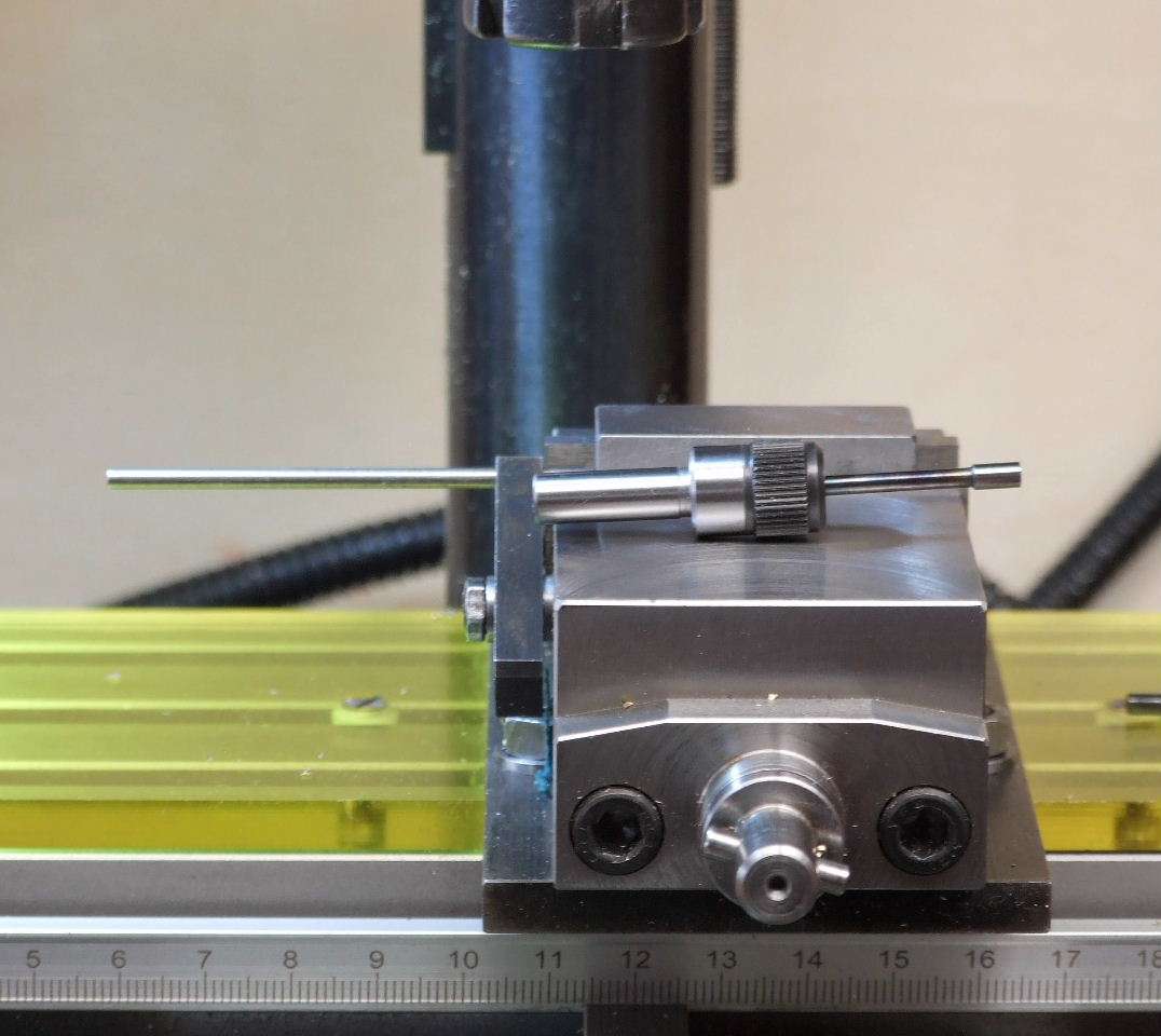

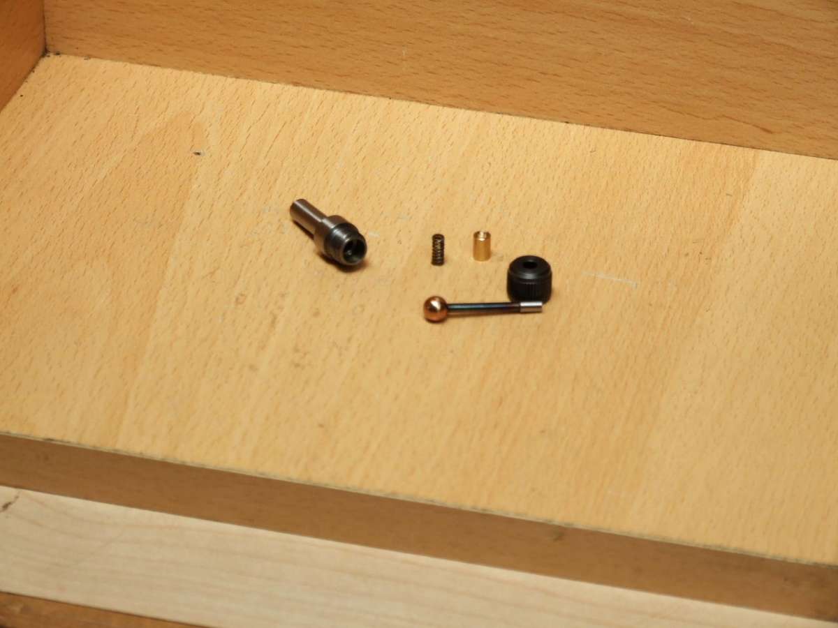

                                #802338
                                Graham Meek
                                  @grahammeek88282
                                  For sometime I have been using a Hardened dowel in the collet chuck and a feeler blade to locate the edges of my work on the spindle centreline. This is not exact but it serves a purpose, or a means to an end.
                                  Edge Finder
                                  Having completed the Toolpost Grinder for the Emco Compact 5 this gave me the opportunity to make a hardened and ground Wobble Bar or Edge Finder (E-F). This takes out any errors inherent in the Collet and Collet Chuck set-up. It also removes the need to fiddle trying to get a feeler blade into a tight space on a small component.
                                  I had been looking for some time for a commercial 3mm probe E-F but these were far too expensive for what they are and the overall length was too great for my liking.
                                  It was eventually decided to make a slightly scaled down version of GHT’s E-F. I have remodelled the internal parts in that I have the pressure spring housed in the Brass pressure pad. Rather than in the holding spigot, as I have reduced the original 1/4″ diameter to 6mm. I also took GHT’s advice and used a Phos Bronze Ball Bearing.
                                  E-F Parts
                                  In use the E-F gives consistent results and the kick over point is about 0.005mm from a true zero, as far as I can measure with my equipment. It is certainly too small for me to worry about these days.
                                  Regards

                                  #802419
                                  Jamie Wood
                                    @jamiewood67138
                                    Nice idea Gray, I have found the standard size wigglers a bit too big at times on my C5 mill!
                                    I suspect I know the answer already, but did you also make that vice you have on the mill?
                                    Jamie
                                    #802454
                                    Graham Meek
                                      @grahammeek88282
                                      Hi Jamie,
                                      The size of the commercial edge finders would mean a lot of action on the Z-Axis feedscrew. Which at 1mm pitch means a lot of stress on my Rt arm, something I need to avoid at the moment. Thus I went for something a little more compact. The protrusion from the collet chuck is in the order of 38mm.
                                      You are right as regards the vice. I made that prior to disposing of my Emco FB2. I have been toying with making another for the other Proxxon mill. It has the advantage that with the fixed jaw nearest the operator the Y-Axis slideway has more engagement with the base, for most of the time. Less engagement only comes with wider parts, which I do not do a lot of.
                                      Regards
                                      Gray,

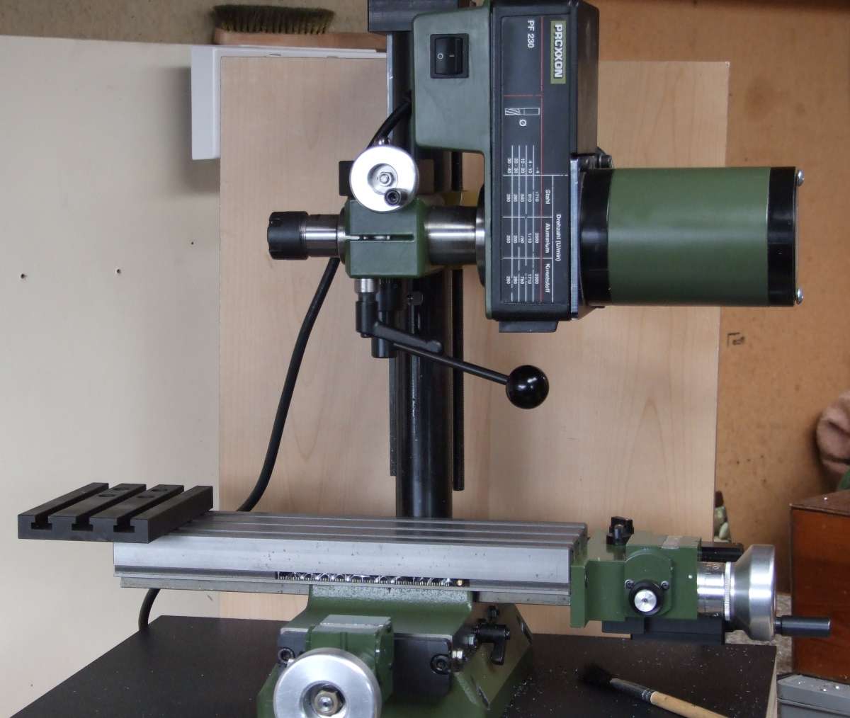

                                      #845620
                                      Graham Meek
                                        @grahammeek88282

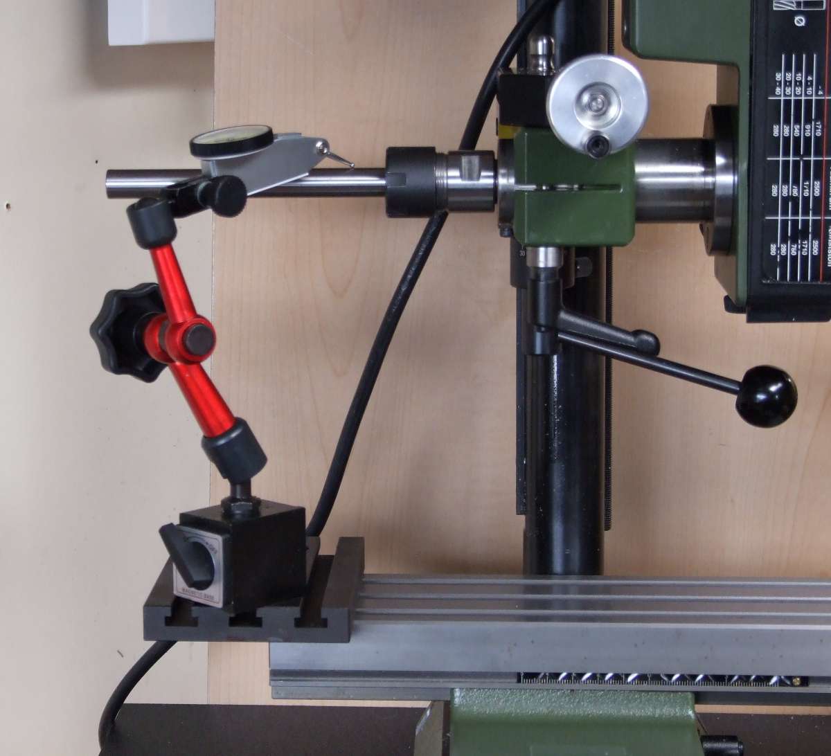

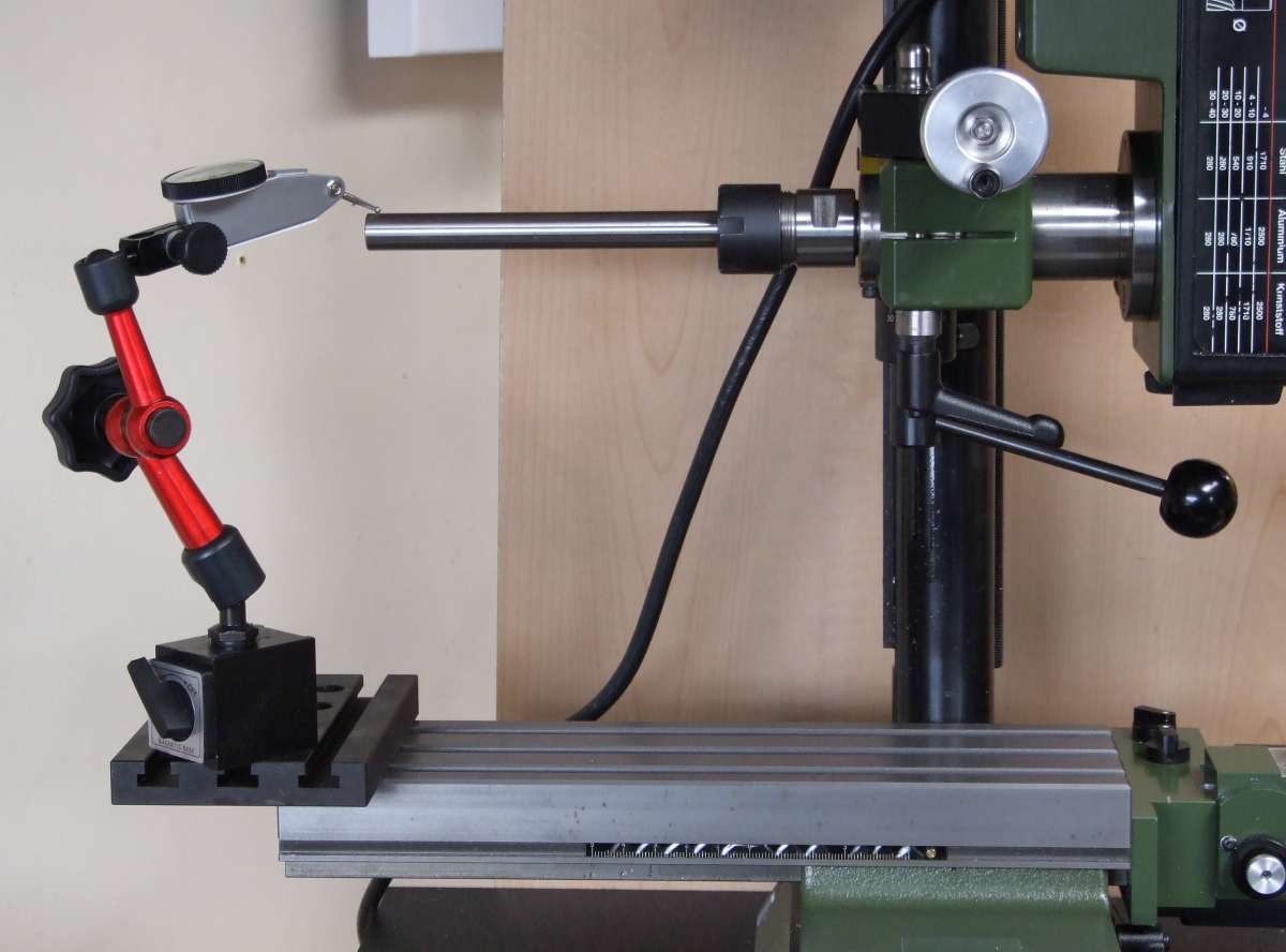

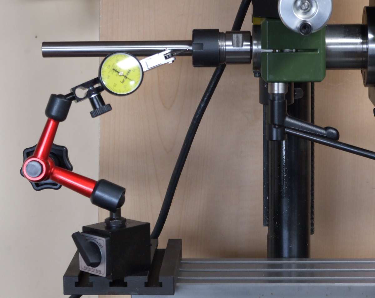

                                        A couple of weeks ago I had two visitors to my workshop and they were taken with why my one Proxxon mill was in a Horizontal mode. They were also intrigued with how I had set the machine up, so I thought a few notes explaining how I did it might be helpful to others.
                                        Horizontal Set-up
                                        The above Photo shows the configuration. I was asked if I had just worked to the degree scale on the Quill Housing. As this is only a “stick-on” scale and graduated every 5 degrees this would not be accurate enough. If the machine spindle is not truly parallel to the Table surface and the X-Axis vertical then any cutter used in the spindle for boring would be describing an Elliptical path not a true cylinder.
                                        Clocking Set-up
                                        Thus the clock is set-up as shown above. To find the highest point the clock needs to be oscillated using the Y-Axis feedscrew.
                                        Clock Moved in the X-Axis
                                        When the table is moved to the other end of the mandrel the clock is once again moved in the Y-Axis to get a true reading. At his point it is not known if the spindle is on the true centreline of the X-Axis in the vertical plane. It could, and probably is at an angle.
                                        When the clock is reading Zero at both ends of the travel for this test.
                                        It is then time to set the mandrel true on the X-Axis in the vertical plane.
                                        Clocking the Spindle Axis parallel to the X-Axis
                                        The set-up for this is shown above. Now it is known the mandrel is parallel to the table. One move in the Z-Axis to find the high point on the mandrel is all that is needed this time. To get the mandrel true in this axis requires the Column clamping screws to be released and the milling head swung to or fro to get the adjustment right, with Zero at both ends of the travel.
                                        I was asked by the two visitors why did I need to set the machine up like this. The answer to this can be found out by visiting this post,
                                        Emco Compact 5 Modifications
                                        I hope these notes prove useful to others.
                                        Regards
                                        Gray,
