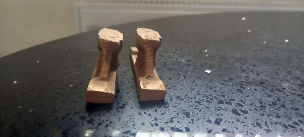

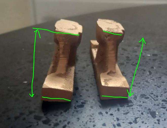

      I’ve brought a Kennions Tina casting set and I’m  very disappointed with them so far. I’ve finished six castings and found no room for errors. These two have 1/16th to play with from the base to the top, the eccentrics  gave me problems as hardly any room for error.
      Kennions seem helpful as the base feet don’t align with the castings but after adjustments with the measurement I got it reasonably central for the castings to sit on.
      I must admit I prefer to make engines from bar stock so far .
      1. Is it me or is this the standard for a casting, watching Joe pie with his beautiful castings for a engine.20260915_103042
      2. 20260915_102915

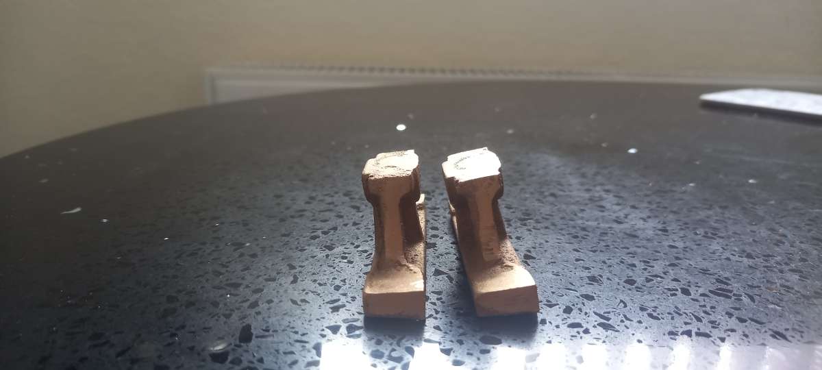

        Could be three things, poor patterns, poor tolerances, poor foundry.
        #865028

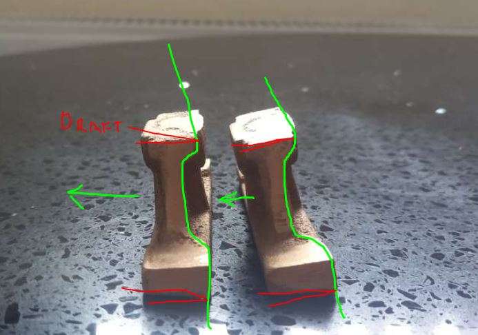

          Or poor understanding of how they were cast. To me the feet not being at right angles to the casting is not something to worry about. What really matters is that there is enough metal to fully clean up the top and bottom to the drawing size. If there is enough metal where I have shown then the rest is machined off so not critical.
          what matters
          One needs to study the casting and understand how it was cast and what the pattern was like. The tell tale with these is that the fettled parting line does not run centrally up the sides. You can clearly see it coming in from the thick side and following the line I have marked.
          If the pattern is to be removed from the sand then the sloping top and bottom will need draft angle and that is what is making you think the foot is not cast square. The patterns would have been cast with teh arrow upwards.
          draft
          They look about average for what you might expect.

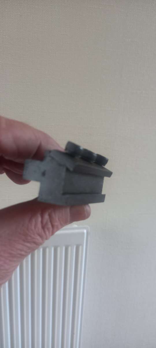

                      Hello, I will keep to this post but this is not about castings  but is connected to the same job.
                      I’m on the eccentric and about to put the groove in the steel part. I’m using the back of the lathe so upside down for more rigidity.
                      This holder for tool steel blades is 90 deg and not at an angle to allow the clearance. Is this standard on these holders.
                      When clamping up one side is flat, I need to put .25mm on the bottom so it’s square.
                      I’ve run out of my 2mm inserts that I normally use so that’s  why I’m using this.
                      Why hasn’t this holder ground at an angle to accept the parting tool relief.
                      I thought that it would self center but it doesn’t.
                      Thanks Bob20260927_115416

                        Because its made for a parallel blade
                        #866676
                        Martin Johnson 1
                          @martinjohnson1
                          I think what you are saying is that the parting blade sides taper by 0.25 per side for relief.  Therefore when you clamp it up, one side sits vertical and the other face sits 0.5 out of vertical.  Not great but seems to be par for the course with that style of holder.
                          Well you could use a wee bit of 0.25 shim to bring things right.  What I did was to drill and tap for 2 grubscrews rignt through the face that to the right of your photo.  Then you can adjust the tilt and not worry about losing the shim.
                          Hope that makes sense.

                            Thanks Martin that’s a good idea, I shall do that now. I was going to shim it but grub screws is better .

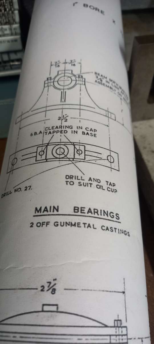

                              As this is my first casting for an engine and not wanting to muck it up,another basic question.
                              The main bearings in gunmetal have a 3/8th diameter and the distance on the base is 2 3/8th centers. In the past Ive reamed out the bearings and fitted on the base and not really had any problems.
                              Is it best to bore out a few thou undersize fit on the base and ream out to 3/8ths.
                              If so what type of reamer would be best for this, Ive seen a hand reamer on the auction site that would just do 2 3/8ths centers. Or will I need a taper reamer, which I cant find.
                              Thanks Bob
                              #866809
                                A lot will depend on how accurately you can place the holes in the two castings.
                                I would machine the bottoms of the castings first then hold them laying sideways with the foot against the mill vice’s fixed jaw and form the holes in both without moving the vice. This should ensure the two holes are the correct height above the feet. Lastly add the smaller holes to bolt them to the base.
                                Assemble with a piece of 3/8″ silver steel through the pair and work your way round nipping up the fixings and you should have a shaft that will rotate.
                                For doing the actual hole at 3/8″ I would probably not bore so it would be spot drill, 6mm (1/4) and then reaming size of 9.3 (23/64) then ream with a machine reamer, though a hand one can be driven in the spindle if you take it slowly.
                                If you do find the holes are tight then a hand reamer is better as that has a tapered lead in but allow for that in the O/A length of the flutes. Failing that a piece of silver steel cut and filed at a shallow angle of 20-30deg and hardened can be worked into the holes and will take a little off if tight, the bonus is the rest of the length of Silver steel will act as a guide.

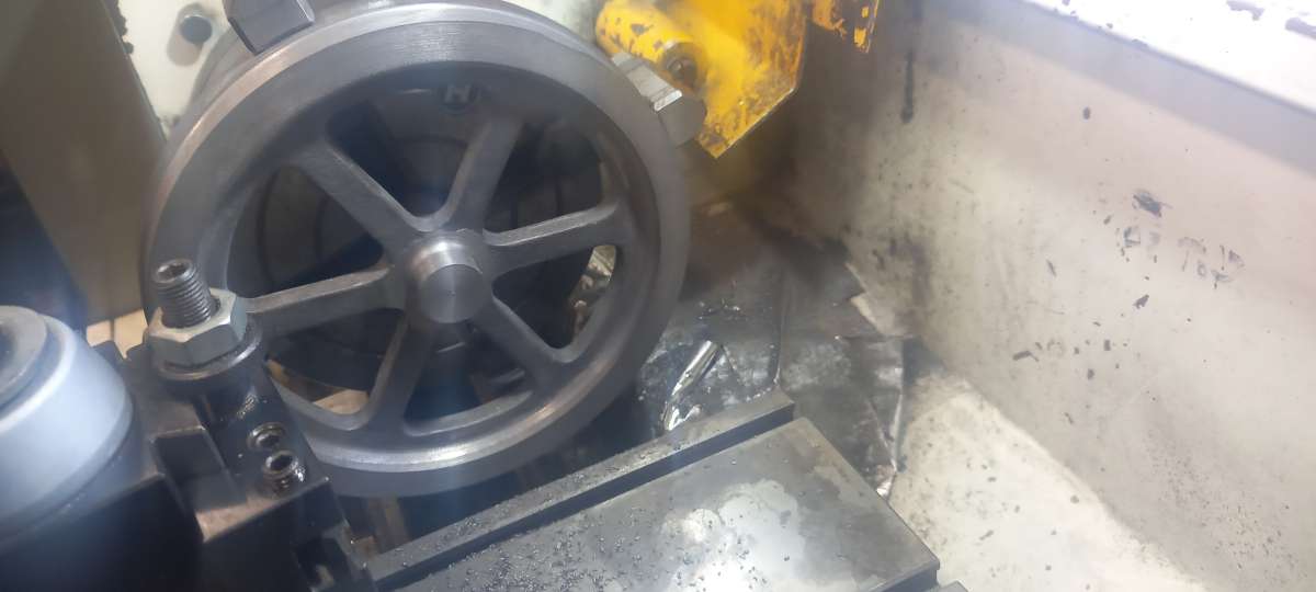

                                    Hello, I’ve done a small cast flywheel in the past but that didn’t need much of a clean up on the flanges. This six inch dia wheel is a bit rougher, would  a skim on the flanges look out of place when finished or is the rough look accepted on model steam engine.20260930_121233
                                    #867251
                                      What part are you describing as the flanges?
                                      Apart from the OD, sides of the rim and faces of the hub which most people leave bright the most I might also turn if things are bot running true are the inner rim which I do with a round nosed tool stopping at the web between the spokes.
                                      You then usually have to do a bit of blending with a Dremmel or similar to feather the turned surface into the cast, similar will be needed where you have that area coming out towards th eroot of the spokes

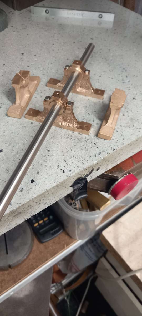

                                          Hello, My early on post about poor castings for the bearings I contacted the company and they agreed and sent me two replacement. The replacement were if not worse than the ones I had with the little material on the castings.
                                          I kept to the original pair, juggling with the measurement to make them look OK.
                                          The top bolt holes had a measurement of 7/16 from the centres 11.1mm ,I made them 12mm as 7/16 would have  moved them in to far on the radius.
                                          The castings as you can see are not like the drawing.  So easy to make a balls up,I just hope I don’t.
