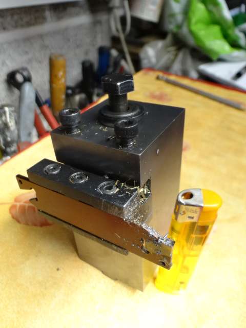

              Whilst running upside down in reverse is an advantage, rigidity is the main reason for using a rear tool-post.
              Comparison!
              My front tool-post is a towering multi-jointed edifice.  I’d describe it as spindly rather than solid, and it’s height causes it to increase forces by acting as a lever.  All front tool-posts are bendy, especially those on small lathes.
              When cutting, Newton’s third law applies: ‘when two bodies interact, they apply forces to one another that are equal in magnitude and opposite in direction.‘  A front-tool post’s ability to resist ‘opposite in direction’ forces is limited by how much metal is in it, the height,  the joints, and the route taken by reaction forces to ground.
              DSC06917
              In contrast rear tool-posts are a hefty solid block of metal firmly bolted to the saddle.  They are much stiffer than a conventional front tool-post.  Stubby with only two joints: the slot for the cutter, and where it joint the saddle.  Leverage is minimised too: cutting forces are taken almost directly straight down into the saddle.  It’s instructive to trace route taken by forces grounding through a front-tool post; it’s long and twisty – not ideal.
              DSC06918
              As front tool-posts go, though inferior to a rear type, the 4-way is fairly solid.  As QCTP tend to be more spindly with extra leverage through the tool-holders, they are often less rigid.  Therefore I suggest beginners think twice before rushing to fit them.  Ask what’s more valuable in your workshop – is it rigidity or the ability to swap HSS tools quickly?

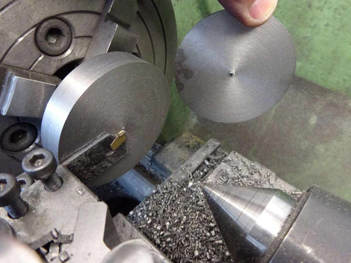

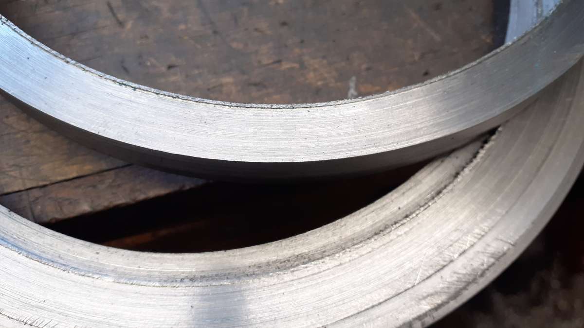

                  Front QCTP works for me even on a “spindly” cross slide
                  70mm cast iron parting a 1.5mm thick disc, part held by approx 15mm dia chucking spigot

                  200mm dia x 25mm thick wall steel tube with 1.5mm HSS. I did saw the last 0.75mm rather than have the ring drop on the bed.

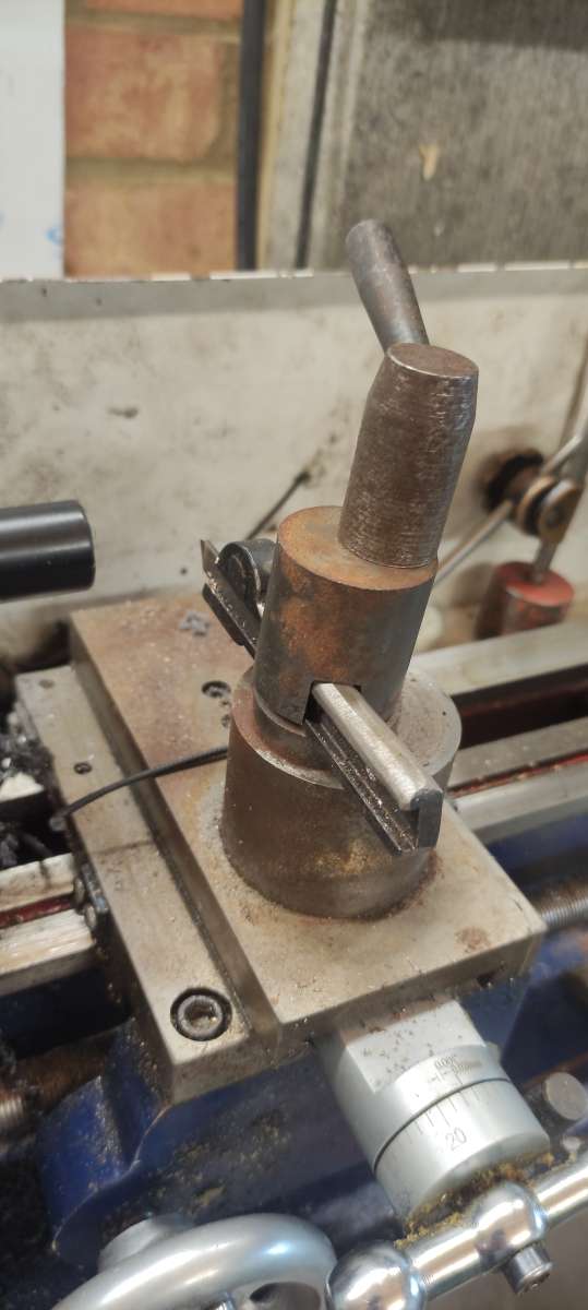

                      When I made the rear toolpost for the Smart & Brown model A, I added a second lock at the rear of the saddle. Having a very long cross slide helps greatly, and what makes the biggest benifit for parting in particular is not using the top slide, giving added stiffness. Having power cross feed is a benifit especially as then you can keep a steady trickle of coolant running. The power cross feed has gone wrong again on the S&B, it is such an antiquated design that we are constantly putting off mending it.

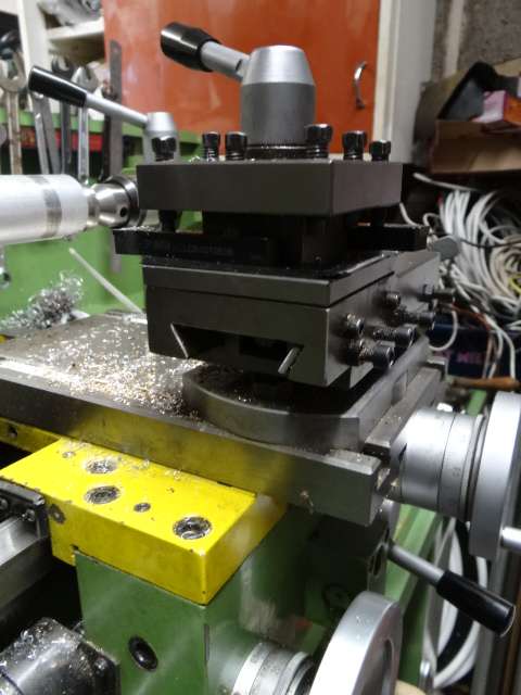

                              When I got my mini-lathe it was fitted with a QCTP that hung the tool off to one side by a long way, potentially even outside the footprint of the carriage. This caused no end of headaches when parting as the tool would move around, jam, and generally spoil my day.
                              I solved this problem by replacing the compound with a solid block of steel (the same height as the compound) and making a special parting blade holder that replaces the QCTP/4-way for parting operations. It holds the tool as close to the carriage centre as possible with maximally rigid support underneath.
                              IMG_20250223_114040
                              This makes a night and day difference. The tool no longer moves around, which majorly reduces the chance of jamming. It also allows for heavier cuts which avoids the risk of rubbing and the work hardening that rubbing can cause. I roughed mine out with an angle grinder and cleaned it up with a small shaper, but you could mill one or even just use a hand file

                                    Last week I had to make a part similar to that which I showed on 4th Sept so took a video.
                                    Insert “blade” in a clamp type holder so added overhand, QCTP so some additional overhang, Topslide as that is what I use, OEM topslide clamp not the heavy ones some people seem to need to make. Used insert. Up the right way All on a far eastern 280 lathe.
                                    Parting a 1.5mm slice off 70mm dia iron casting. Only held by a 15mm dia chucking spigot which some would say makes it less rigid. Measuring the disc afterwards there was less than a thou difference in thickness from edge to middle. No Jams, I did stop once to extend the blade out of the holder and removed the tailstock support at the same time.

                                        Pete, although I did not video the whole cut what happens when cutting conventionally is that there is a constant stream of swarf working it’s way along the top of the tool until it meets the OD and then drops down. All the time it is sitting on the top of the tool there is a risk of some getting between the tool and the side of the cut and causing a jam or simply pushing the tool sideways.
                                        If I were doing that cut in CI with the tool upside down then the swarf would drop from the tip not remain in the cut until it worked it’s way to the OD. So less chance of becoming trapped. I’ve not been able to get curls of swarf when parting CI so it is just a pile of fine chips building up on the top of the tool.
                                        More likely to be a problem with HSS as you generally don’t have the side clearances that the insert tooling gives or the shaped tip that curls the swarf into a strip narrower than the kerf so any friction you mention will be lower or none at all..
                                        Suggest you look at some CNC machining ctrs, few have the tools mounted as we do in a lathe, many come in from the back with the tool inverted.
