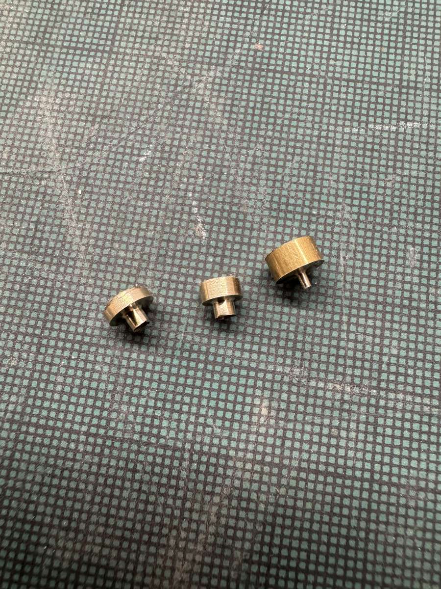

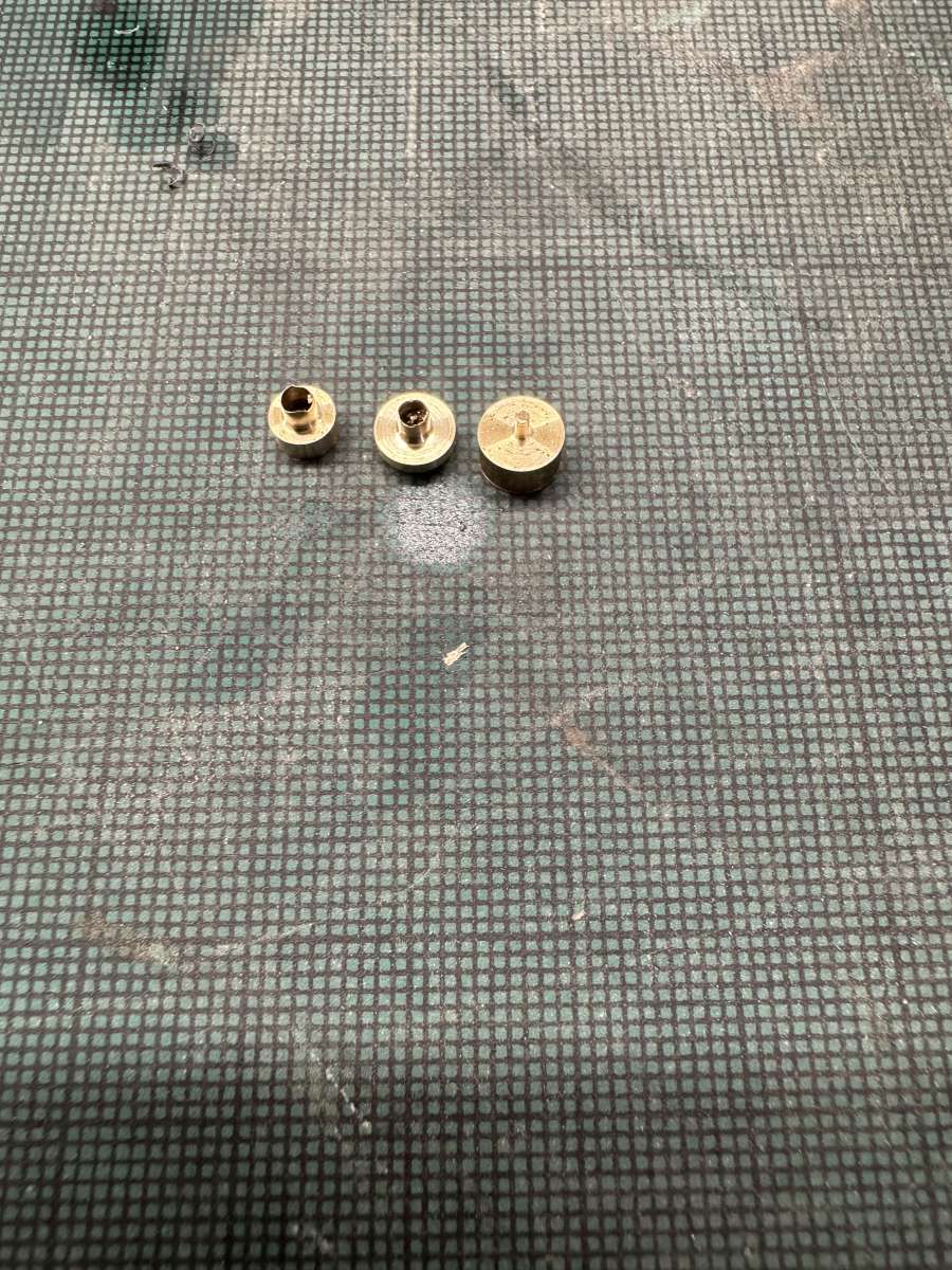

      I’m learning turning and parting off on my mini lathe just using some 6mm brass bar, turning and facing is ok but when I part off I get left with a stalk.
      The part seems to snap off before it’s cut, I’ve got the insert centralised (the best I can by shimming) running at around 350rmp with cutting oil using the insert shown.
      Any advice appreciated.IMG_1738IMG_1739IMG_1740

        Don’t use cutting oil on brass. Is your tool too high? and slow down a bit.

          Ok thanks, I’ll try and get the tool a bit lower.

                        At 6mm diameter,  brass with carbide tooling, rpm ideally should be about 3,000. Knock that in half because parting can be more difficult than plain turning and you are still at 1500 rpm.
                        Running at 350rpm on such a small diameter in brass with carbide tooling is such a low surface speed the carbide will struggle to cut, as you have found.

                          Ok, thanks for that I’ll try speeding up.

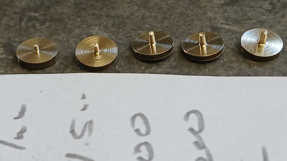

                                              Seems like a good excuse for a Sunday Morning Turning Trial.
                                              Warco 280, 1000rpm, 6mm Brass, Fine power feed. All cut Dry
                                              Nikcole-Mini-Thin 1.0mm N left a pip of 0.5mm. This is my goto parting tool for small diameters but not Cheap.
                                              1.5mm HSS left a pip of 0.70mm
                                              MGGN200 left a pip of 0.82mm(new insert)
                                              MGMN200 Same as OP is using left a pip of 0.84mm(new insert)
                                              GTN-2 in 19mm Glanze blade left a pip of 1.02mm
                                              20250831_084006
                                              Not having a mini lathe to hand to see if the problem was due to a smaller machine I used the closest to hand with was the Unimat 3 Micro Lathe. Had to cobble something up to hold the large insert holder but got similar results to the larger Warco using the ground MGGN200 on 6mm brass at 920 & 1400rpm. Steel at 6mm and 10mm gave a slightly thinner pip of 0.75mm both at 920rpm.
                                              So I would conclude that the thinner the tool, the smaller the pip or thinner the foil around a hole. Makes sense as the thinner tool is not pushing as hard against the ever decreasing diameter. There is a downside to this in that a thin tool will want to wander more so for deeper cuts increase the width but on small work a narrow tool is the best option and saves wasting expensive brass.

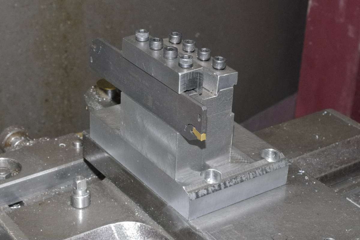

                                                      Assuming that the cross slide was long enough, it probably be drilled and tapped to hold a rear toolpost for inverted parting off tools. The cross slide would have to be removed first of all to acertain whether there was enough thickness ans also clearance for the modification.
                                                      I made one for the Smart & Brown model A which holds 26 and32mm blades inverted which is easily detachable and a set of slotted grub screws to fit in the holes to keep swarf out when it is not fitted. The blade in the picture is a 32mm Kennametal 3 or 4 mm.
