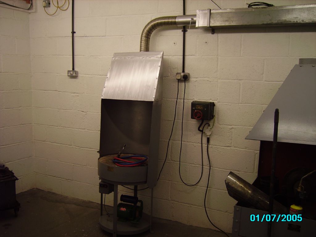

            I added a canopy to mine and refreshed the original finish which was aluminium primer!

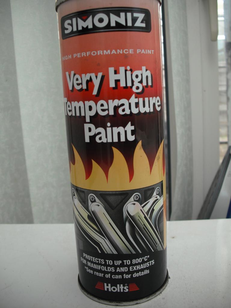

              Vehicle exhaust paint, some goes up to 650⁰C.

                  I have decided to get some of the high temperature exhaust/ manifold paint as recommended by Brian and Anthony.
