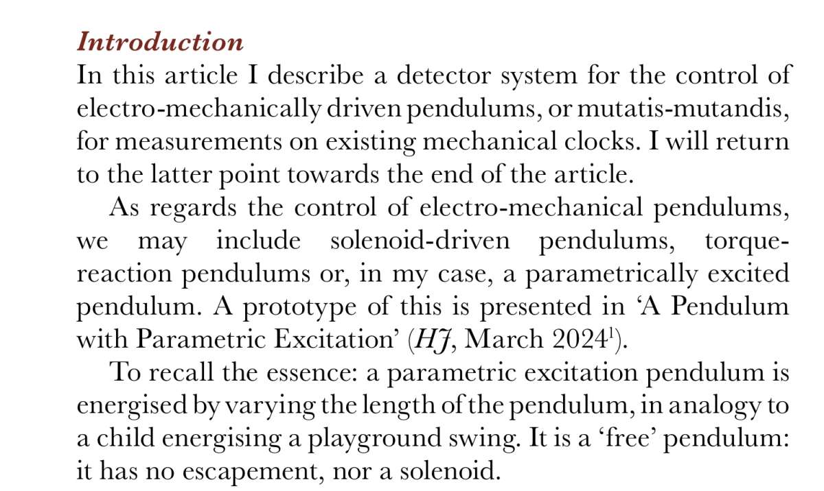

      #817631
        Many thanks for that link, Duncan
        The introductory text in the recent article contains a statement of analogy with which I was struggling:
        IMG_1104
        Perhaps reading the  older paper will get me into the right frame of mind.

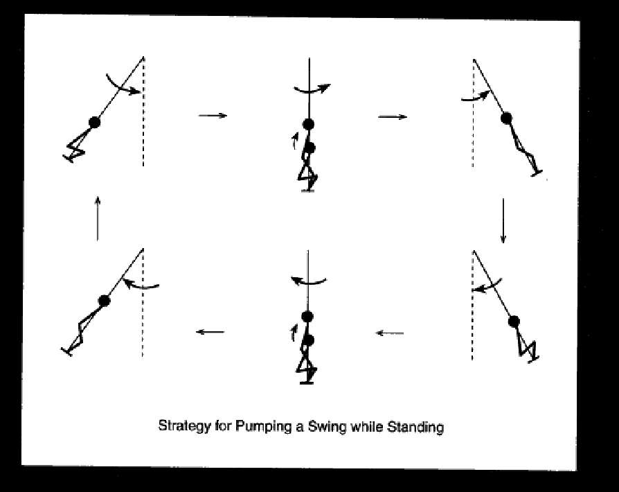

        #817632
          What’s the problem? Seems to fit with the diagram on the front page of Duncan’s second link to the dreaded maths:
          pumping
          But now I think about it my brain hurts!
          #817635
            The problem is that the standing manoeuvre is only effective when the swing is already in motion … Presumably we are required to assume that  chaotic behaviour will suffice to get a pendulum away from its rest position.
            … it probably will
            … but it seems a convenient omission in the analogy
            [ note particularly the final statement that I quoted ]

            Nigel Graham 2
              @nigelgraham2
              Intrigued, although not a clock-maker, I followed both papers to the extent my very limited knowledge of electronics and Very Hard Sums allowed – I picked out the action rather that the circuit description or the mathematics.
              Although I take the point I am not entirely convinced by the analogy using just effective length because the excitation of the swing is by more than simply standing and crouching (i.e. by varying the length as a pendulum.)
              As I recall from Rather A Long Time Ago, it involved a sort of pumping action that imparted an angular thrust by moving one’s centre of mass back and forth; irrespective of sitting or standing on the seat. Indeed, the paper on how to operate a playground swing does point this out, I think, in analysing how a seated rider increases the amplitude; but does say this has a limit beyond which the greater swing is gained by standing.
              A person alternately standing and crouching on a swing will impart that angular force simply by body movement alternating the balance point, not by the purely vertical component. When we stand and crouch on the solid floor, we must move the position of our centre of mass slightly fore-and-aft with respect to our feet; with our sense of balance stopping us toppling. That’s all instinctive too, in very complex feedback mechanisms that animal biology “just do”.
              On a swing that lateral movement of mass is transmitted to a seat suspended on what the Physics text-books like to call “light inextensible strings”. (On a conventional swing the mass of the ropes or chains, and any suspension-point losses, probably are negligible; but is that so for the clock pendulum in this case?)
              This is illustrated for me by having had both knee joints replaced. If I try to crouch, or to kneel up as if praying, I topple forwards because the artificial joints do not let my upper legs and body tilt back far enough to compensate.  (This may depend on the joint types. My limit of bend is only just over 90º but others might have more flexible TKRs.)
              So whether sitting or standing, the swing rider is likely doing rather more than simply moving mass up and down the ropes: the action is creating a lateral force change as well as length change
              (I never had the nerve to take it to the point some of my fellow youngsters did, of approaching the horizontal!)
              Mention is made of the swing ropes taking a pronounced kink at certain points in the cycle – but is part of that due to the swinger effectively putting a rigid link between seat and rope, below his or her hands?
              So, what in fact is the electro-mechanical pendulum doing? I cannot see how simply moving the bob up and down will impart the angular force inherent in starting and maintaining any conventional pendulum (or playground swing); so what have I missed in the description? Is the mass oscillating also sideways?
              It’s certainly an interesting concept!

                I must admit to being too lazy to go through the maths, but the real pendulum works by just raising and lowering the bob, so why doubt the sums? I don’t think the real pendulum will self start, and I suspect that just leaning back whilst stood on a swing gives it enough motion to then increase by vertical pumping, but I’m too old to go to the playground and check it myself. Next time I take the grandchildren I’ll take note
                #817657
                  On duncan webster 1 Said:
                  I must admit to being too lazy to go through the maths, but the real pendulum works by just raising and lowering the bob, so why doubt the sums? […]
                  Because although they are too hard for my stagnant brain … they are also too simplistic to describe reality.
                  Nigel has very helpfully elaborated on my ‘nagging doubt’ about the author’s analogy.
                  Can we really believe that [in your words]

                        The key is not to think of the bob motion but its acceleration.  Any vertical accelerations add to or subtract from the force of gravity.  Imagine that a vertical acceleration is applied just before BDC – this slightly increases the downward force and there is a small horizontal component of this which accelerates the bob slightly towards BDC and increases its energy. Similarly a deceleration after BDC accelerates the bob away from BDC.  Both tend to increase amplitude.
                        Another approach recognises that the tension in the rod at BDC is slightly greater because of the centripetal force on the bob.  A lift at BDC inserts energy as it works against this force which can only go into the bob’s kinetic energy.
                        Both approaches result in a fractional amplitude gain dA of
                        dA/A = h/L
                        where A is the amplitude, h the lift, and L the pendulum length. Obviously the pendulum has to be swinging initially for this to work.  Back in days before low noise microwave transistors were developed the bees knees for RF amplifiers in radio telescopes and suchlike was the parametric amplifier which used a varactor diode varying the resonant frequency of a cavity at twice the signal frequency.
                        The child on swing analogy is not very helpful I think as she can in effect create a lateral force by stick out her legs and drawing them in again.

                            That basically my point. A person sitting or standing still on a swing will not make it move, and as you say simply imparts tension to the ropes.
                            Using a swing necessitates imparting a lateral force as well – and that is indeed how it is used. As soon as you lean forwards or backwards, you add a horizontal component to what had been at first a purely vertical force, neglecting any swining from the act of simply climbing on board. That component is from a combination of moving your centre of mass, and the reaction to your muscle movements – and those are usually, deliberately quite powerful.
                            This is where the analogy does not really explain the pendulum. What sets the pendulum moving in the first place?
                            A conventional escapement operates by one pallet being wedged sideways by an escape wheel tooth at each half-swing, to start the pendulum swinging, or balance-wheel oscillating, and to maintain the motion; but the effective radius is constant and it demands some energy input at each cycle.
                            The cathedral’s incense-burner will swing, of course, at a rate set by its depth below the pulley – and is large enough to keep swinging for a long time – but it still needs someone to start it swinging. If the priest did not do that but simply hauled it back up, it may well swing slightly, but from perturbations in letting go of it and hauling it up, especially if the pulley journals are themselves suspended instead of fixed rigidly to the ceiling.
                            So what does this electro-mechanical type of pendulum use? Does the bob move slightly to and from the centre-line in its vertical oscillation? If so then it will act rather as does the child on a swing, by the off-centre mass and its sideways movement creating a small horizontal force.

                              No one is suggesting that you can start a pendulum by moving the bob up and down, but you clearly can keep it swinging, as evidenced by the pendulum in the  article and the incense burner.
                              John’s explanation is good, lifting the weight at mid swing puts energy into the system. You can’t impart a horizontal force through a vertical rope.
