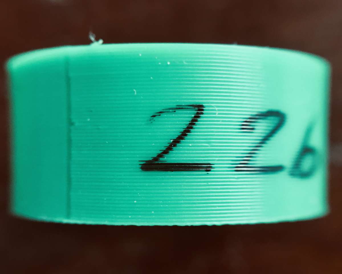

                    I’m not sure how best to interpret this, so I will just share the raw data for a start
                    All the test pieces have a decent finish with only slight surface texture
                    There is probably some slight ovality, but I have not attempted to measure it
                    Each value represents just one measurement with a digital caliper
                    … therefore please don’t take the implied accuracy too seriously.
                    Posture
                    The crucial point, of course, is that the 0.4 nozzle cannot produce very thin walls … and my test was done to see how the printer worked-around that impossible task.
                    Excuse the colour-cast:
                    IMG_0804

                        #799298
                          < sigh >
                          Here [hopefully] is a downsized version of the previously submitted image:
                          Posture
                          Just to show the nice tidy layers.
                          #799302
                            That one shows up OK as for the rest the thread title seems quite appropriate!

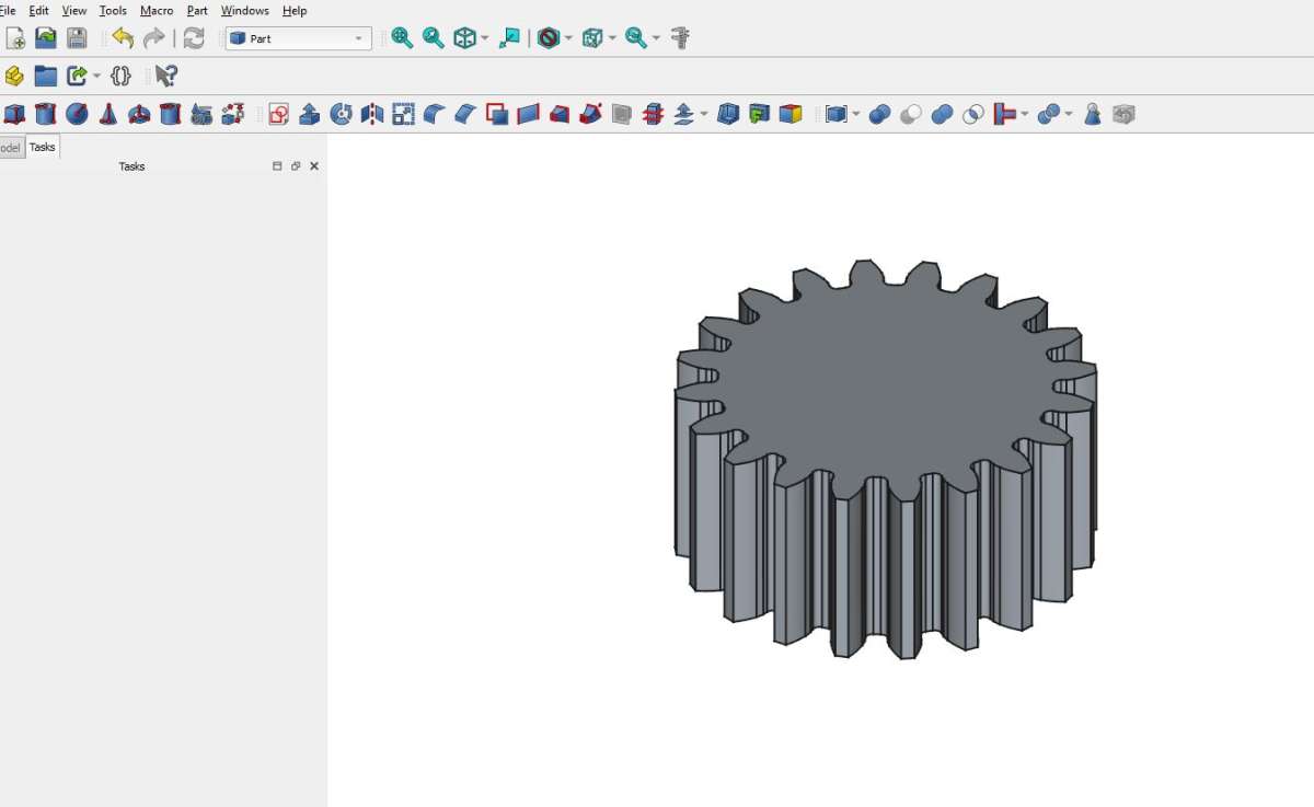

                                    #800099
                                      Thats a bit long winded. Stick with the FreeCAd you have and there is a gear generator in that, should take less that 60seconds to create a gear
                                      gear5
                                      #800107
