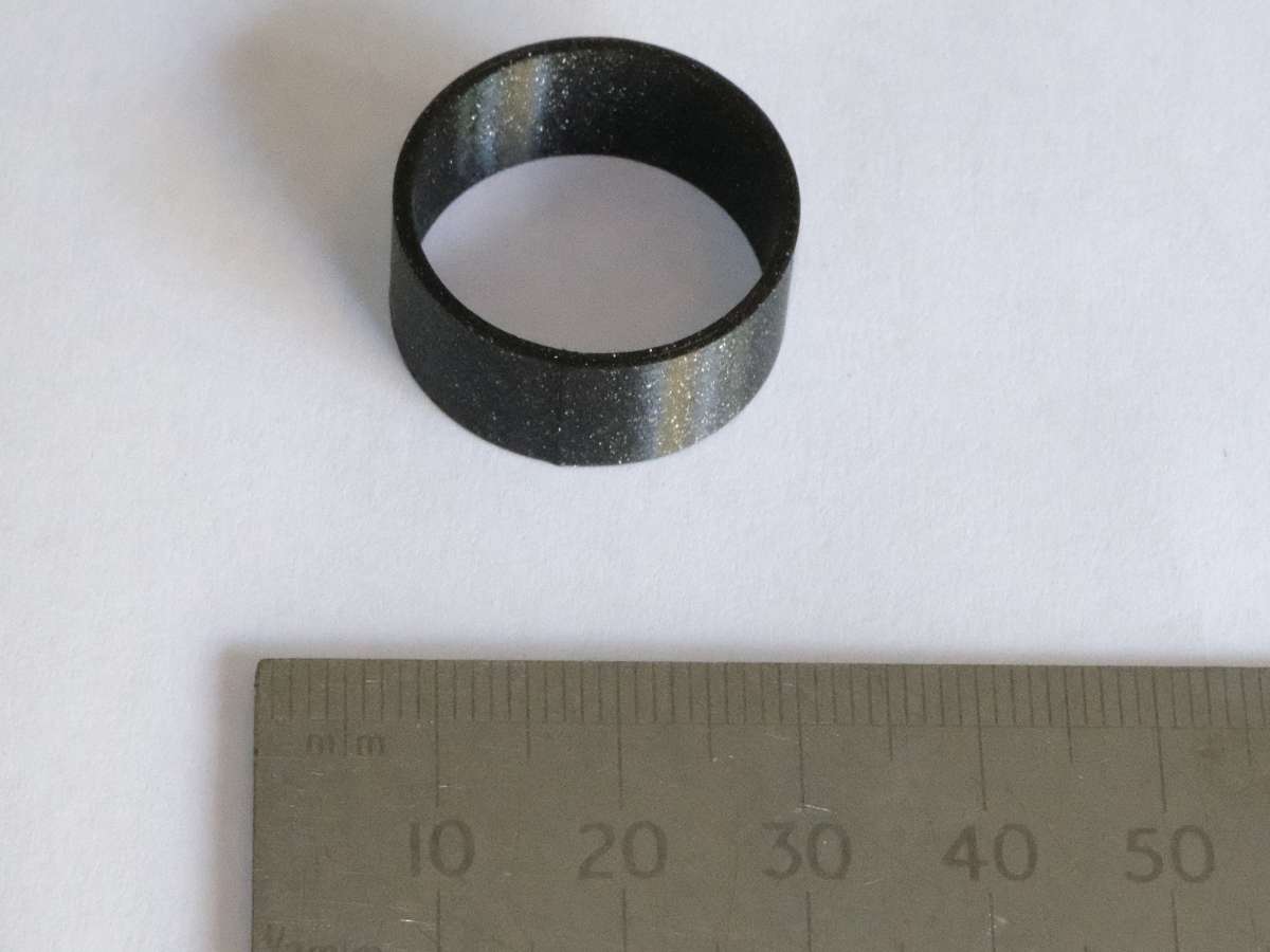

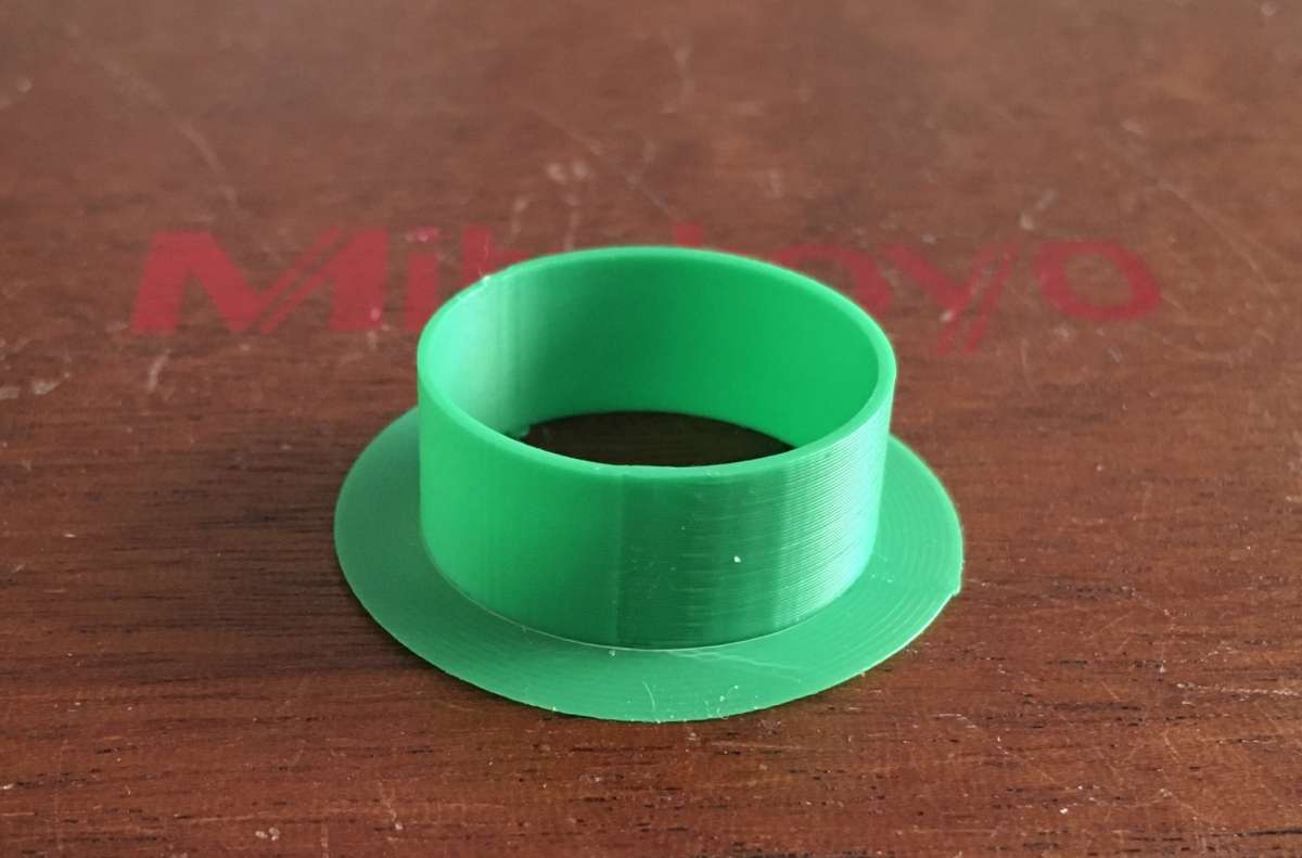

      I did a little test with the Bambu Lab P1S this morning
      Drew a simple tube in FreeCAD
      O.D. = 23.2mm
      I.D. =22.2mm
      Length = 10mm
      printed it [0.4mm nozzle, PLA filament] with a suitable 5mm ‘Brim’ for adhesion to the plate, and everything worked fine except, of course, for those diameters.
      A rough check with the Mitutoyo Caliper gave
      O.D. = 23.44mm
      I.D. = 22.14mm
      Surface finish is not bad at all, but clearly an “allowance” will need to be made to home-in on target dimensions.
      Is this predictable [in the sense of being calculable] or just a matter of inspired guesswork ?
      IMG_0793

        Hi Michael,
        I also have a P1S, I’m sure there is a calibration setting on these machines but I’ve never used it but may be worth investigating also a calibration cube for fine tuning dimensions? I have printed only PLA atm , door shut, 31% humidity and sizes are say +/- .02 so I’m lucky.
        You should be able to get much closer to target dimensions without guessing, I just Googled ‘bambu lab p1s dimensional accuracy’ and there is shall we say an abundance of information that you can trawl though, I’m finding this with 3D printing , there is perhaps too much information, some of it conflicting.
        Good luck, and let us know how you get on!
        PS that is quite a thin walled tube, try a solid cube
        Tony

            #798563
              On Julie Ann Said:
              […] Try a design with a wall thickness of 1.2mm and see what the measurements are.
              Julie
              Good suggestion, Julie
              … I will try that this afternoon, and report back
              P.S. __ am I being dim ? … I did have a bad night’s sleep
              23.2 minus 22.2 was intended to produce 0.5mm wall thickness

                  Bazyle
                    @bazyle
                    Consider designing in relation to how it is made. While it is sensible to help it out with lines that are multiples of the nozzle dia also think about what happens in extruding the goo out of the hole – it spreads out. So then maybe multiples of hole dia are not so good, Think about how you would design the slicer software to cope. It might be interesting to make a test simple straight wall of different thinknesses.
                    Meanwhile you have first the accuracy of the mechanical movement to calibrate first, then the shrinkage which will be different in x,y, and z and also affected by geometry eg edges and middle of the test cube because of the orientation of the filament laying.
                    I was lucky, my first ever print, a changewheel, was withing a couple of thou and fitted its shaft perfectly.

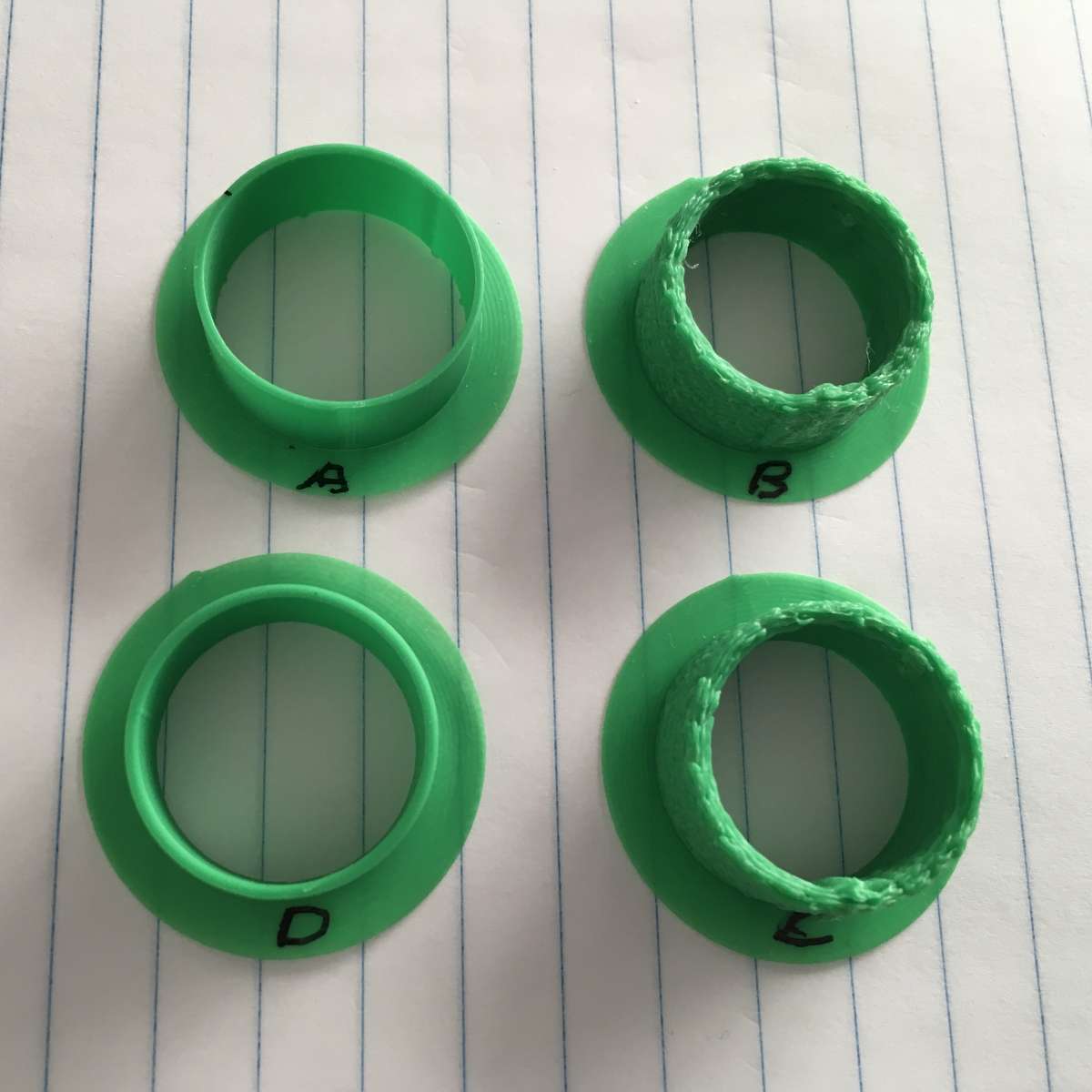

                      Oh dear … now we have an interesting puzzle:
                      Following Julie’s admirable suggestion, I decreased the ‘Pocket’ [i.e. the bore of my tube] from 22.2mm to 20.8mm … to give a nominal 1.2mm wall thickness
                      The print was a disaster; so I printed another, with almost identical result.
                      I then changed the ‘Pocket’ diameter back to 22.2mm and printed another thin-wall version.
                      In chronological order, we have A, B, C, D
                      A and D are of quite acceptable quality
                      B and C are utterly useless.
                      The FreeCAD file was saved and exported with the same name[s] at each step
                      The Slicer was “happy” at every stage, and the Bambu reported “print success” for each run.
                      It looks like a resonance/chatter problem to me … but your considered opinions and wild guesses are welcome.
                      Note: any apparent size discrepancy within the pairs is an artefact of using a wide-angle lens … they are actually quite well-matched.

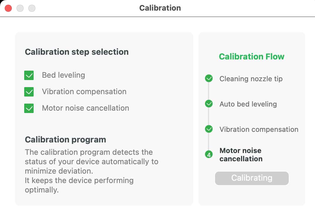

                        I have just let the printer start its self-calibration routine.
                        … meanwhile I shall have strong black Coffee !
                        #798601
                          Screenshot 2025-05-18 at 17.07.54
                          #798609
                            Well … It looks like something must have “settled” for want of a better term.
                            Following that calibration-run I have just started what will be a set of tubes … all will be 23.2mm O.D. but the bores will run from 22.0 upwards in 0.2mm increments.
                            The first one looks excellent !
                            #798616

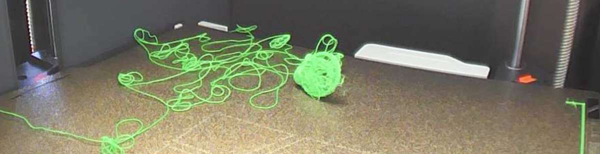

                                                    Not happy at all with my [lack of] progress today … I has intended to complete print the full set of my samples, and have so far had:
                                                    • network connection problems
                                                    • a firmware update
                                                    • another of those raggedy mis-prints
                                                    • an adhesion failure
                                                    … Grrr!!
                                                    I have just let the printer go through its calibration routine again, and am hoping for a little more success before the day is out.
                                                    Edit: make that two adhesion failures !
                                                    I missed this one whilst I was typing the above 🙁
