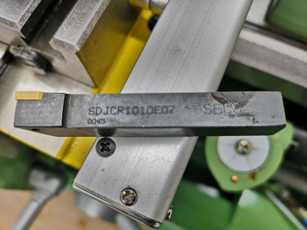

                        Well, I was a brave boy today. Got most of the reachable gunge off the 290's bed, ways and slides and oiled them with the stuff that Warco sells, the gears done with 3 in1 white Lithium spray. I stuck a 2 foot length of chromed steel roller (dunno where I got it) in the chuck, completely unsupported, to do another twist/parallel test and there was hardly a flicker on the dial either a few inches from the headstock or just shy of the tailstock centre so I reckon I got the base pedestals pretty well aligned.
                        Next step, give it some electricery after sticking a short piece of iron in the chuck. That's when I hit a problem. The DRO lit up nicely and zeroed/shifted with X and Y movement as it should. However when I tried to fire up the motor I got nothing. Now I've twice removed the gear cover – once to transport it to the shed and again to grease the gears. Both times I had an awful job refitting it and now I know what caused the issue. The horrible little forked blade thing attached to the cover is supposed to engage into a slot in the motor interlock switch thingy but it was dangling loose on all four m3 fixings so wouldn't engage properly. It's impossible to position it accurately so I got lucky with a guesstimate and at last I had motion. A momentous occasion for me. I got real scared at 2000 rpm and eased it back down to 60. It did seem eerily quiet whizzing away like that.
                        Obviously I couldn't wait any longer to make my first incision so I hunted for the 60-30 degree indexable 8mm tool an old engineer gifted me and tried to set it in the toolpost. Of course it was way too far below centre so I spent the next ten or more minutes searching for some packing pieces. None to be found as I'm really not geared up yet. So it was that in utter frustration I headed for the PC and immediately ordered a QCTP from ArcEuroTrade – and it was in stock! Now I just have to hope the ARC reindeer aren't too slow before the family descends for Krizzy!
                        Prepare for some very newbie-type questions about the EASIEST way to fit the BXA toolpost.

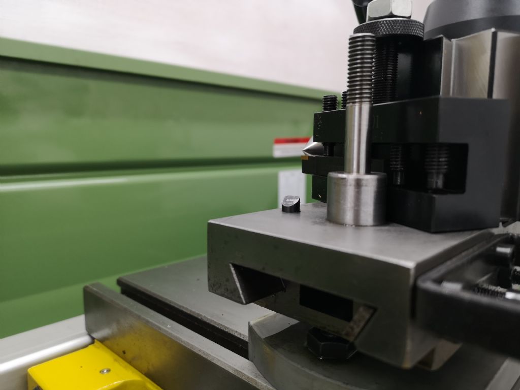

                                      Okydoke, I think I can maybe offer what will probably be my single ever useful contribution to this Forum. I have just stood the BXA/250-222 QCTP on the top slide of my Warco WM290V lathe and can confirm without a shadow of a doubt that it DOES indeed fit this machine. The only tool I have is the one in the photo below, a 10mm square indexable type given by a friend to get me started. With the toolholder set to its lowest position on the post there is still a 3 to 4mm gap between the tip of the carbide bit and the tip of the tailstock centre. I call this a win and I still haven't seen it stated as a definitive Yeah or Nay for this lathe and others like it so I'd like to make it so now. (with the usual disclaimers!!!). But pictures don't lie and this has NOT been Photoshopped!

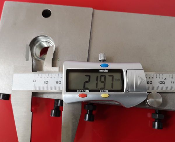

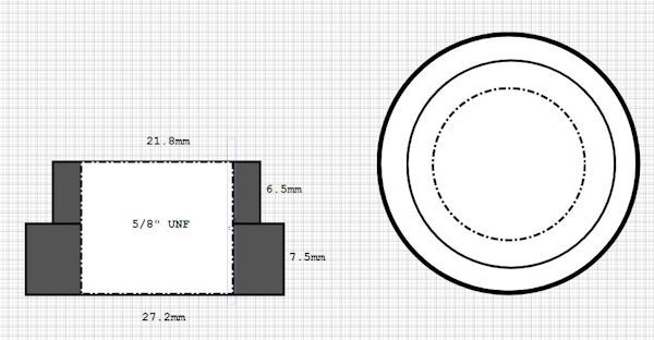

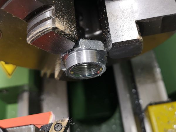

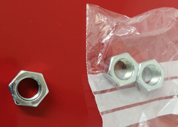

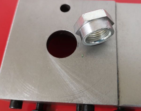

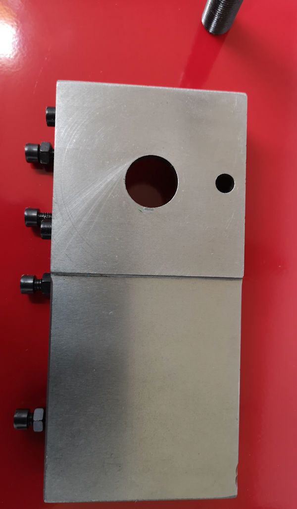

                                        Well after a miserable 5 or 6 weeks housebound with some awful ailment the shed was the last place I fancied but I took ther plunge today whan another little parcel popped through the letterbox.

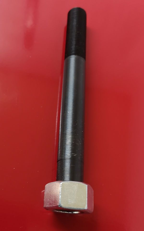

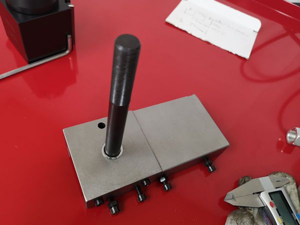

                                        You'd be forgiven for thinking "it's a nut". What it is, is my proposed solution to the Aloris-type Qucik Change Toolpost mounting issue. Now you must realise I'm a poor welder but a better welder than a turner so I percieved a much easier solution than any I've seen on Googaloo. So I bought a couple (just in case!) of 5/8" UNF nuts after carefully checking the central BXA toolpost thread and squiggled a quick drawing.
                                        This from measuring the cross-slide after removal advice from JasonB, although on my 290V the bolt plus the lower boss popped out as one after a few hammer taps. So, to my first turning job:

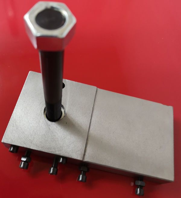

                                        I left the nut tightly screwed onto the BXA bolt for easier holding, scared silly!

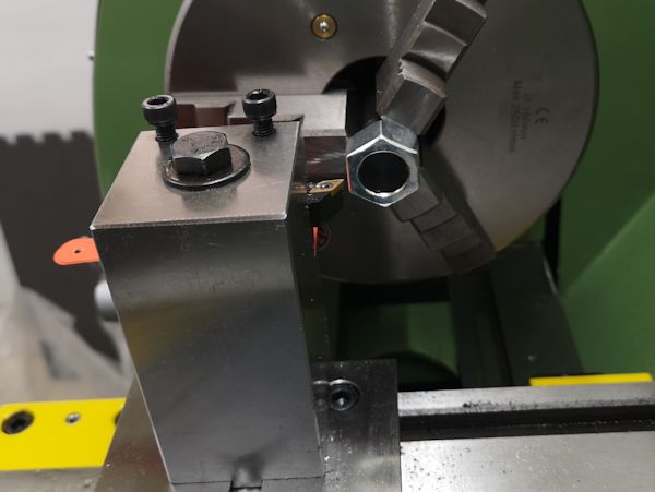

                                        I think this is as close as I ever want to be to the chuck!

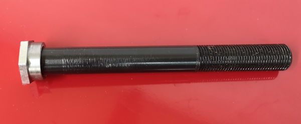

                                        The almost finished article:
                                        Looks like success first time.

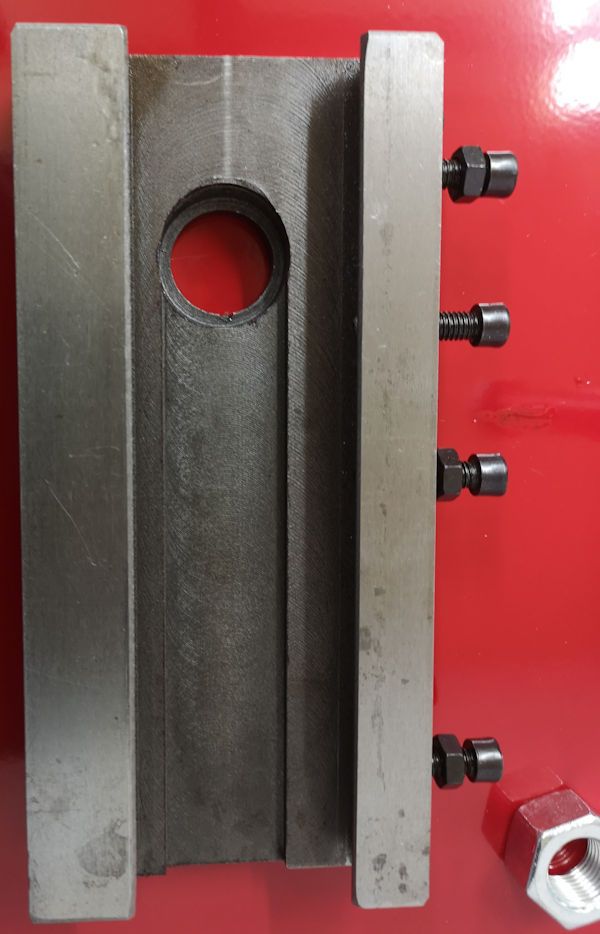

                                        Not quite! I hadn't accounted for the nut which the top slide leadsrew runs in, it projects into the cavity below, so I had to reduce the lower hex section of the adaptor to about 4mm thick:

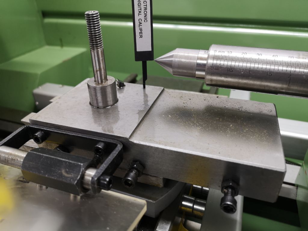

                                        Here it is tapped snugly home:

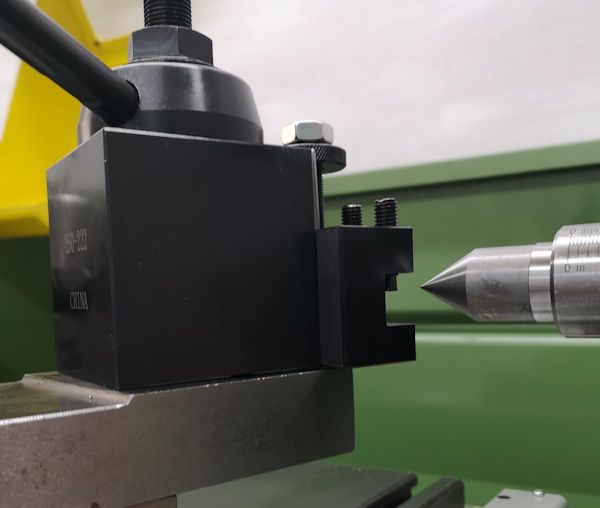

                                        And this is the 12 or 13mm gap I have from the underside of the toolholders to centre, well pleased with that and may be able to use 16mm tools although I'll settle for 12.
                                        As you see a bit of sideways thinking here but some of the more regular solutions offered scared me rigid as a total newbie. Now I can maybe turn something!
                                        Thanks to everyone on here for the help and advice and may I wish you all a very happy New Year.
