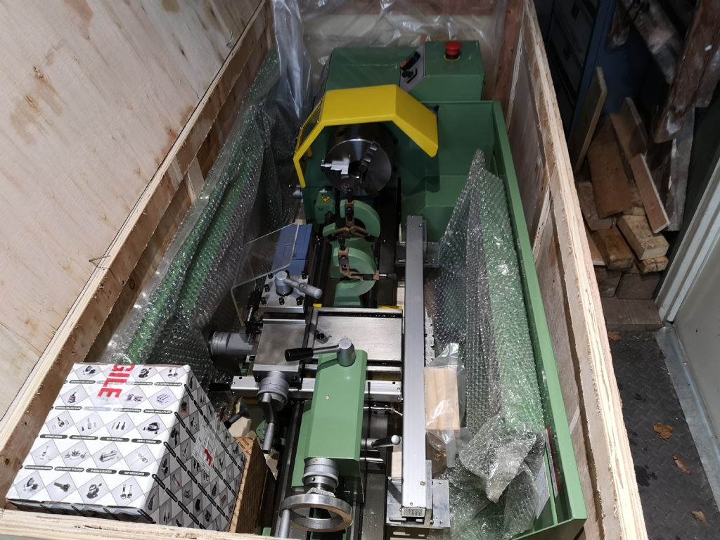

                  Now I'm really scared! The boat docked last week and today Warco had it presented to me on a platter, er I mean pallet. It just about fit in what's left of my so-called garage. All I can say is Wow! Unfortunately I'm about half way through a flu-like living hell (had my jab so no complaints there) and the last thing I fancy doing is spending time outside in the cold so it will have to wait. At least I can now satisfy my curiosity about the sizes of AXA, BXA and CXA toolposts and potentially order the right one, assuming I measure correctly.

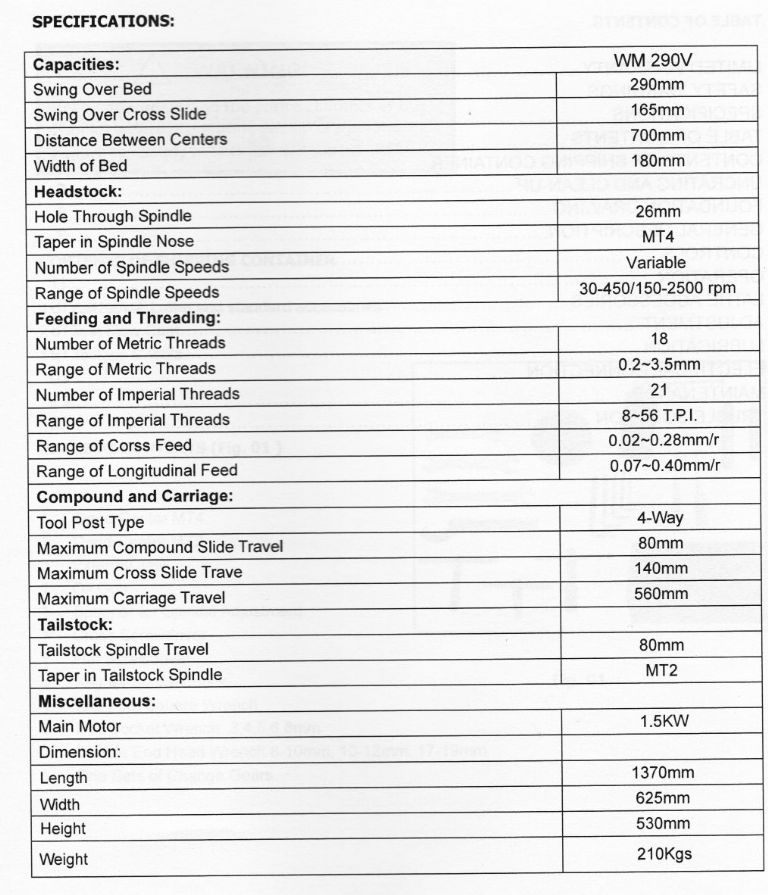

                                        I managed to retrieve the manual and test paperwork from the bottom of the coffin yesterday, still preparing the base for the 290V so can't lift it out yet.
                                        However, on reading said manual there are several discrepancies which hit me immediately and have me slightly worried. Take a look. First is from the included Warco manual:-

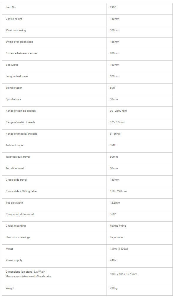

                                        And this from their web site – obviously the one that persuaded me to go for the 290:-
                                        There are some BIG and worrying differences here in taper sizes, travel, swing, spindle bore etc.. Can anyone put my mind at rest before I do take it out of the crate in case it needs to go back?

                                        #385768
                                          have you had a look up the bore, expect it is 38mm and that needs MT5.
                                          My 280 manual says I have a MT2 tailstock but it is MT3

                                                The 290V is quoted as weighing 210Kg, and the 290 as 230 Kg. A larger mandrel, and probably bigger roller bearings, may explain the difference.
                                                If it has a 5MT mandrel, I hope that a 5MT- 3MT reducer comes as part of the package.
                                                Similarly, if it does turn out to be a 4MT, a reducing sleeve will be needed at some stage.

                                                    So, just been back in the box. Tony it's good news! There is indeed a gaping hole through the chuck just as the web version of the description claims, it swallows a 36mm fork leg. I'm now trying to shrink the thing for the lift to the shed. Got the chuck, tailstock, follow rest and steady rest off so only the compound slide to go. Don't want to attempt loosening anything else as there are scary DRO cables and stuff everywhere. If I was giving a layman's visual assessment of the whole thing I'd have to say it looks stunning. In order to get it through two 2'9" doors with a big lad at each corner I'm going to have to remove the backplate too but that should lose a few more kilos.

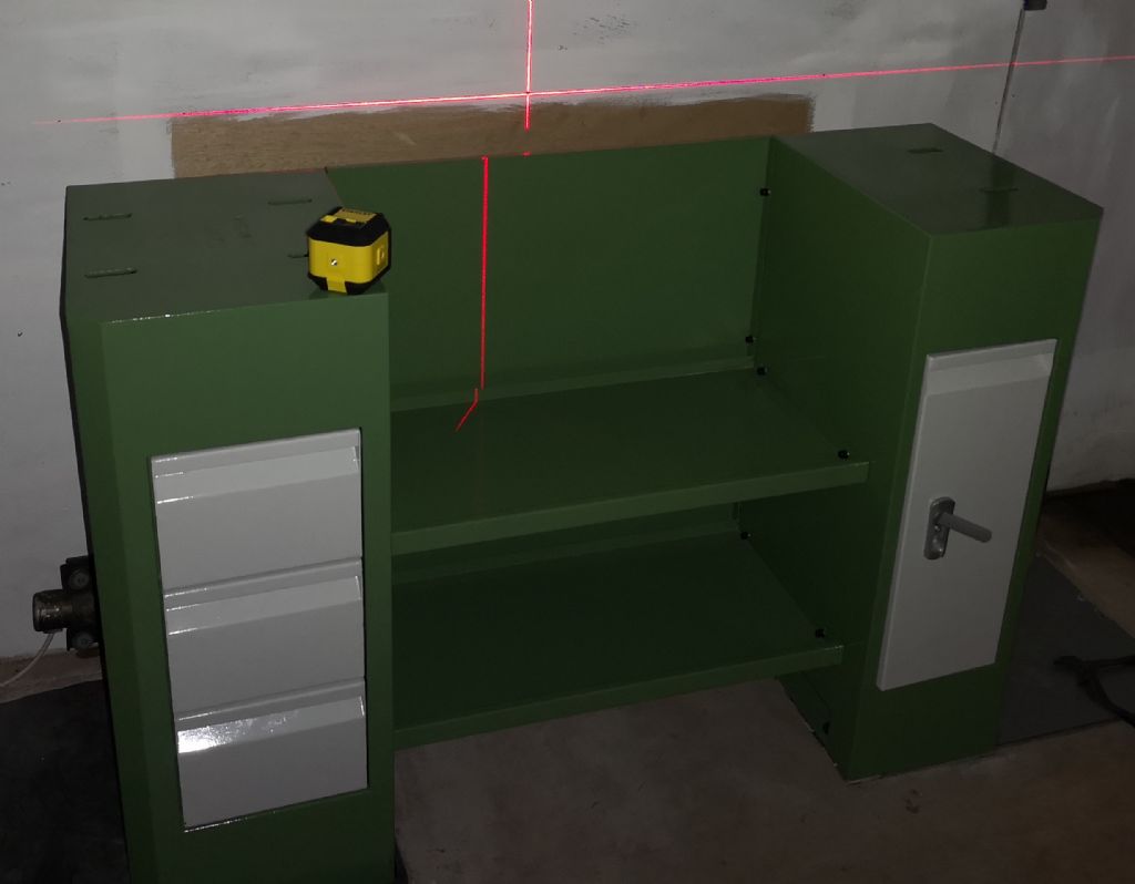

                                                    Just a note here – I got a cheap Stanley laser level to finish setting up the stand and what a boon that thing is.

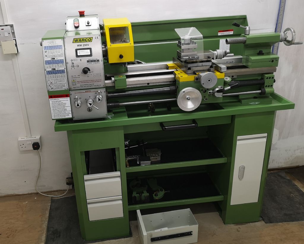

                                                      Well, it's in. Took five of us 75 minutes of hard graft this evening. Now the real newbie questions will start flying in to you wise old heads. If I can shake free of babysitting duties later tomorrow I'll see if I can check the bed for twist. It'll be a miracle if there's none at all as the floor of the crate was barely supported by the pallet below right at back left corner where the leftmost fixing hole is and the crate floor (20mm ply or blockboard) was visibly bowed at that end (headstock) when I took the end panels off it.
