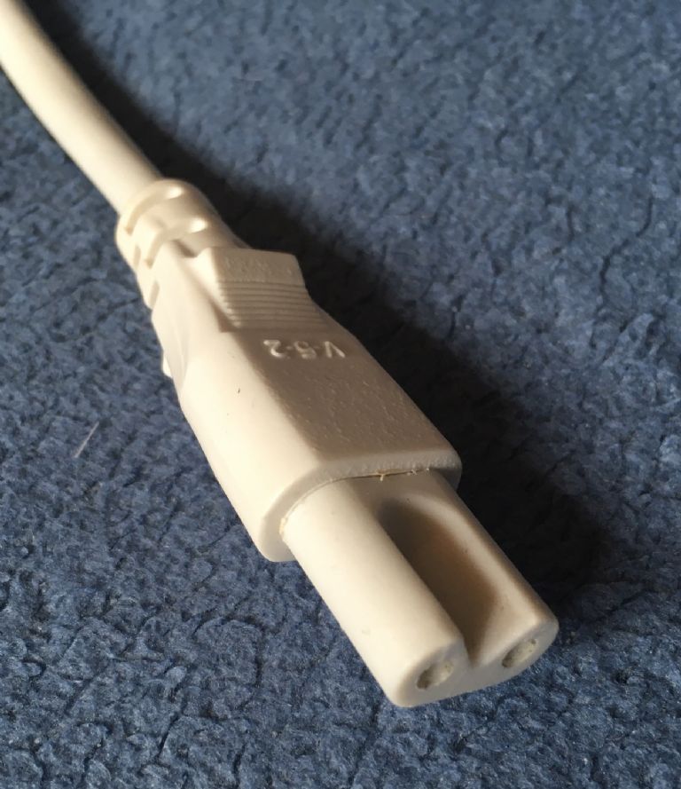

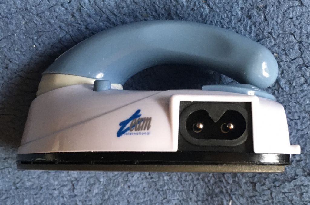

        My wife has a tiny ‘travel iron’ which she uses for pressing patchwork details
        Unfortunately, this has a ridiculously heavy and stiff mains cable, with a poorly-fitting connector.

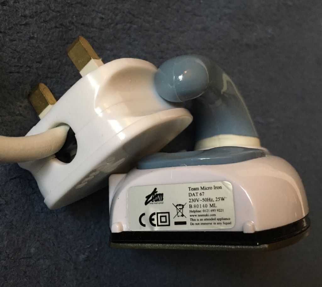

        The iron is only rated at 25W
        Does anyone recognise V-5-2 … and is there anywhere I can buy one with a nice flexible lead [or is there even a rewire-able version] ?

          Looks very much the same as the charging lead on my Karcher window vac, but of course that's only low voltage. Is there any chance a standard figure of 8 lead would fit? I think they are called C7.

            That's one I've never seen before!
            There are many similar ones, but the 'V' shaped notch is unusual. I would be tempted, because its low wattage, to find something like an old electric shaver lead and trim the moulding to suit the iron recess. Obviously the spacing and pin diameter need to be in the right ball-park.
            Is the iron marked as double insulated? it should be really.

              Not as it stands, Phil … The vee is quite pronounced
              Thanks for the thought though.

                  Yes … marked as double insulated yes

                      Re 'milling machine' above. What about a Dremel on the recess of the iron?
                      A polarised connector is not needed so removing the whole male part of the V will not matter, Again, pin spacing and diameter on whatever lead you can find will determine what is possible.

                        My guess would be that the cable is stiff because it is a hot condition type, and perhaps that is why the non-standard connector is used (like the difference between a computer "kettle lead" and a real kettle lead.
                        Having said that, this non-reversible connector looks similar, but without a drawing or clearer photo (from the supplier, not Michael) it is hard to tell.
                        Type C52 connector

                          Michael, what size is it compared to a Figure of 8?
                          In the past, I've modified a C7 connector with a Dremmel and a round burr.

                            It's easily small enough to do on the BCA … just more faff than I was hoping for

                              Thanks, Bill … but that’s where I started my quest
                              Drew a blank, so came to the forum
                              Pin diameter and spacing looks identical to the typical fig 8 connectors … but I will check more carefully.
                              I suspect that the ‘special High Temperature version’ may be the gotcha

                                The lead is probably stiff because it is cheap and nasty heat resistant cable. The connector is non-standard. This is because you should not be able to use a non heat resistant cable on a heating device ( hence difference between C13 computer leads and C15 kettle leads). Using a different lead by modifying it or the iron will reduce its safety.
                                A bigger concern is the sole plate of the iron appears to be metallic This would almost certainly need a 3 core earthed connection. I would bin it and by a travel iron from a reptutable manufacturer. While this one does have a CE mark, the label is clearly not compliant and the website does not exist.

                                  Bin it and look for a known brand. As already mentioned, the metal soleplate must be earthed.

                                    Not allowed to bin it … it says so on the label

                                      Just for interest, the UK company importing them from India went bust a few years ago
                                      https://www.thegazette.co.uk/notice/2936066
                                      The web address used to be correct, according to the Internet Archive.
                                      https://web.archive.org/web/20161028211527/http://www.teamuki.com/index.php?route=common/home
                                      And you can still import them yourself if you wish, direct from India, but I guess only by the pallet load, and I'm not sure about electrical certification.
                                      https://www.indiamart.com/proddetail/micro-iron-4590020473.html

                                          HP used to use them at one time. I had to get a non polarised plug and grind a slot into it.

                                            For what it’s worth … the cheap and nasty cable is branded KEMA-KEUR and proudly carries its details
                                            … too much information to be worth quoting here; except to mention that the conductors are each.0.75mm^2, which is rather hefty for 25W
                                            **LINK** https://www.dekra.com.cn/en/cables-and-wiring/
                                            The cable is dated 1997, and the product was supplied by ‘Comet’

                                            The box states that it uses “PTC technology” and works on 100V to 250V”
                                            … this may, or may not, also imply that the soleplate is adequately insulated from the electrics

                                              OK don't bin it, "dispose of in a legal and environmentally friendly manner" with extreme prejudice devil
                                              Being PTC based means it will maintain temperature but is no indication of the quality of insulation, It is very difficult / expensive to achive good thermal conductivity and the electrical insulation, including creapage and clearance, required for a class II (double insulated) appliance. I would be VERY suroised if this iron met the required safety standards. it is cheaper to use an earth wire. This was probably designed for 100 /115V
                                              The UK importer probably went of of business so they didn't have to give refunds. Several of the items on the archived webpage clearly would not meet european safety standards e.g. 2 bar electric fire.

                                                The closest I can come to this is a MacBook Charger extension.
                                                **LINK**
                                                  Well-spotted, Martin
                                                  The vee is bigger on the iron lead, but it does fit the charger
                                                  Pin diameter & spacing match, and the body is the same size. yes
                                                  Unfortunately, they don’t fit vice-versa … and, of course, the Mac leads are bulky anyway.
                                                  Definitely the nearest yet.

                                                    Looks a bit like my shaver lead. + my hair clippers.
