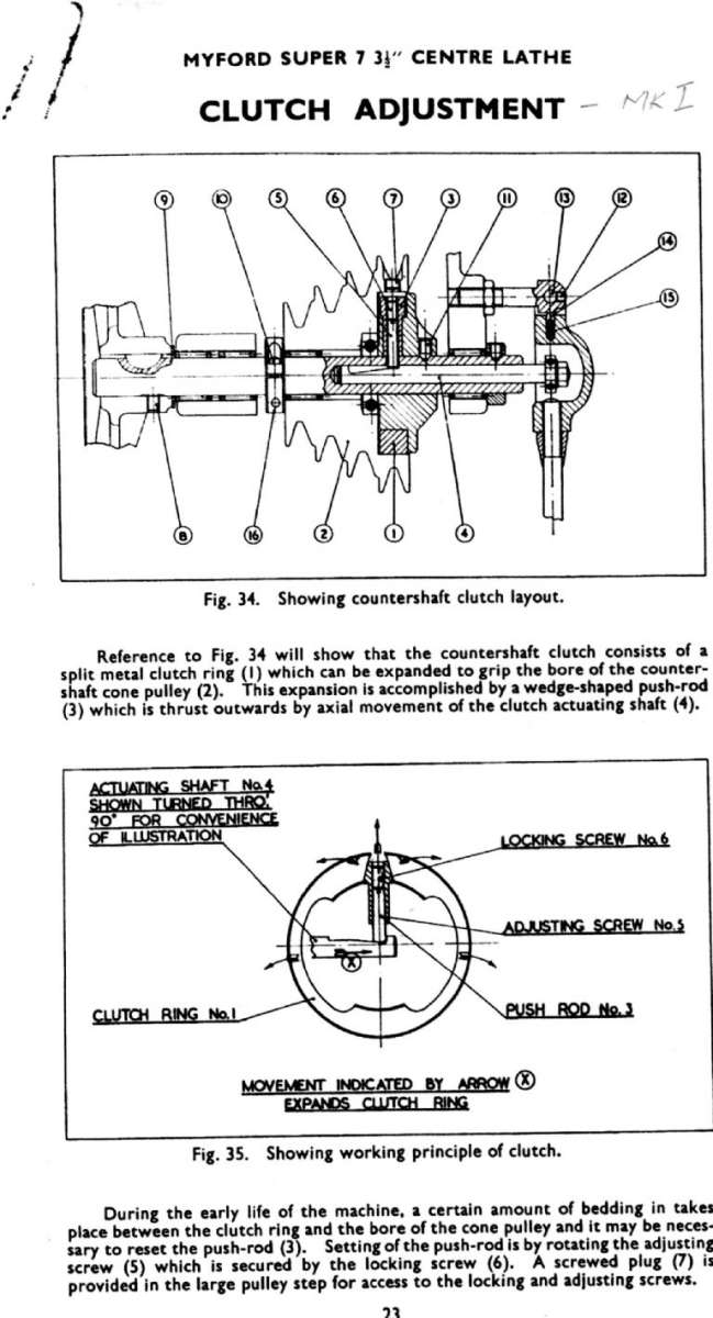

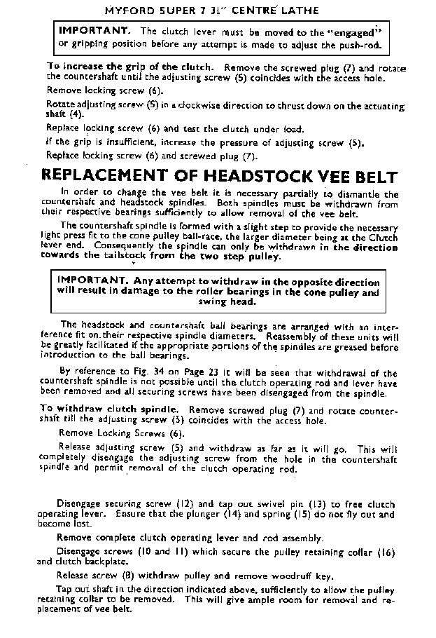

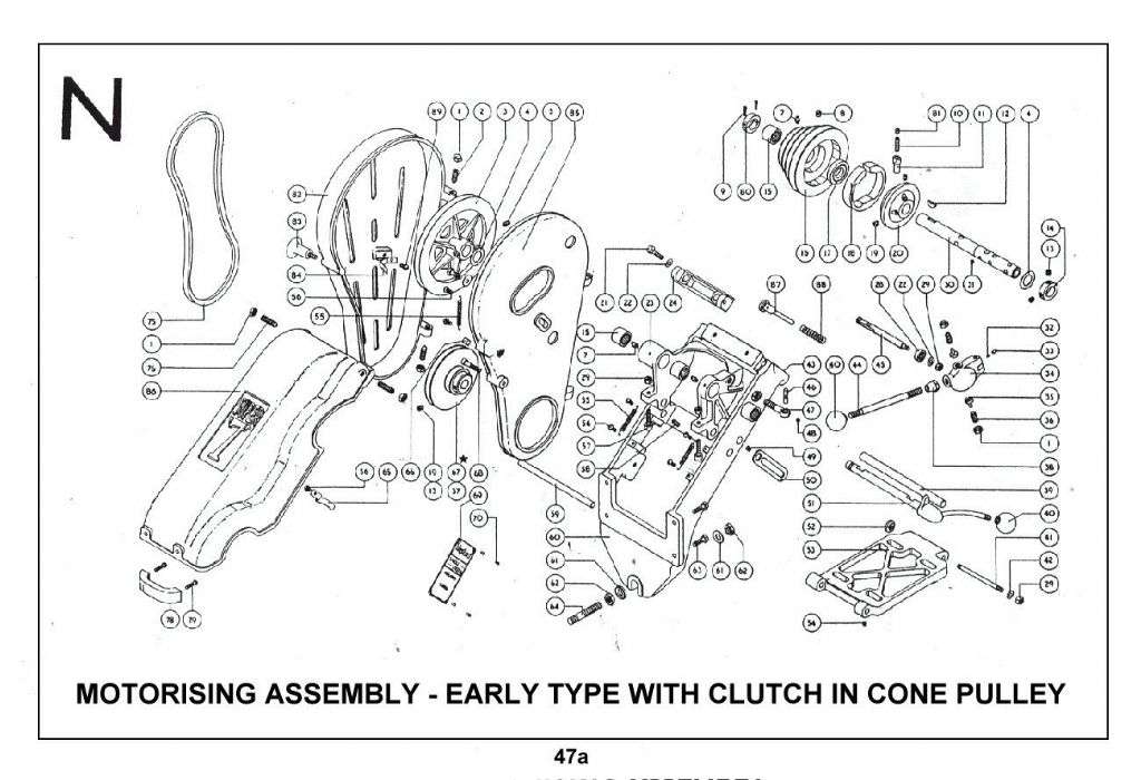

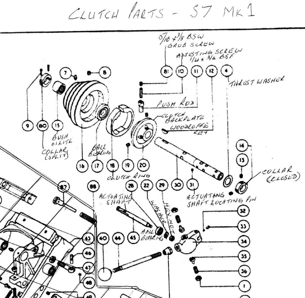

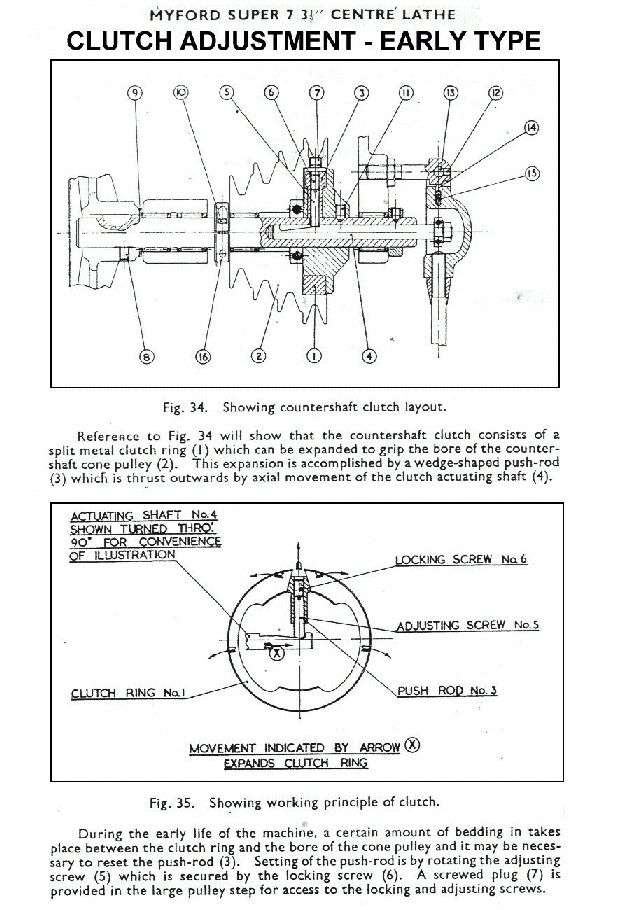

          Grindstone Cowboy
            @grindstonecowboy
            If it’s the early model, the clutch is the horseshoe shaped cast iron one. But it sounds like it’s the belt tensioning lever that the OP is talking about, not the clutch (he just mentioned that to stress the age of the machine?)
            If it is clutch adjustment you want, I have some pictures I can post – I think I got them off this forum originally.
            Rob
            #829142
            Grindstone Cowboy
              @grindstonecowboy
              I’ll post them anyway, they probably got lost when we switched to the new forum software.
              Rob
              S7 Early Clutch adjustS7 Early Clutch textS7 Early ClutchS7 a Early ClutchS7 b Early Clutch
