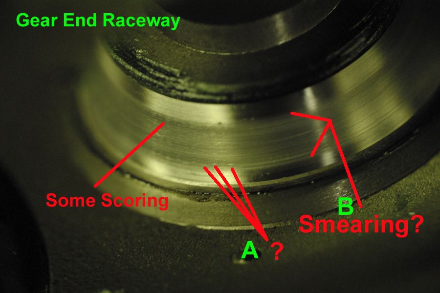

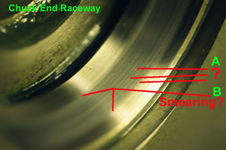

                  The headstock is now dismantled. The spindle appears to be in very good condition. However, I will still have my machinist friend thoroughly check it out. After removing the bearings from the spindle, I pushed each into their raceway and turned them by hand. The gear end bearing appeared to move freely while the chuck end bearing seemed to have a rough spot in its rotation. I will be replacing both. Both bearing raceways are less than favorable. The bubbly things shown at "A" in the photos below are a puzzlement. I could not see these through a 10X lens. However, when I took the photo I used a Marumi variable neutral density filter on my 50 mm macro lens. The filter was set somewhere between ND 4 and ND 6. The added contrast from the filter sure made these things stand out. I would welcome any suggestions as to what these are. The smearing(?) and scoring I believe can be attributed to too much torque applied to the lock nut by the previous owner. It may also be the result of a heavy handed knurling technique. I had to use an extension on the 1 1/2 " tommy bar (mild steel bolt) that I used to remove the lock nut. It had to be forcefully backed off for the entire length of the thread resulting in a bent tommy bar. I believe the lock nut threads were stretched by excessive torque. After mounting the spindle in a padded vice, I used the tommy bar to thread the lock nut on and off several dozen times until it moved freely with moderate finger pressure.

                    Thank you. In your opinion, would replacing the prescribed bearings with sealed bearings result in any appreciable advantage or disadvantage?
                    Bill
                    #142171
                    blowlamp
                      @blowlamp
                      It might make sense to set your spindle between centres and check the runout before you fit new bearings and start to reassemble.
                      I would replace the bearings with like for like if the spindle proves to be OK.
                      Martin.
                      #142196
                      “Bill Hancox”
                        @billhancox
                        Just back from my semi-retired friend's home machine shop. He mounted my spindle in his lathe and the runout was less than .001. Whew!! I saved significant coin of the realm there. I fully agree with the words of wisdom from Martin and Gray. I will order the bearings in accordance with the Myford specification. Time to fabricate a race way removal tool….. Now where did I leave my spectacles? (They say as you grow older the mind is the second thing to go. I wonder what they mean by that.)
