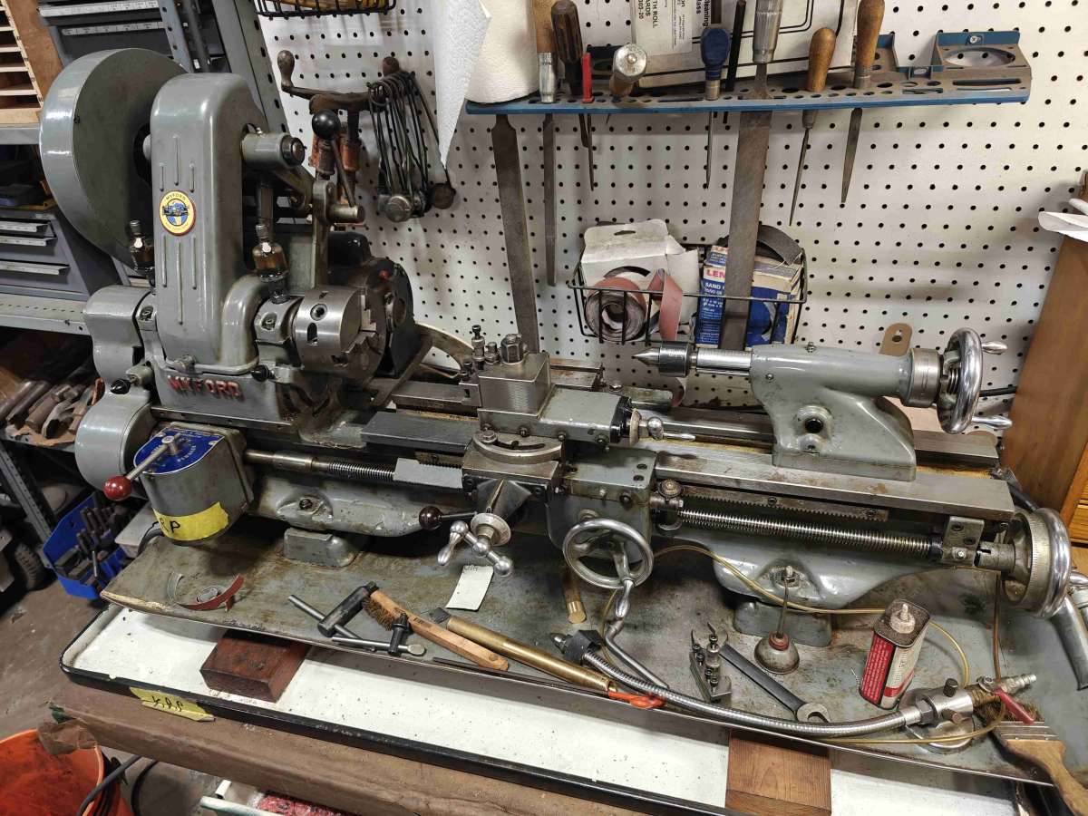

      Hello, all. I volunteer in the workshop at a large museum here in the US. In the shop we have several lathes, one of which is a nice little Myford ML7, well kitted out with many accessories. It has 3 and 6 jaw chucks, steady rest, collets, live centers, drill chucks and a milling attachment. One thing it does not seem to have is an appropriate oiler for the Lumatic HDFV4/45 fittings. I found that someone had attempted to use a grease gun on these fittings, as if they were Zerk grease nipples. (RTFM!). Can anyone provide some pointers on how to find/make an oiler for this lathe, particularly here in the US, where the ML7 is not all that common.
      Also, one accessory this lathe does not have is a quick-change gearbox. I find the instructions in the manual for changing the gears for the lead screw to match a thread pitch to be cryptic at best. Are the gears marked or do you have to count the teeth? I’ve been reluctant to take it apart until I understood the instructions a little better.
      Thanks in advance! And please forgive me if this is not the correct forum.
      v/r Don Newcomb

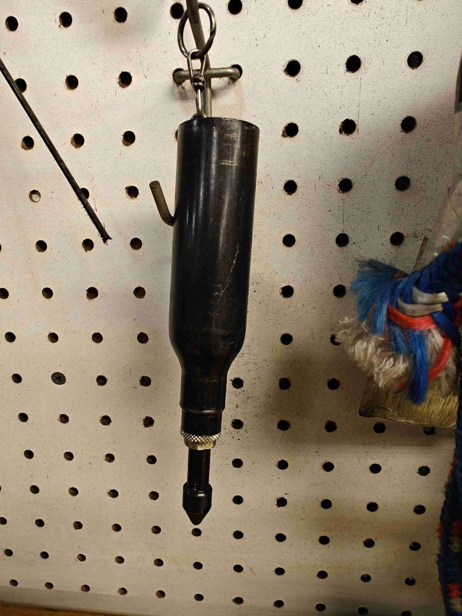

      P.S. I’m attaching photos of the ML7 and a strange oiler that seems to not quite work for the oil fitting but seems to have come with the ML7.
      P.ML7ML7_oiler

        Welcome to the forum. If you search on here for myford oiler or oil gun you fill find plenty of information and opinions. The oller you have is typical of those intended for the Myford fittings. IMHO these never worked well. A thin piece of rubber sheet with a small hole in it placed between the gun and fitting helps.

          Hello and welcome. Yes this the appropriiate place to ask!
          Your lathe does have proper oilers for the headstock bearings so that is a blessing!
          I lubricate the ways on my ML7 by cleaning them thoroughly with paper towels (kitchen wipes), puddling oil on the flat surfaces them winding the slides back over that. Not ideal but it seems to work.
          I agree the diagram in the handbook is not ever so clear, but you should never need count wheel teeth because the proper change-wheels are marked with their tooth-counts. (As for any lathe with change-wheels rather than gearbox.)
          When setting up a compound change-wheel train the two middle gears are connected by the keyed sleeve on the peg on which they revolve together.
          The basic principle is [Driven/Driver = TPI/LS]
          where the –
          Driver and Driven are the tooth-counts of the gearing you need set up,
          LS the Leadscrew (8TPI on the Myford)
          TPI the turns count of the intended thread. That should never be coarser than the leadscrew, when driven conventionally, to avoid excess stress on the lathe. Even an 8tpi thread is quite heavy work for it.
          Some sources quote the algebra the other way round: Driver/Driven, etc..
          E.g. 60T wheel on the leadscrew / 30T driven by the tumbler gear, with an intervening idler of any convenient size to connect them and maintain the same direction, will give a 2:1 ratio so we now cut a thread of (2 X 8) = 16TPI (Which I see from my tables, is 3/4″ UNF and 3/8″ UNC.)
          When you can’t obtain a direct single-stage ratio like that, the idler is replaced by a pair of wheels keyed together, and smaller wheel or a sleeve placed on the leadscrew end to put its wheel into mesh with the output wheel of that intervening pair.
          There is, or should be, a table on the inside wall of the change-wheel guard to give the change-wheels for a very wide range of inch, and some metric, pitches with the standard change-wheel set. The latter might be approximations that become difficult over more than perhaps 10 or 20 turns.
          A tip when setting the change-wheels in mesh. To avoid undue stress and wear they should not be tight together. Put a strip of ordinary, thin printing paper between them as a spacer; hold the assembly together while tightening the banjo screws then manually rotate the lathe to wind the paper out. This gives a clearance of typically 0.003″.
          I see your lathe does have its thread dial indicator. That should be put into mesh with the leadscrew only for screw-cutting. Otherwise swing it back a little clear of the screw.
          I have a note pinned up behind the lathe to remind me how to use that indicator for given TPI multiples!
          There may be plenty who will come here advocating replacing change-wheels or gearboxes on even the simplest lathes with electronic leadscrews, but unless your lathe has neither of these it would seem a drastic solution to a simple problem. Unless you spend every day cutting umpteen screws of all sorts of different pitches – or are converting the lathe to CNC operation anyway!
          A friend told me he reverted his gearbox-fitted Myford ML7 to change-wheels because it gives him wider range of pitches, particularly allowing metric as well as inch-based ones. He said he does not find it any less convenient to use change-wheels instead of gear-box.

                Re the oil gun, I still use two of the old fashioned push grease/oil guns; mine are Tecalemit, but I’ve replaced the end nozzle on the one I use for oil nipples.
                In your case you have the proper ML7 oilers for the 32 weight hydraulic oil for the headstock; I use 68 slideway oil elsewhere.
                One dodge is to use a layer of paper towel between the gun and the nipple, which act as a single use gasket.
                Replacing the hard nozzle with a nylon one self seals fine without leaking in use.

                    You can buy a good oil gun that works and does not leak from pressparts.com
                    Used on printing presses apparently. Not cheap, but good.
                    Or you can machine down the tapered brass nozzle on a common flexible spouted oil can so it fits into the tiny hole in the oil fitting . Pump pressure will push oil in past the ball.

                            The standard Myford oil gun lubricated me, and everything else! So I bought a Reilang, which fitted the ball oilers perfectly.
                            There are probably others which are as effective in sealing to the oilers.

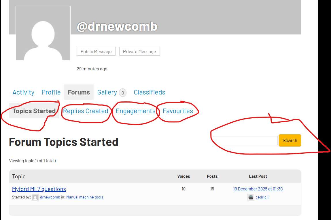

                                4. For the life of my I can’t seem to find the search function for this forum.

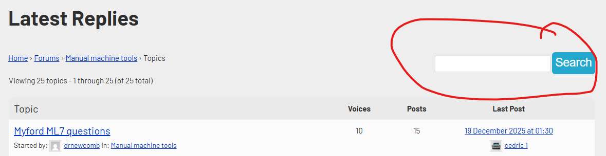

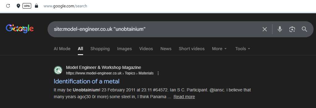

                                    The search on this site isn’t the best really.
                                    For many purposes it’s best to use an external search engine such as Google, and specify the site within that.
                                    Shown here as a screenshot to save the site resolving the URL and confusing things
                                    image_2025-12-19_013149723
                                    There is a site search built in, available in a couple of different places;
                                    image_2025-12-19_013409539
                                    Or you can click on a member’s name and have a look at their profile; you may recognise this one.
                                    image_2025-12-19_013700783
                                    Bill
