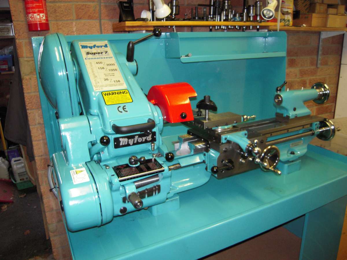

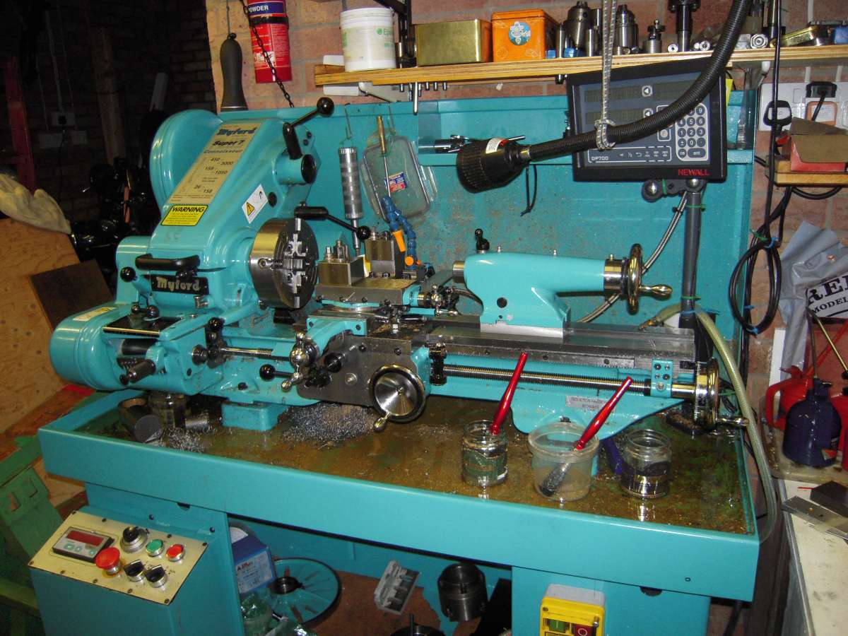

                              Myford went into voluntry liquidation when its founder, Cecil Moore, died. I remember him as a very old man, during Myford open days watching everything. These were great events where you had the run of the works and ask advise from the staff.
                              I bought one of the last Connoisseurs made at Beeston. It was delivered by the managing director, Cecil’s son, at the end of a snow storm just before Christmas 2010. Its serial number is SK171708. I was persuaded to sit it on ISO-blocks which was easy and not a problem. Other than leveling the bed it needed no adjustment. It worked straight out of the box (what box?).
                              Jason, I hope your lathe serves you as well mine has to me.

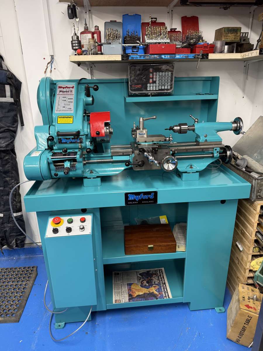

                                jason fletcher
                                  @jasonfletcher75993
                                  Thanks for all the information. You have all been really helpful in assuring me I’ve made right decision. Anyway, the machine is now in my workshop. I’ve got to level it up and secure the wires and fit a socket on the wall and it’s ready to go. Definitely a joy of ownership thing. IMG_2234
                                  #840019
                                  cedric 1
                                    @cedric
                                    Here’s a tip. When setting it “level”, set it so one corner of the drip tray is slightly low, so that any oil and cutting fluid gravitates to that corner, making clean up easier.
