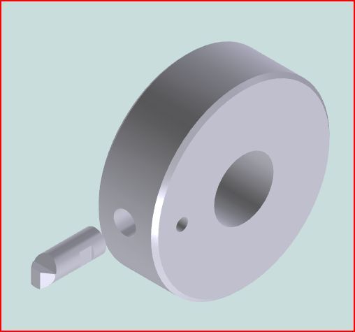

                Can't you just make your MT arbour longer in the first place rather than extend it?
                Or if you have a horizontal spindle for your mill make a ring say 1" ID, 3" OD, 1" wide. this can be drilled to take your ground single point cutter and cross drilled for a grub screw to retain it against a flat. This will be more sold as it can be supported by the overarm.
                Edited By JasonB on 05/07/2016 10:47:23

                        #245507
                          I would have thought that if made with the cutter set at a smaller radius to what it will be finallu used at then you will get clearance. Or just pop the ring onto a stub of 1" bar and hold at whatever position you want in the 4-jaw.
                            Yes, that sounds like a good solution. Thanks

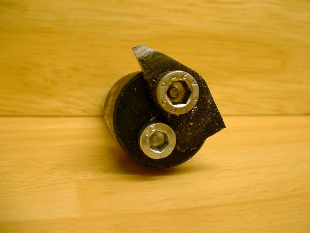

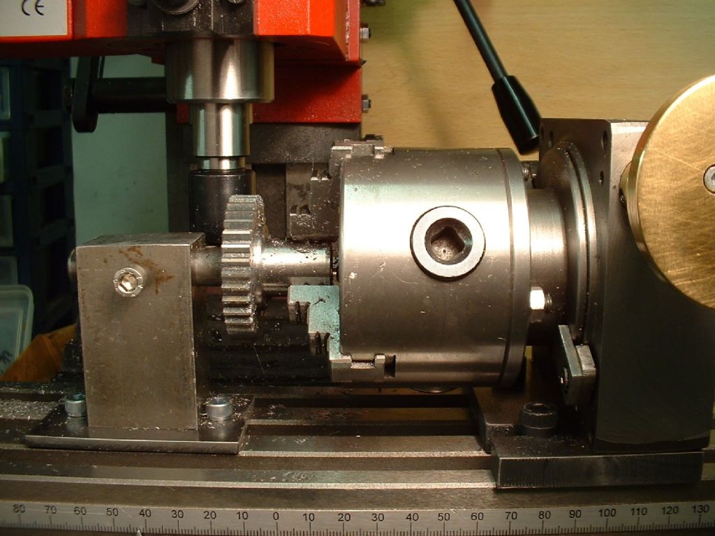

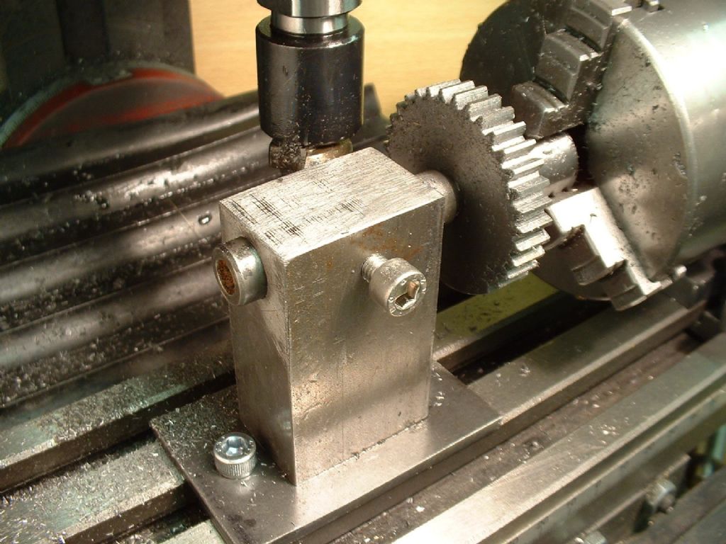

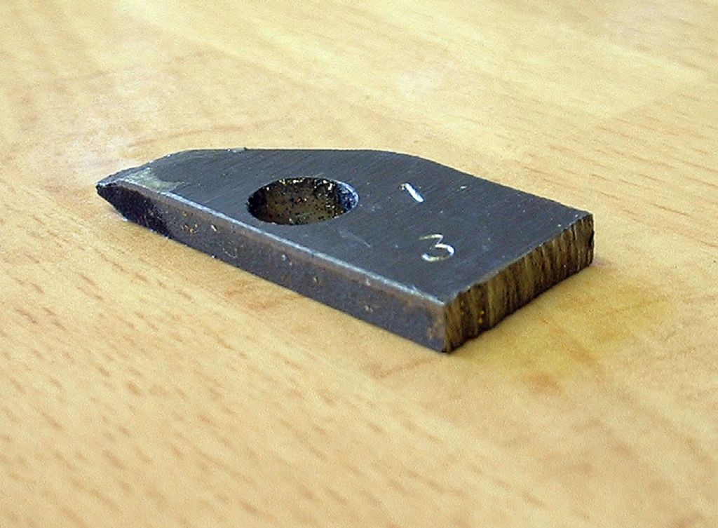

                              #245530
                                These pictures may help? Using a single point cutter in my mill.

                                  Thanks for all the replies. I'm going to go with Jason's suggestion of the ring to fit on my horizontal arbor and the flycutter insert.
                                  Hywel
