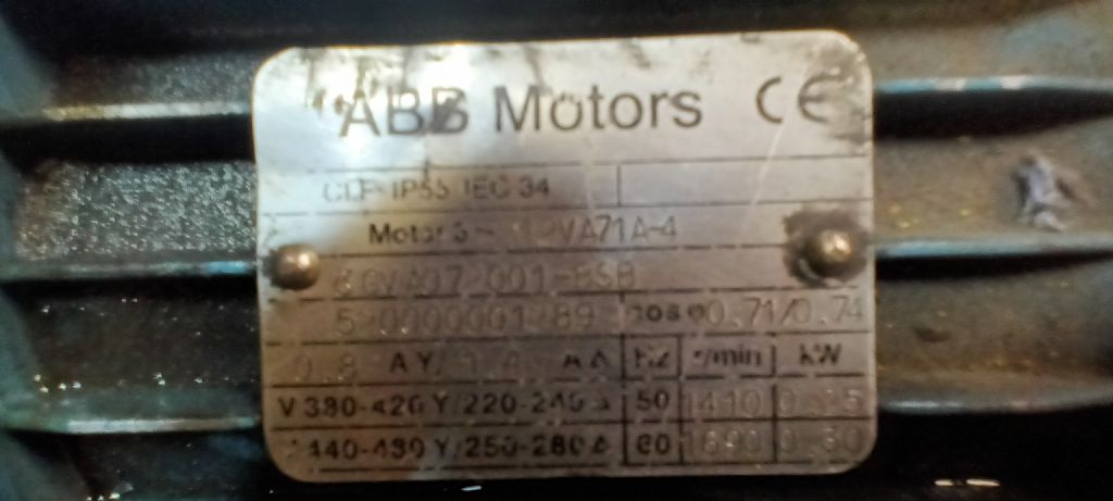

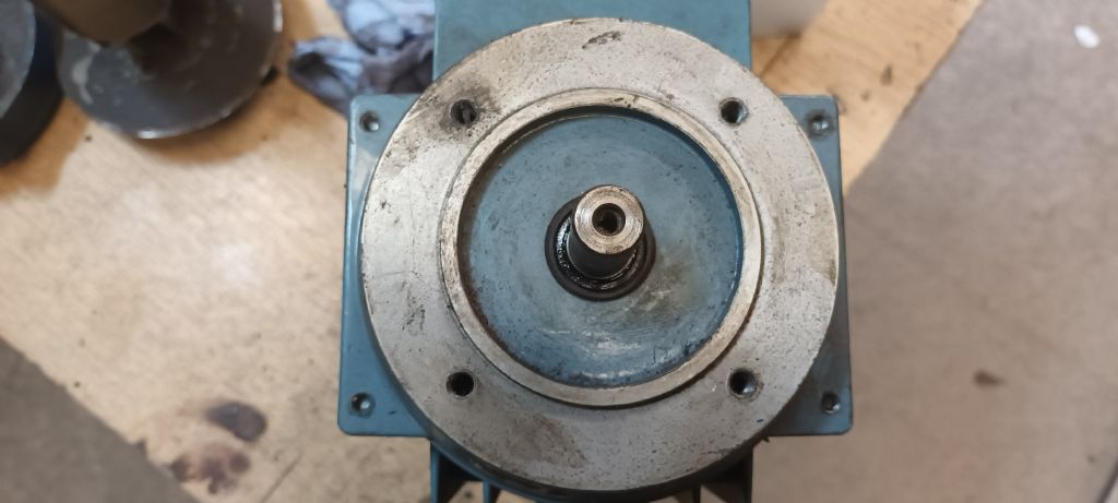

        20220328_172938.jpgSo the motor on my milling machine table feed is dead. I've got another motor but the fittings are different. I intend to make a plate which will interface between the mill and the motor. I presume the motor mount will be to a standard which I can reference to get the dimensions? Can anyone help point me in the right direction? Cheers 20220328_172739.jpg

          Colin, Look for Brook Crompton Motors and have a look at their catalogue, which lists all current specs, or ABB will probably show the dims in their catalogue, you motor plate should show the frame size you have, I cannot make it out from the picture.

              The motor plate shows Y and Δ voltages so there will be no capacitor.

                Photo is not clear but I think it may state IEC71 frame size. Google the full code and you'll find tables showing the standard dimensions.

                  Metric motor flange dimensions
                  Above link gives dimesnisons of standard metric motor mounting flanges.

                        For an interface plate, it is not the bolt holes that are particularly important – it is the spigots that actually centre the motor/plate to the machine.

                            Sod's Law says that the replacement motor bolt holes will partially coincide with the existing tappings!
                            This will necessitate re orienting the new motor, if possible, to separate the motor fixing holes in the adaptor plate, from the csk holes fixing it to the machine.
