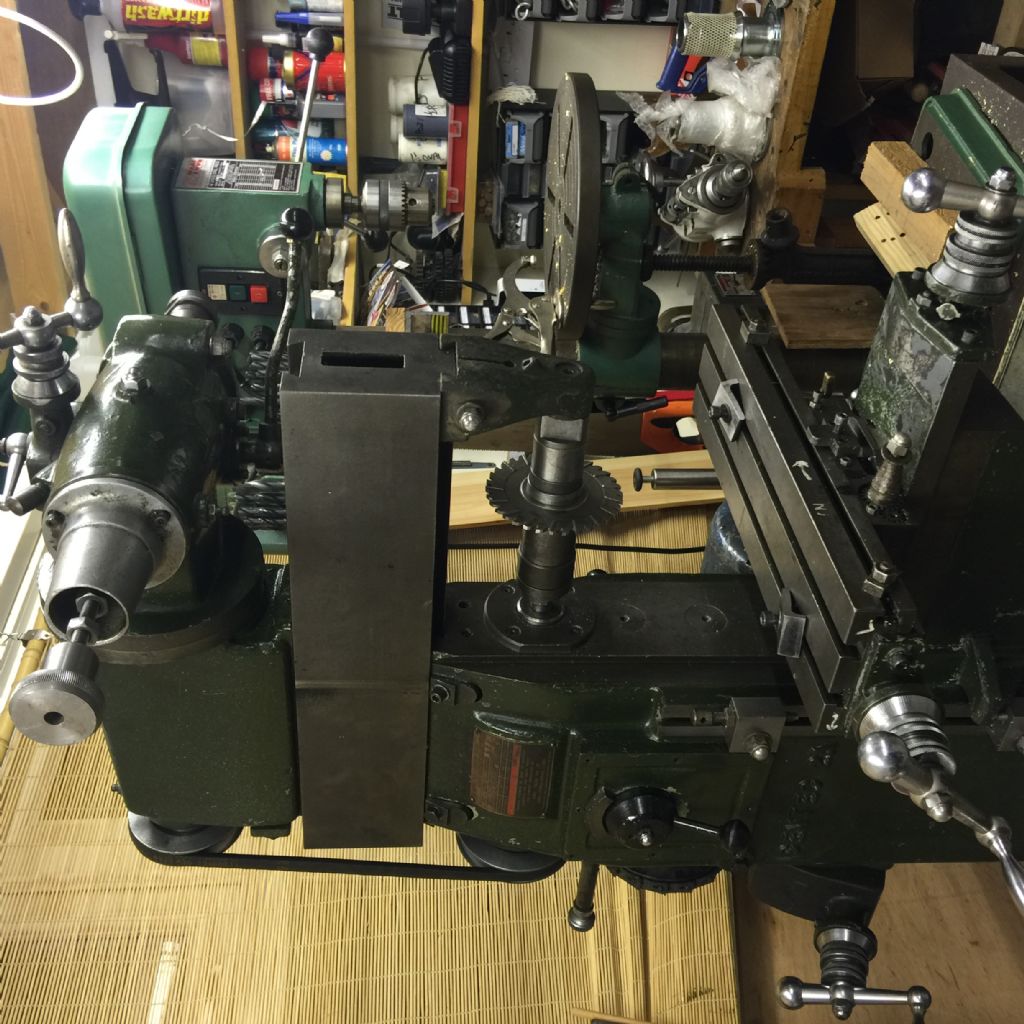

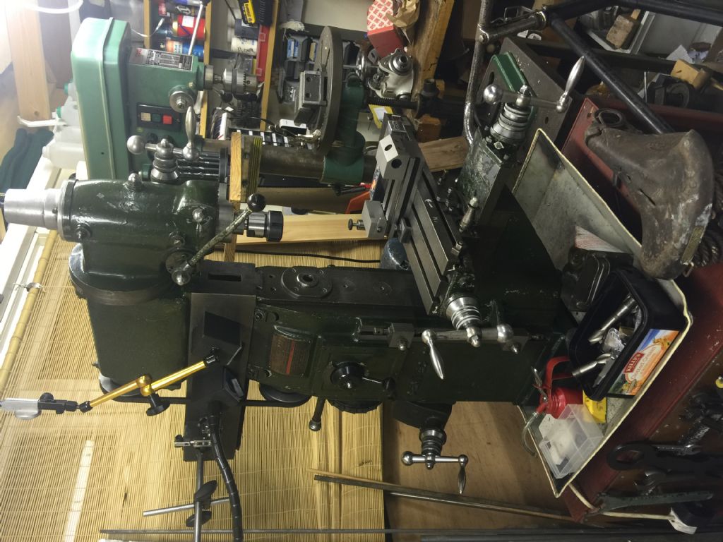

                                            ANDY CAWLEY
                                              @andycawley24921
                                              A Centec could fill your bill. Sorry the photo is sideways, it seems to have gon this way on up loading!Centec2.jpeg
                                              This is my machine showing it with the additional riser block which not only increases the head clearance but permits the use of the horizontal spindle without having to remove the vertical head.
                                              Edited By ANDY CAWLEY on 25/03/2016 07:22:42
                                              Sorry this photo is on its side too. It could be an iPad problem.
                                              Nick, this machine could be for sale, if you are interested please pm me.
                                              Edited By ANDY CAWLEY on 25/03/2016 07:26:12
                                              Edited By ANDY CAWLEY on 25/03/2016 07:27:35

                                                Graeme. A crackingly well designed, versatile and well made machine for a small workshop if it's a good one.
