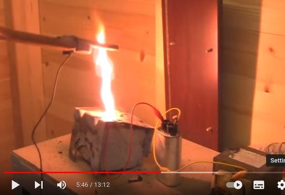

                            But beware! A Microwave Oven Transformer is the most dangerous electrical item in the home. Bad enough they step-up mains voltage to a couple of kilovolts, but the design of the core means there's virtually no limit to the amount of current they can deliver. They cause severe shock and horrible burns. Old Sparky stuff – victims have been known to catch fire…
                            This image is from a YouTube Video intended to highlight the risks. About 5:30 minutes in:
                            Despite approaching these beasts with extreme caution there have been a number of nasty accidents in the Tesla Coil community.
                            The answer is simple: don't plug it in until the High Tension winding has been removed!!!
